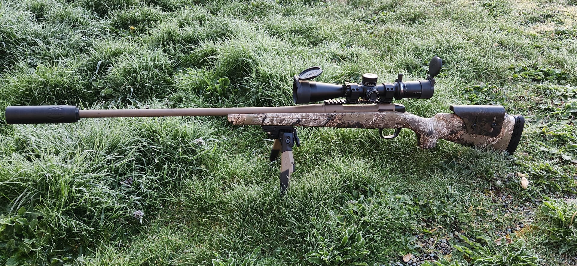

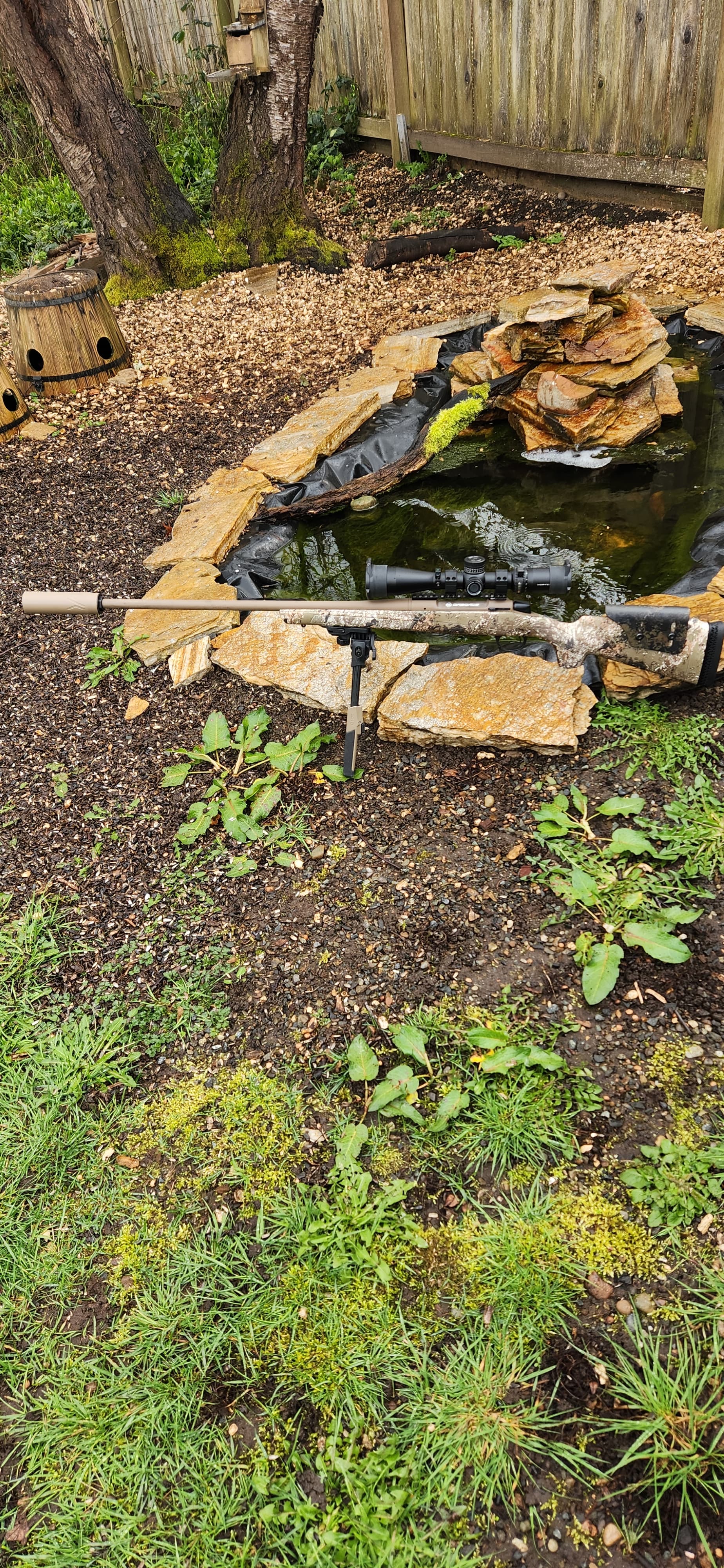

I have a cascade in 300 win mag, I glass bedded the action added epoxy to the fore end , added a hatch 3" pic rail and a backfire buttpad. I topped the rifle with an outerimpact rail Seekins precision matched rings and a Vortex ViperHD 3-15x44. Im getting .405 groups with Federal Trophy copper 180g, and .506 with Sig Sauer 180g accubond.
I just received my Cascade XT in 6.5prc and adding the same upgrades.

Thanks. I forgot to mention i have a Banish Backcountry suppressor on my rifle.
I have a Cascade 300WM I glass bedded the action, epoxied the forend, Mathews Fabrication cheek riser and Backfire buttpad. Im very happy with the rifle. Shooting goo
