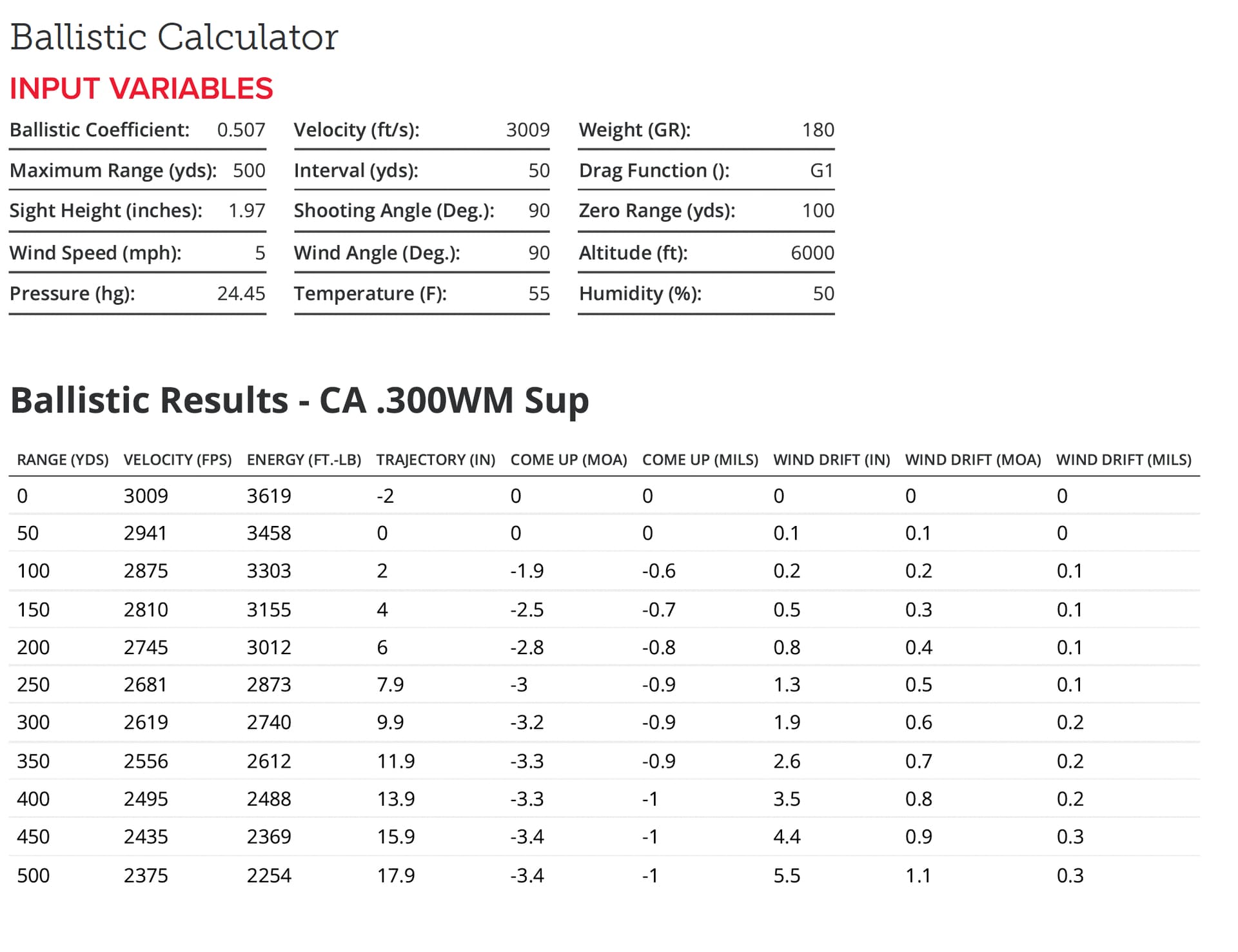

I’m making my dope chart and struggling with some things. When I use the Hornady BC tool, I get this output.
The two columns I’m working with is the Trajectory (IN) and Come Up (MOA). What I’m struggling with is the negative number in the Come Up column, to me that seems it wants me to dial down, that does not seem right to me, so I checked with my Applied Ballistics app and inputted the same data and took 300yards as a sample and sure enough it says at 300yd, to dial down 3.6moa which is down 13 clicks.
I sure would like to wrap my head around all this. One main thing I guess I’m struggling with is the turret on my scope, which to go UP it is counterclockwise, so if I do have to indeed go down 13 clicks at 300 yards then I would turn it clockwise, correct?
