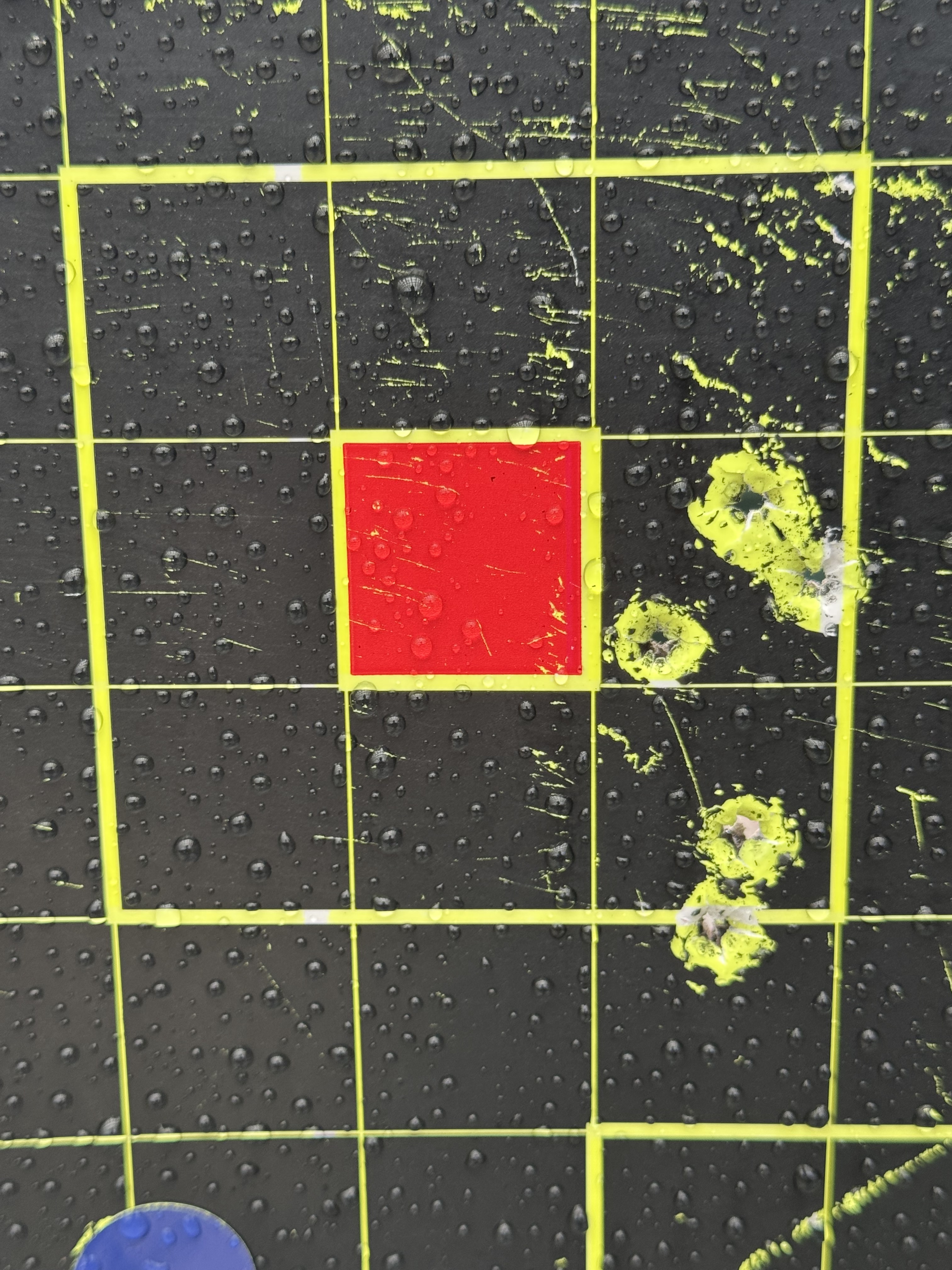

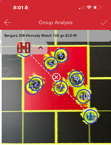

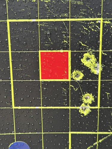

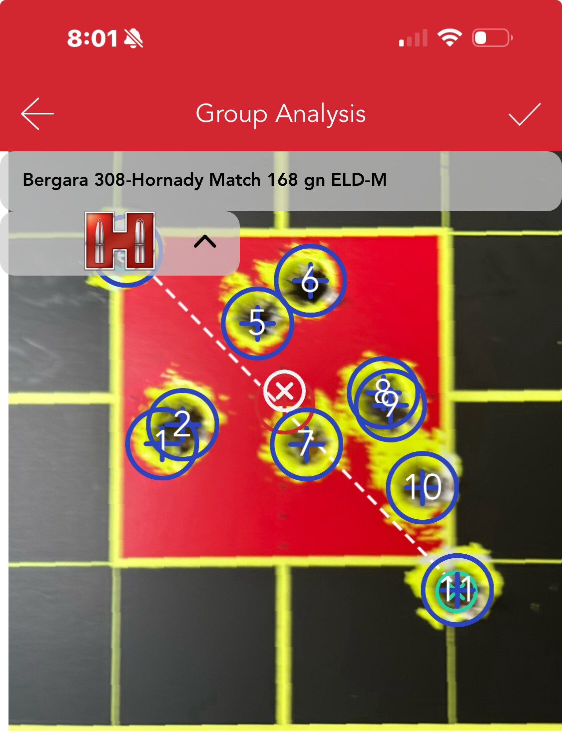

I have a Bergara HMR in 308. I have included pictures that show what is happening.
This is from last year with a GSL Multi-Cal suppressor.

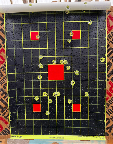

This was Saturday shooting the same ammo (same lot of factory ammo 168 gn ELD-M) with just a muzzle break.

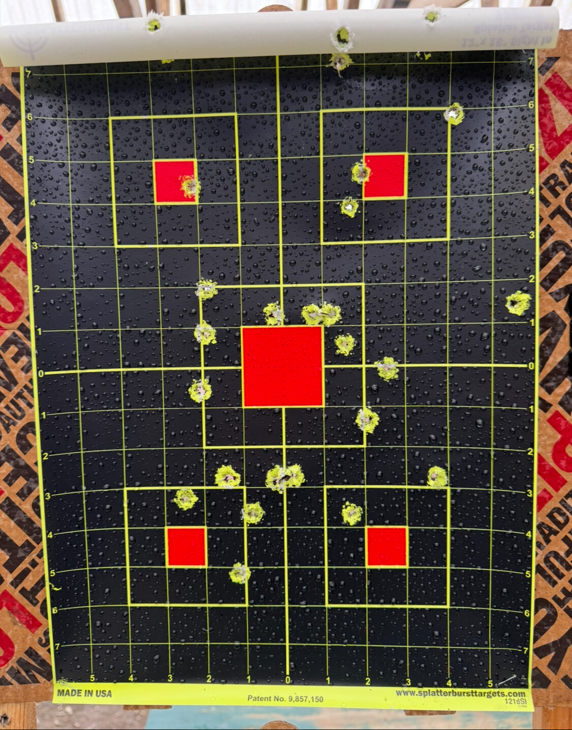

This was Saturday shooting the same ammo (same lot of factory ammo) with the same GSL Multi-Cal suppressor attached.
I did make sure that both the brake and the suppressor were tightened down correctly. I’m debating either to try 150 grain or 175 grain projectiles, but I don’t quite understand what is going on.

Very odd. I know you said everything was tightened down but seriously that’s the only thing I can think of that would make that big of a difference. Pie plate accuracy just won’t change by altering the bullet weight. Something else is happening.
