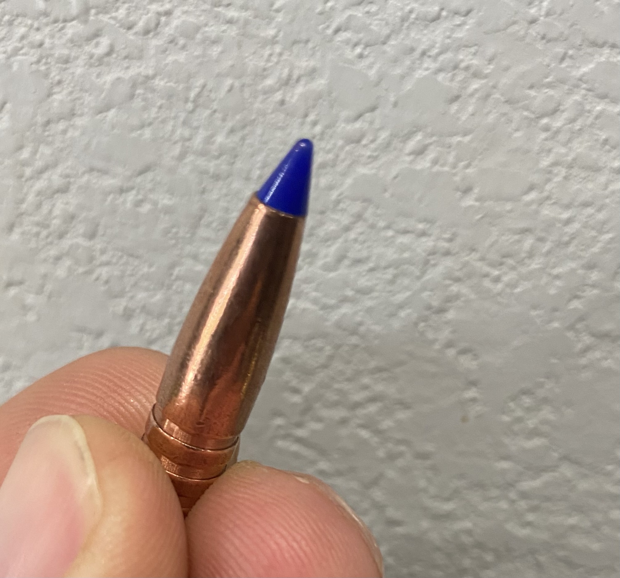

The one thing I have noticed with the Barnes LRX is that all the tips are off center and after doing a google search there are a lot of story’s about it and the tips just falling off. I think they have quality control issues.
I’ve noticed the off-center tips as well.
That with Factory loaded ammo, component bullets, or both?
I can only speak of the component bullets. Some are better than the picture and some are worse

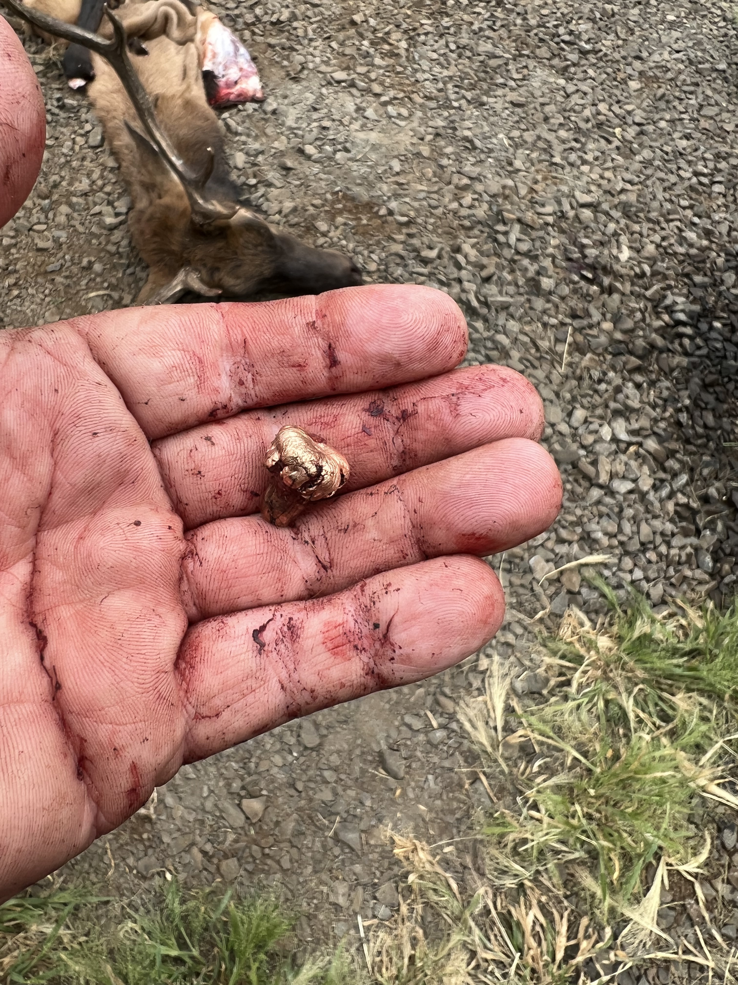

I am a big fan of barnes copper ttsx factory load. this is from a 4x4 bull at 300 yds pulled from hide on exit side from a 300 WM.
I dare call it perfect. 165gr cranking along at 3120 fps at muzzle - (barnes data not chrono). I guess I could have washed my hands😀
