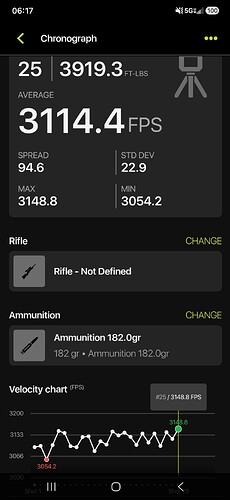

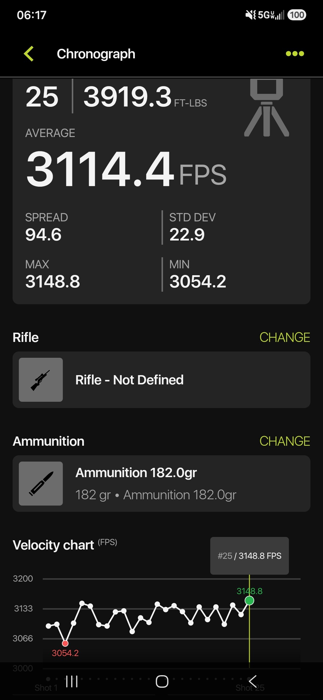

For the really serious reloaders out there, how much weight do you give ES and SD when developing load data? I’m working on my .300WM right now and the load I’ve worked up shoots fantastic at around .5-.7 inches. The only issue is my SD is up to 22.9 and my ES is pushing low 90s. I had another load with an SD of 7.6 and ES of 21.3 but the velocity was over 100fps slower and I never shot it on paper. I’m going to Idaho in October and was told to expect potential shots of 700-1000 which is farther than I’d normally prefer to shoot but still doable. If I’m getting good accuracy out of a load with higher numbers should I stick with it or keep playing around for lower numbers and hope the new loads group well? To add some context the load with better numbers was at factory recommended overall length and the group I put on paper is measured off the lands and seated a little further out.

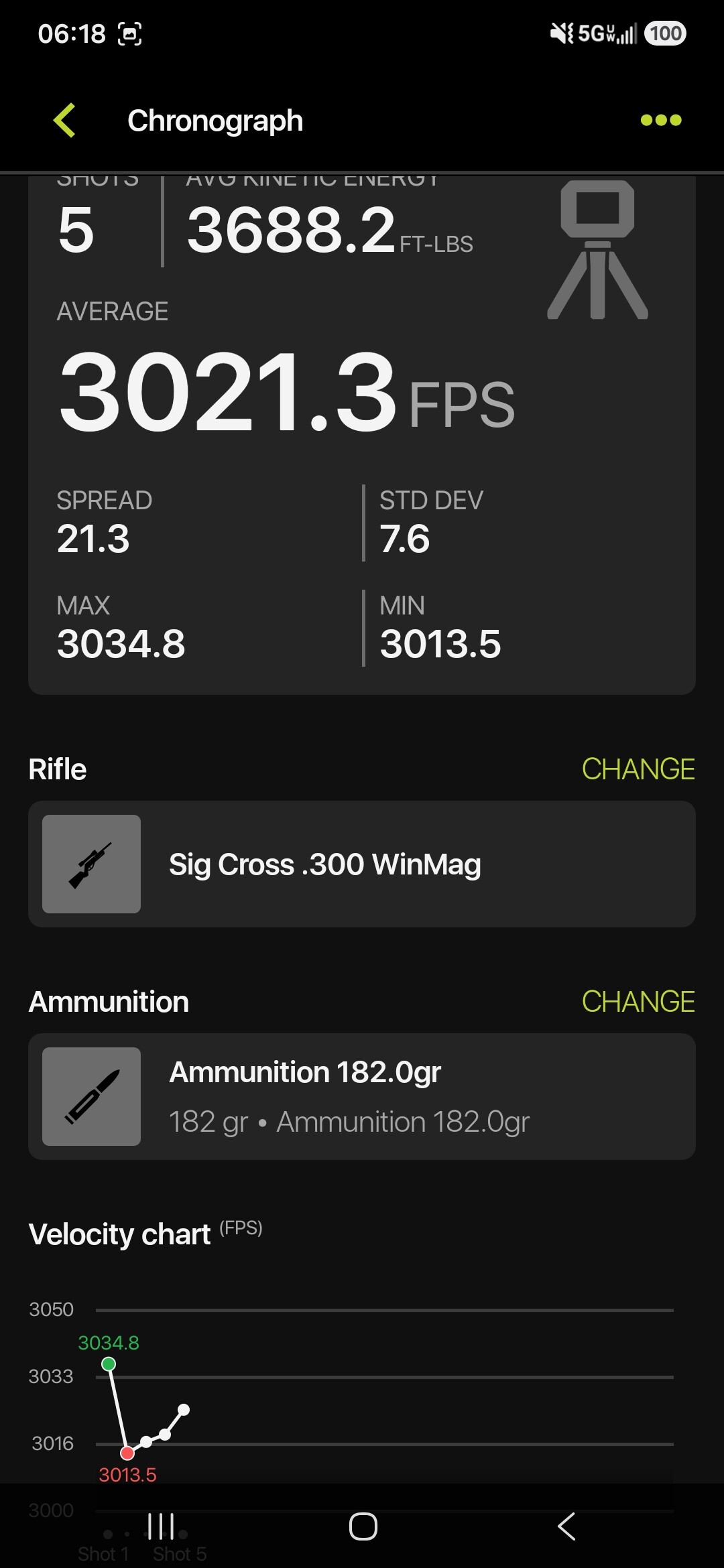

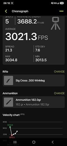

Im using the FA digital scale and measuring each round by hand for powder and length so the consistency is there. Could have just been a bad day but it was a group of 25 so I guess its also possible I didn’t let it cool down enough in between shots. The shot data looks pretty consistent with maybe a few bad rounds but its still higher than I’d like. I have another 40 loaded I wanted to shoot over distance. I’ll post the data from my Garmin for each load for you to take a look at and maybe you’ll see something I didn’t.

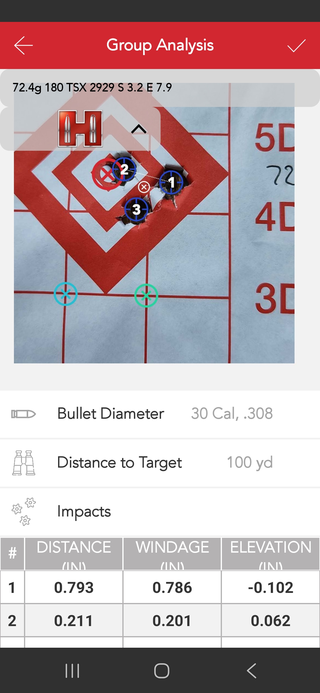

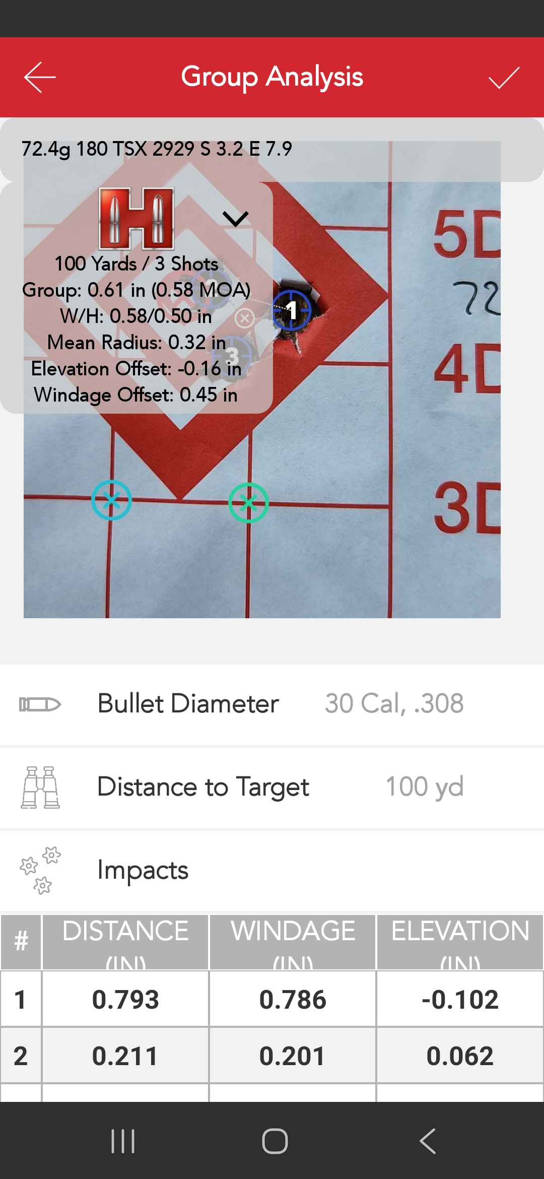

Im loading 180g tsx and getting single digits 2930 fps. Sd 3.2 Es 7.9 H4831sc powder
I’m using the RCBS Matchmaster dies. I running the Hammer 182 HHTs using Ramshot Grand and Peterson brass.
I hand measure all my rounds off the ogive so I know the ammo consistency isn’t the issue. At this point I’m thinking its the seating depth. After playing around with the bullets I noticed if they’re seated out too far there’s not enough tension to hold them in place and I can actually spin them by hand. I had to seat a little deeper until I couldn’t spin them anymore so I’m assuming that’s whats caused the huge spread when I went out to the range.
