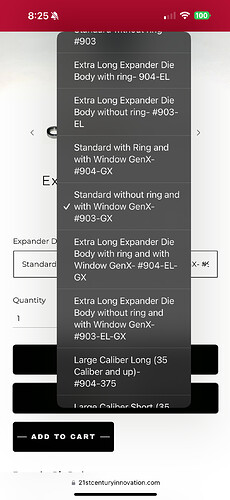

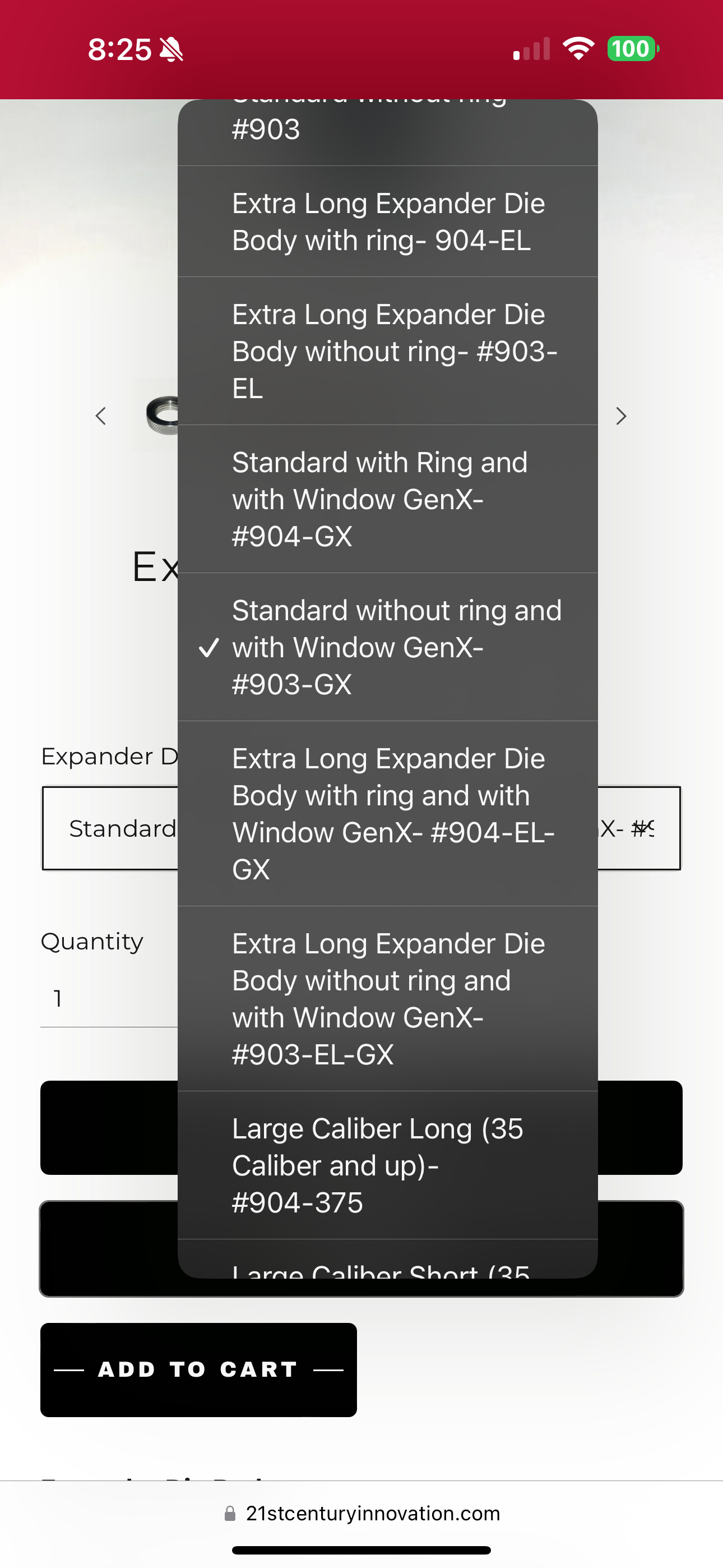

Finally, if I’m reloading for my 7MM PRC, which die would you purchase? See my screenshot below.

I just bought standard black nitride. One for each major caliber of bullet. Neck tension is not one of the variables that I customize on my ammo. I really just want it to be the same every time, so I use the expander mandrel.
Setting up the die is super easy. You just chuck the mandrel in and screw the top closed. Then start hammering brass. You don’t even have to get it to a specific setting at all. You can just feel when the mandrel slips over the mandrel and you stop pressing there.
Once you get it and use it once, you’ll see it’s really simple.
