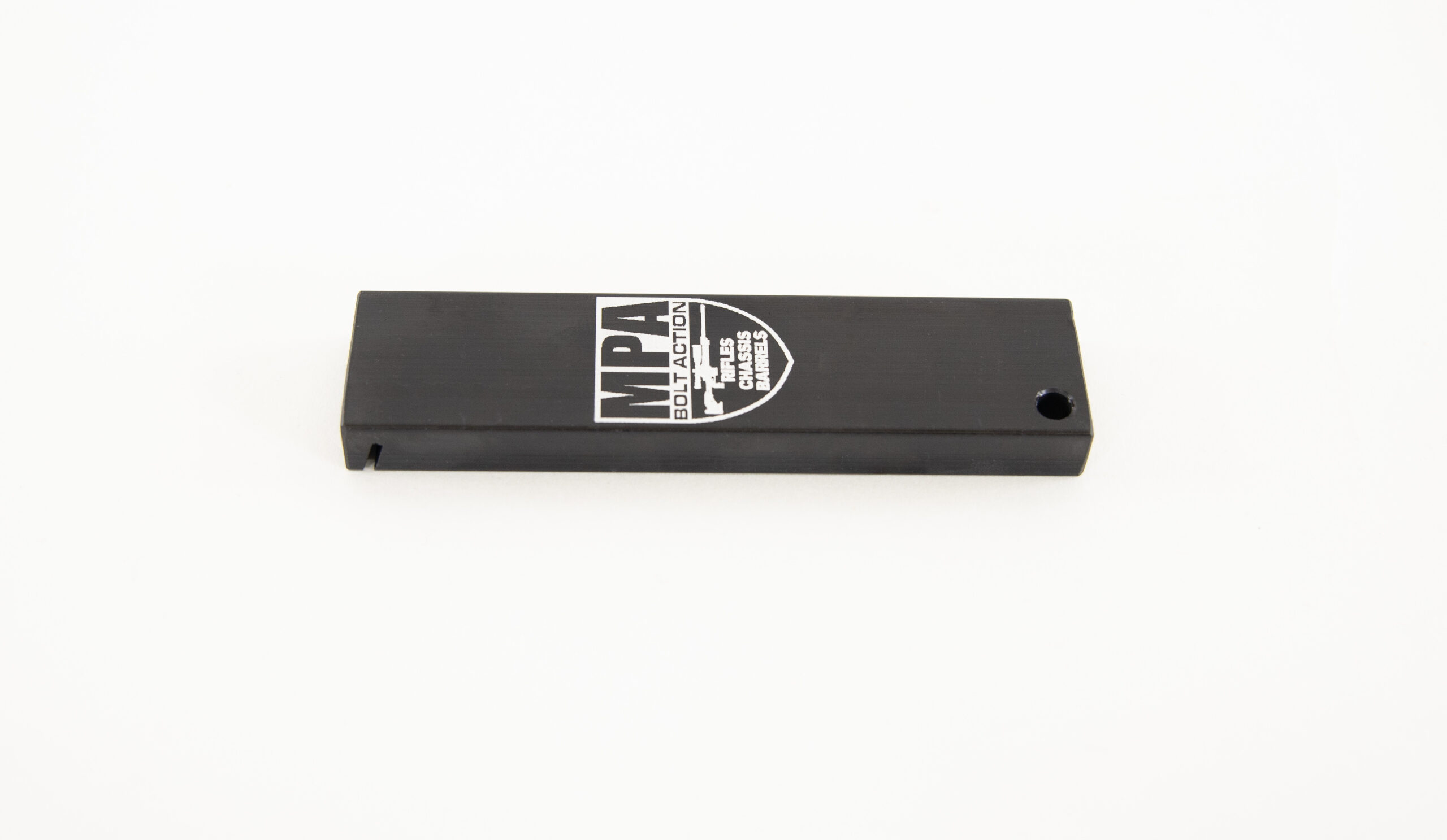

Here’s an example of the tool:

Funny they make tool for this one would think a flat piece of bar stock would do It will look at how they use the tool

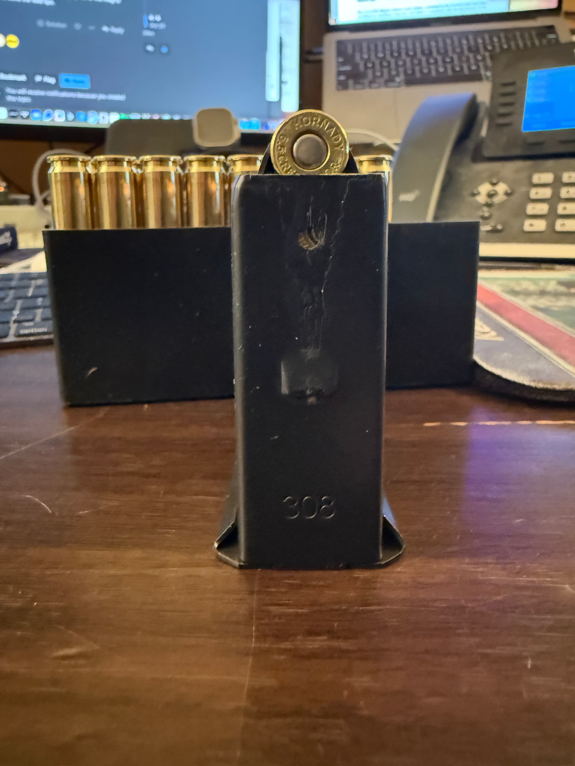

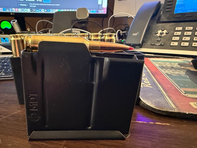

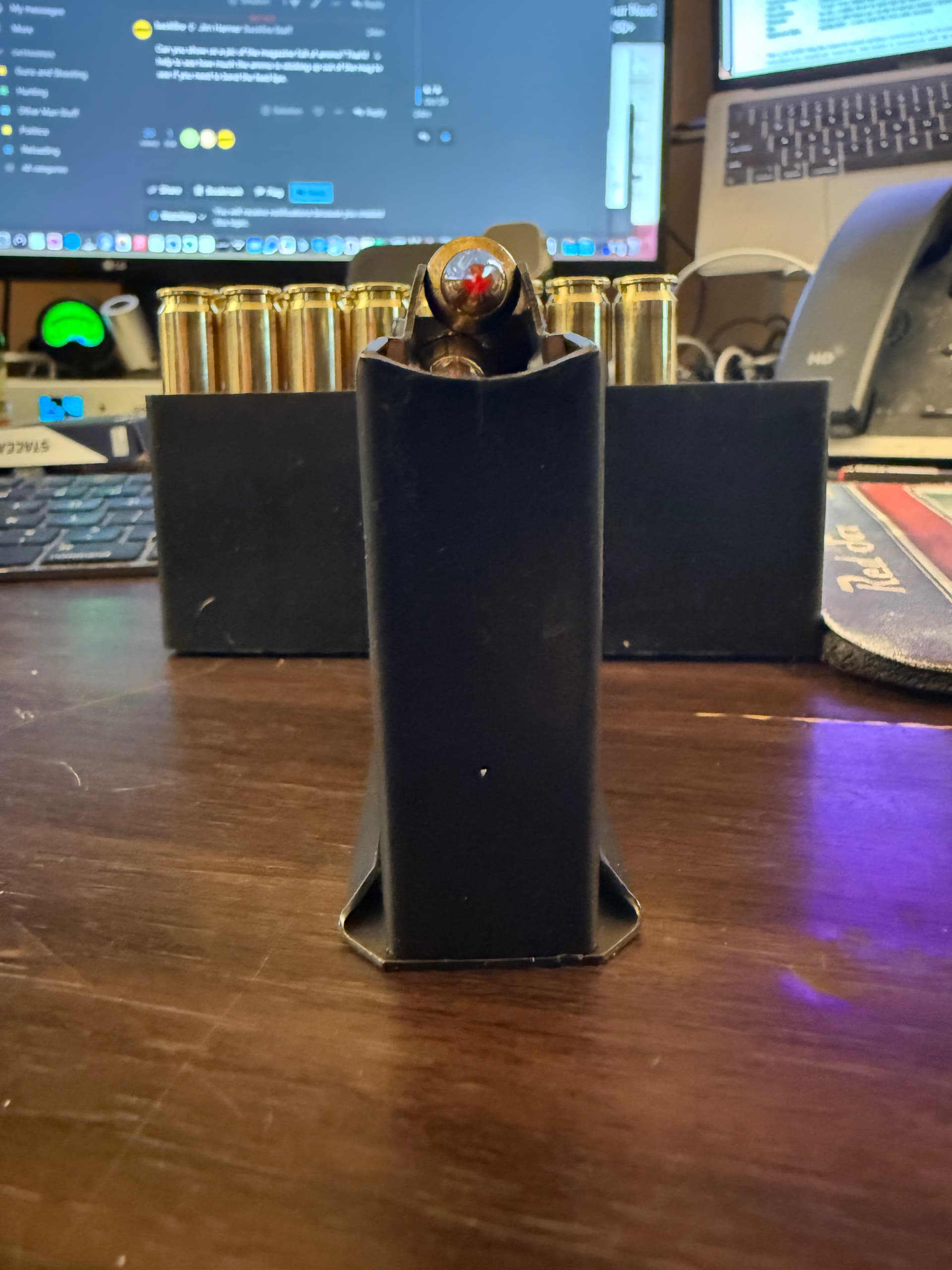

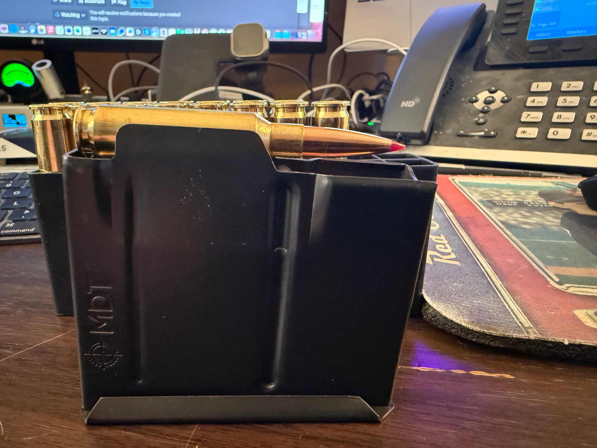

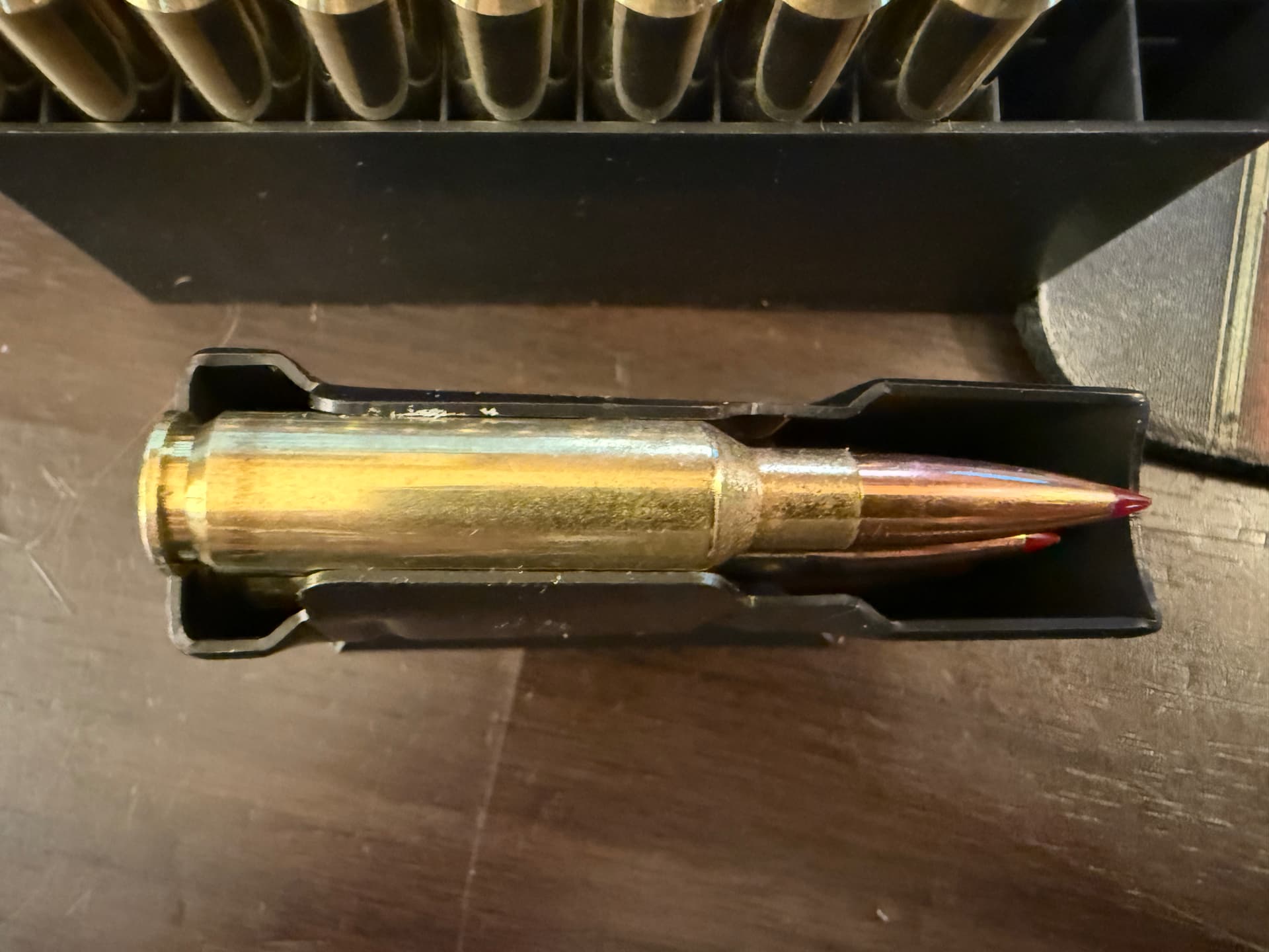

Can you show us a pic of the magazine full of ammo? That’d help to see how much the ammo is sticking up out of the mag to see if you need to bend the feed lips.
@backfire thanks if you see anything or have advice on how to look at these and tell let me know would be nice to have that intelligence moving forward!
