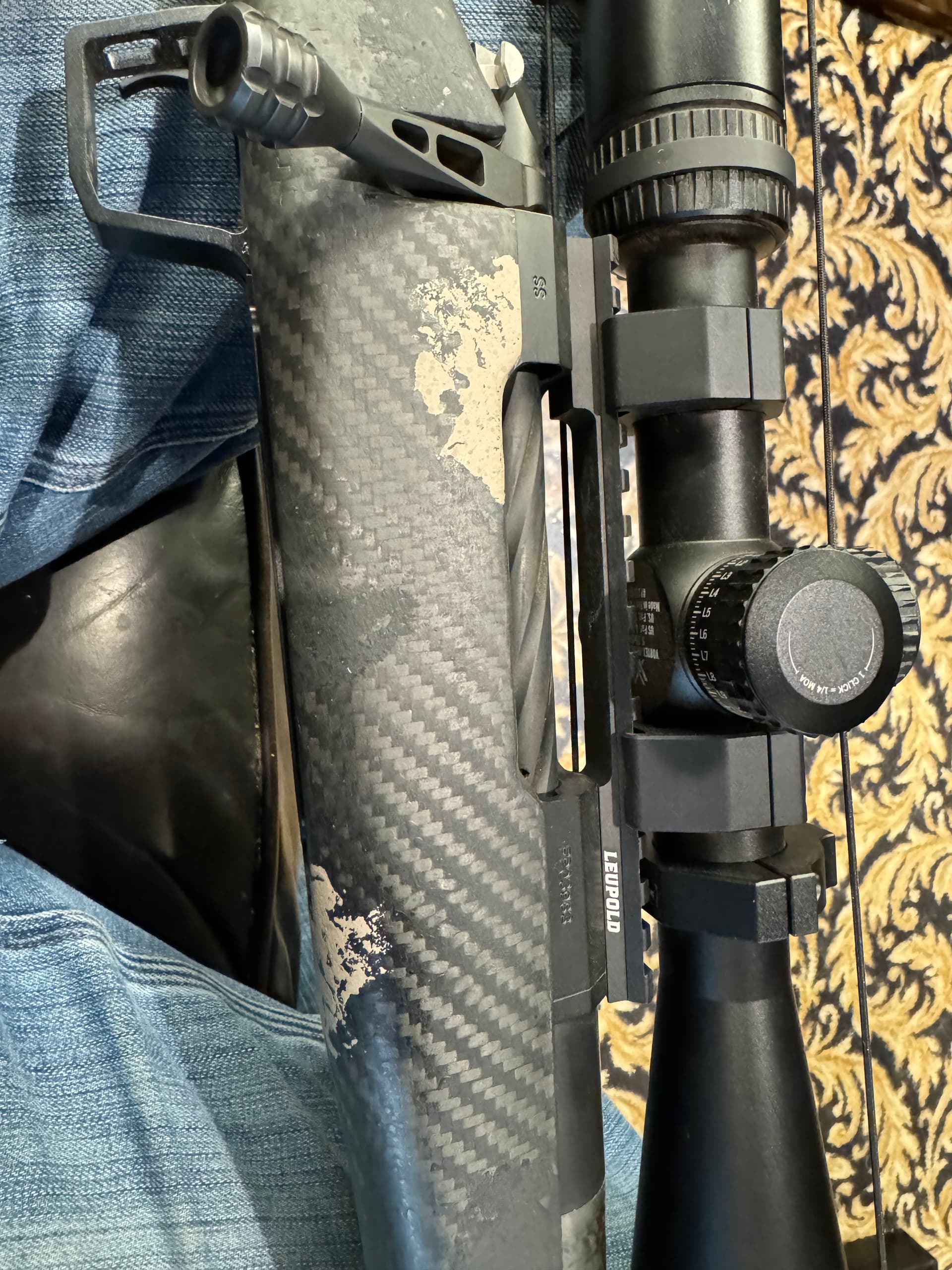

I hate when a manufacturer’s customer service doesn’t know what they are talking about. I have a Carbon Rogue in 7PRC. Looks to me like that picatinny rail is emblazoned with Leupold.
I found out this worked from one of the Fierce groups on Facebook. It was a perfect fit.
Looks pretty solid to me. Thanks guys. I contacted Fierce Firearms yesterday and ordered their rail and ring combo set. Looks like I’ll be having some options. I appreciate the time for you to reply.
This was a 4 shot zero. Upper right was bore site. Adjusted to 3 shot. The Leupold picatinny is solid for sure.
Do you recall which Leopold rail you purchased? Scope? And rings?
It is a Remington 700 base. Remington uses 6-24 screws, while Fierce uses 8-40 screws that came with the base…
Rings are Vortex 30mm Precision Matched Rings.
Scope is a Vortex Viper PST Gen2 5-25x50
