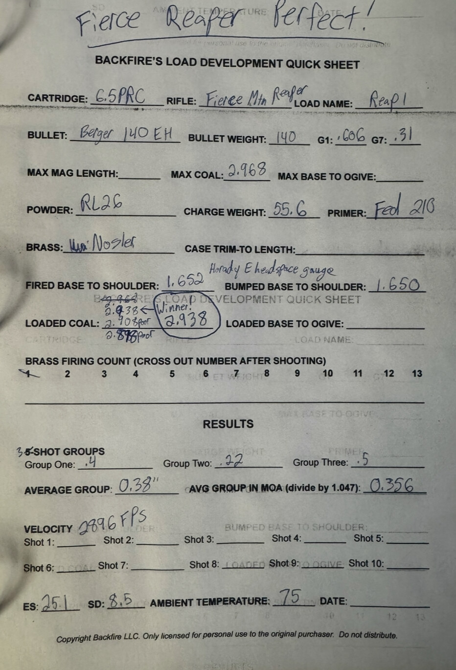

Jim, I am a new member of the Backfire family. I’m excited to be here.
I just purchased a Fierce MTN Reaper in 6.5 PRC. I am a hand loader and have just started my load development. Here is what I am starting with: Hornady Brass, 150Gr Nosler AccuBond LR, 55 Gr. H1000, WLR Primer, Bullet seated .055 off the lands. (From the Nosler load data)
I know you have this same rifle. I am wondering if you had any suggestions and would you be willing to share your best load data.
Thank you for any suggestions you might have.
Keep up the good work.
Best regards,
Chris
Here’s my load! You’ll love this gun.
Only trouble is I use Reloder 26 powder in this load. I only have a little left so I’ll probably have to switch powders since that powder is unobtainium right now.
Jim,
Thank you for your response. I am going try that load Berger as well. I think I may have 1 pound or Reloader 26 I may try it as well.
I am using the Redding Premium Series Deluxe 6.5 PRC die set with the micrometer seating die.
I will add my results to this post. Is it ok to share my load work up on here?
