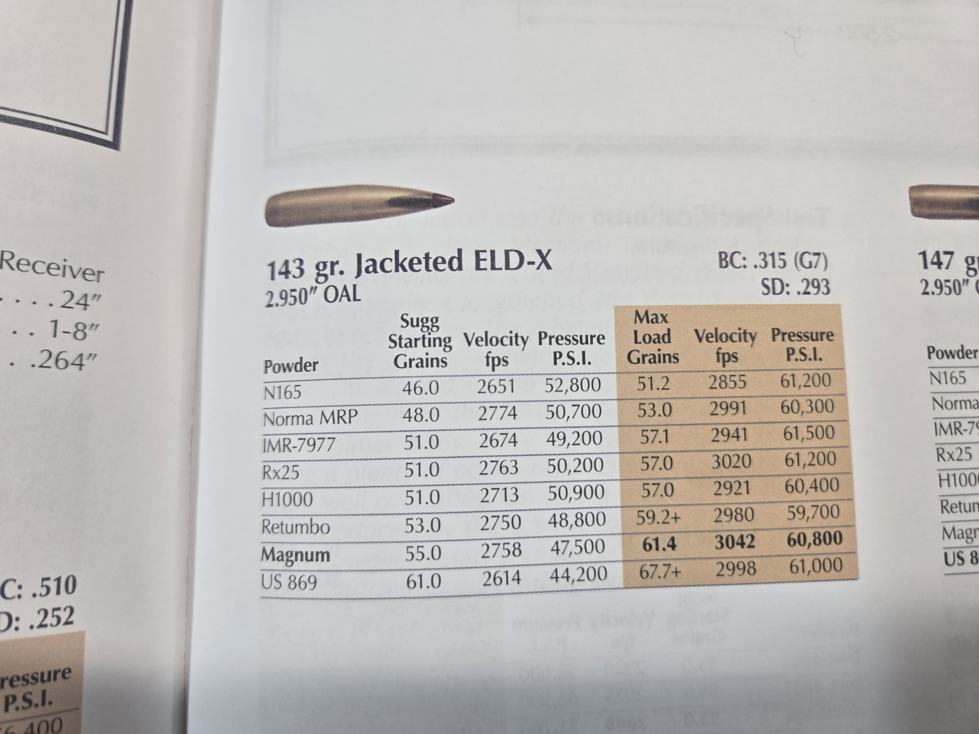

Hornady list 59 grains as the max so pushing up a little more probably wouldn’t hurt.

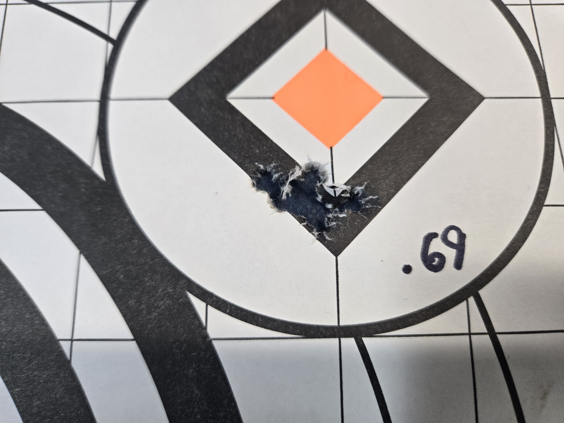

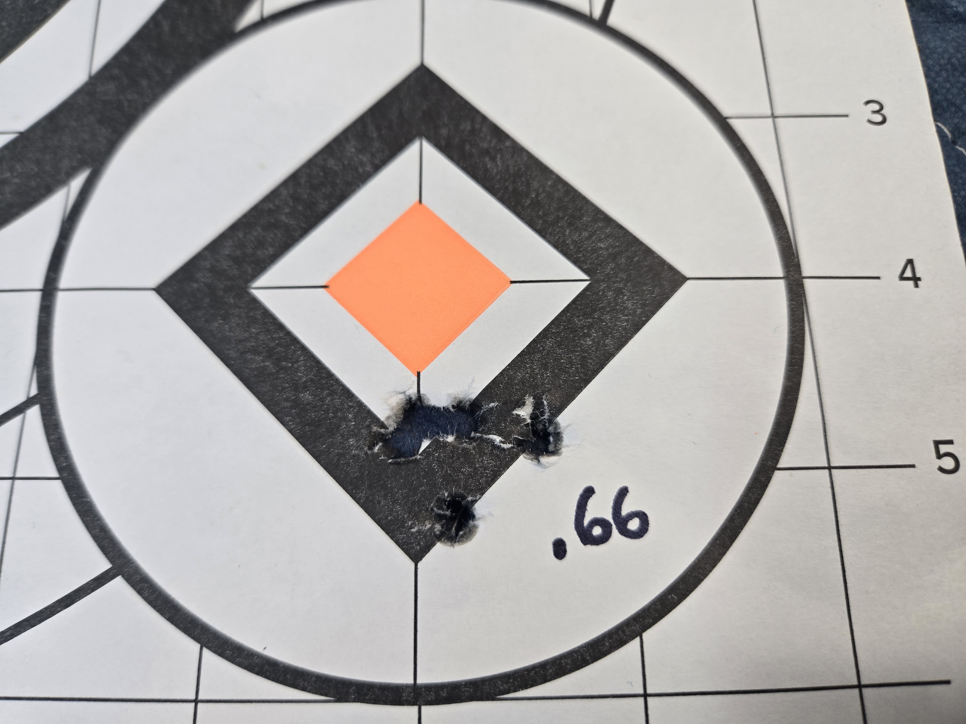

Im using a Sako S20 with a 24" barrel and a scythe TI. All testing was done with a bipod and rear bag at 100yrds using a Athlon Rangecraft for the data. I wasn’t really going for accuracy but I was practicing normal technique. I did four 5-shot groups.
Group 1 - 1.06"
Group 2 - .99"
Group 3 - .69"
Group 4 - .66"

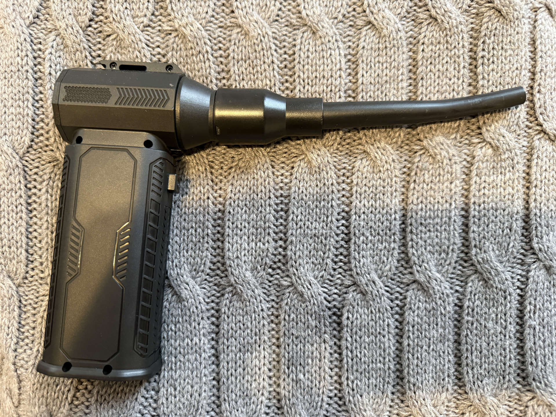

Continuing that i’d load up 10-20 of group 3 and 4 and test. Shoot 4 at a time monitor barrel temp and use a barrel cooler this will get you a bunch more data than 5 can. THis was the best irange investment ive mae to date. 2 guys next to me were using It. Its a power house cools barrels in minutes. Just need to heat form the long tip that comes with It very light heat gun and bend you cant imagine how It helps in load dev testing. the curve turned up to show what I did but It is turned to enable you to stick It into the chamber. will go deep and seal well. It has 3 speed settings setting 2 will blow your face off. Its a high powered keyboard and computer air cleaner re-purposed
https://www.amazon.com/dp/B0F5HNWHTX?ref=ppx_yo2ov_dt_b_fed_asin_title&th=1
curve

I think i found one of my problems. The Lyman Reloading manual appears to be incorrect and way off from other sources. They printed the max load for H1000 and the 143gr ELD-X as 57.0. When I checked other books and sources im seeing max loads between 59.3 and 60.0. I think Lyman is misprinted.
