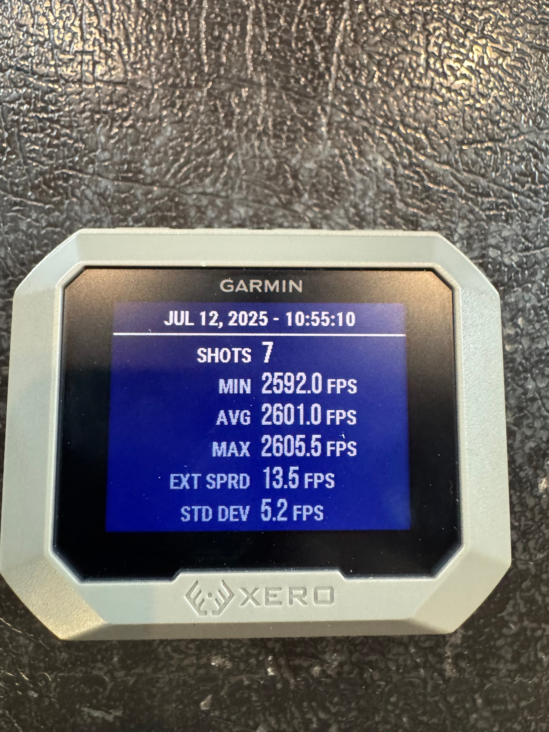

So I did a 20 shot test of:
H4350 @42gr
Sierra Game King 130gr
Federal Premium Gold Small primers
Once fired federal brass
20 shot results:
2871ft/sec
SD 7.3
ES 26.6
.56 group
Custom Aero Solus
Banish 30v1 with break
Ultradyne picatinny chassis
Arken EP5 7-35
Can’t find a good load for the 7 PRC yet, but this one make me feel pretty good
First 5 shots were .22". I was a little shook by that because I had been getting horrible result on my 7prc. I thought I was having an off day.

The 7PRC is proving to be far more challenging. I have already tried multiple loads. I know that my gun shoots .75-.8 groups with Factory Federal 175 Eldx and pushed 2950. I’m now getting anywhere from .8 to 2" groups (since moving to 20 shot tests).
I know the Eldx is not supposed to be jump sensitive and I have had zero trouble loading even with the over spec COAL. Should I try reducing the COAL and lowering the powder a grain? Any thoughts?
