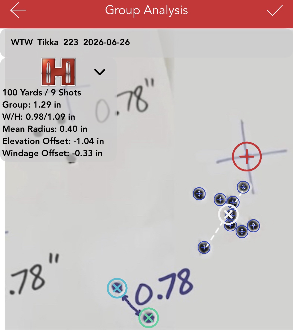

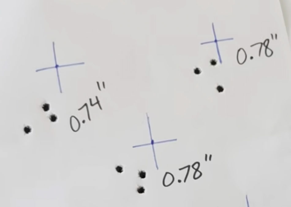

These shots are from a .223 Tikka at 100 yards, fired by a popular YouTube shooter/reviewer. A lot of folks see these three groups and say something like, “That’s a three-quarter-inch rifle!”
It’s not. The centers of the groups, relative to their respective points of aim, do not line up. These nine shots represent a 1.3” group.
Did they say what barrel it is? I believe the varmint is tikka’s heaviest profile barrel. I wouldn’t mind getting my hands on one of those.
it’s this one… “Everyone Told Me To Get This One…” Tikka T3x Ace Target
PS - Just be clear: I’m not knocking Adam from Who_Tee_Who. I only mention him because the question came up about the specific rifle.
Not a bad group for that ammo and whatever was going on with his trigger. Would run some better ammo and/or develop some hand loads. The tikka ace target uses their varmint profile barrel which is their thickest. Gotta love a thicc barrel.
I agree. From watching his videos, he seems to be a very good shot. I think his groups would have all been a little tighter and a little better re overall spread across groups if he hadn’t had that super-light, super-squishy trigger issue.
