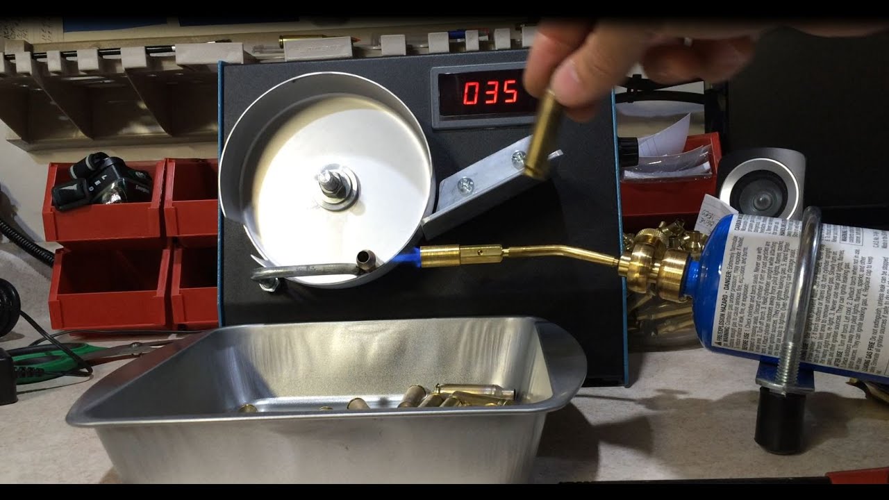

I have used starline for 6.5 creedmore. It works fine for hunting. If you anneal your Federal brass you can probably hang on to it for another 6 or more firings. I anneal after every case fire and have some 300WSM on 12, its usually the primer pocket that gives out. Another consideration is you will need to work up your load again if you switch brass as dimensions will change from your current powder and case capacity. Good luck!
Id anneal it youd get at least another 4 times using it. Little crow gunworks makes a shell holder you can attach to a drill that and a propane torch and your money. I built my own annealer for 150 bucks so if your handy you could do that.

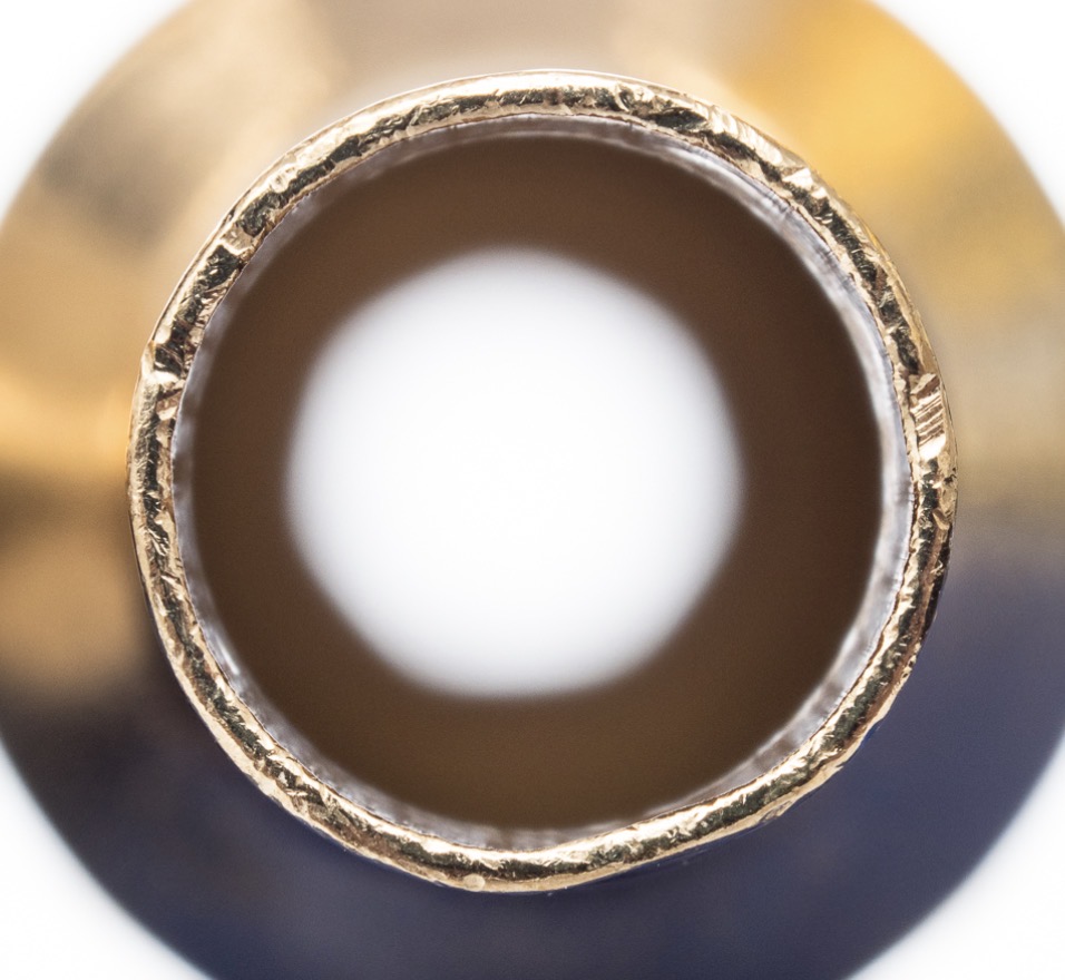

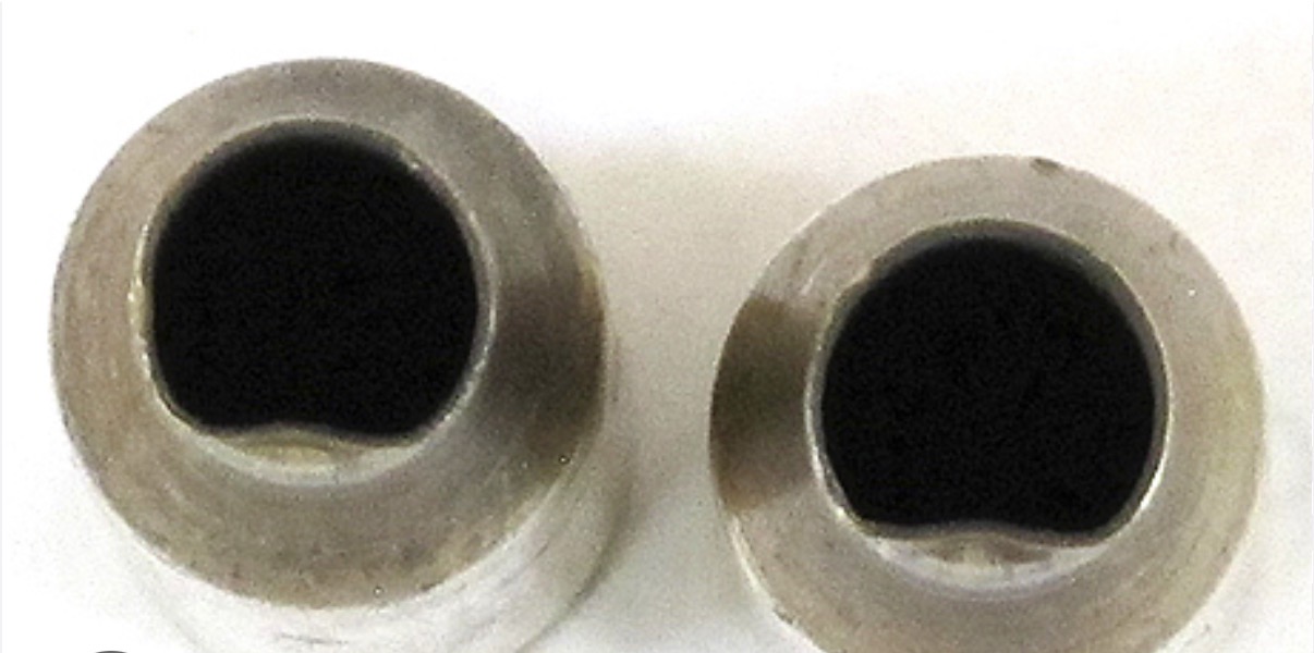

My Starline brass was new. I don’t have any empty brass to grab the pics myself, but found these pictures online which are similar to what I experienced. A lot of dented case mouths, very unfinished/ uneven rims. It was all fixable, but I was just annoyed by it. It did shoot fine once loaded. I’m still new enough to reloading that people shouldn’t take any reloading advice from me, but I just don’t want to deal with it, probably still a great value for somebody ok with the extra time sink to prep the brass. #First world problems
