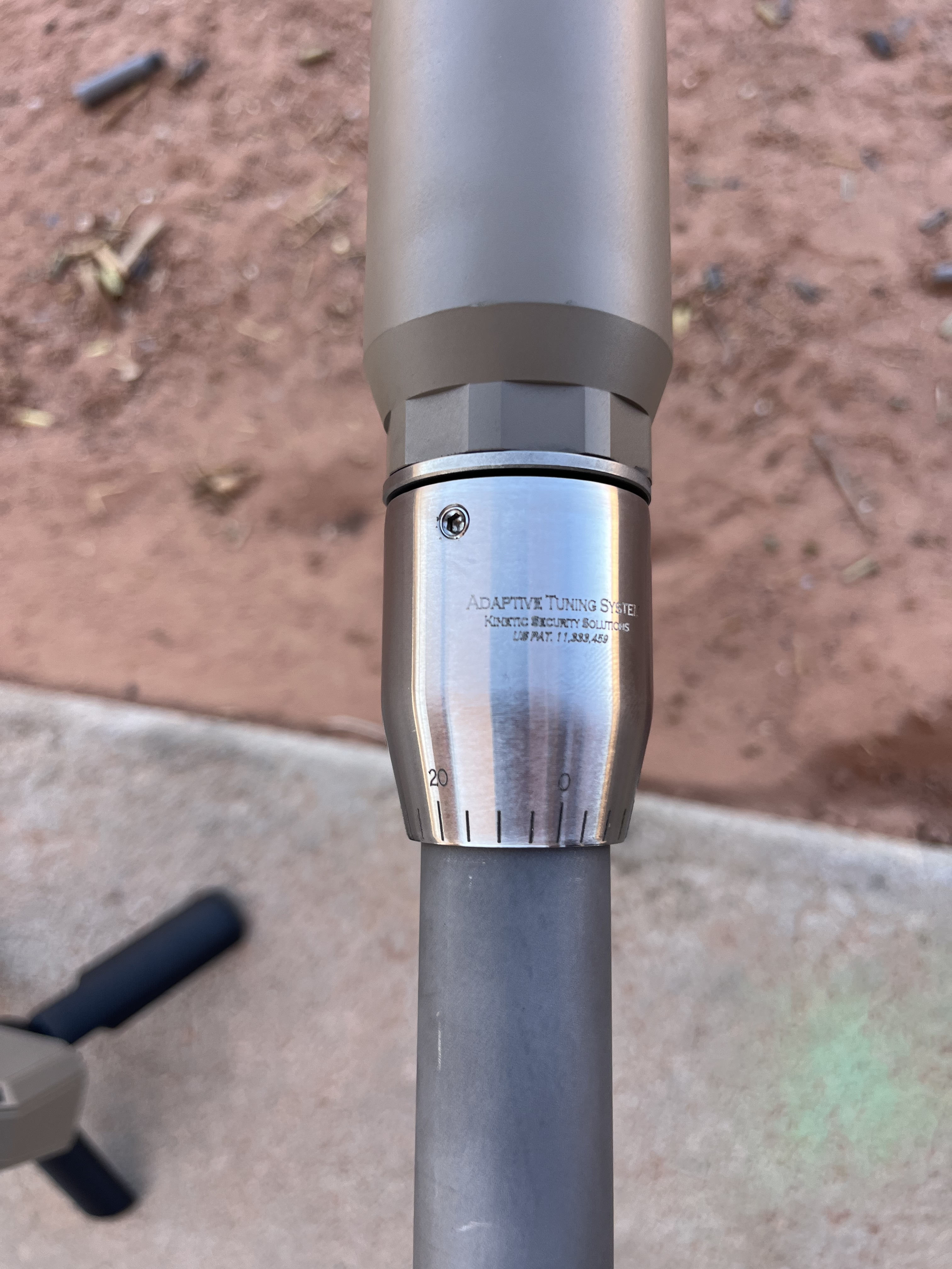

I’m at a point of starting a new load development again if I want to use my suppressor because it really opened my groups up. I’m going to purchase a tuner like you have. What rifle caliber are you using your tuner on? I’m looking to use it on a 7mm PRC.
This is a 7 SAUM. It’s a girthy barrel too .Seems like it should work for almost any caliber. If I remember they sell them with both 1/2-28 and 5/8-24 threads.

I purchased the tuner and it made a very good improvement, tightened my groups up to where I’m happy now. Thanks for the information.
