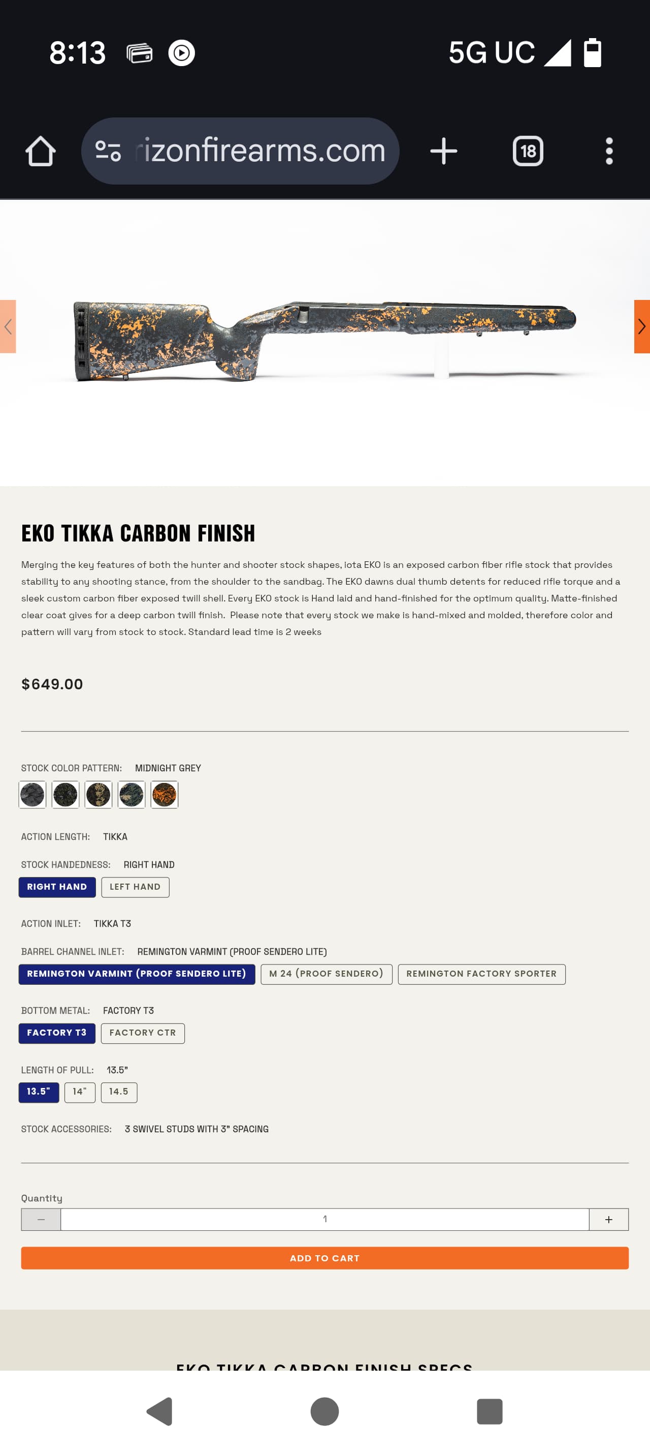

Hi guys, I just bought a Tikka T3X Lite Compact 6.5 CM 20" Barrel. I am wanting to get one of these Iota stocks for it. But not sure what to put for the specifics. I have attached an image of the options I need to chose from. I tried googling it but didn’t trust the results I found. Any input would be greatly appreciated :+1:t2: :pray:t2:
Hand - Right or left hand
Barrel Inlet - Some barrels are thicker than others so you’ll need to know how big of a channel you want cut in the stock. What barrel will you be putting on it?
Bottom Metal - This is the shape of the cutout they make for the metal trigger guard and mag well (bottom metal) that you’ll be using on the build. I would think you’d want factory T3x.
Length of Pull - 13.5” is the industry standard. If you’re over 6’ tall, you may feel more comfortable with a 14” or 14.5”. Some people just prefer a little longer distance between the trigger and butt pad.
Thank you Jim. I appreciate it. So if I am just planning on using the factory Tikka T3X Lite 20" CreedMoor barrel that it came with. Which option would I chose? Or would that be shooting me in the foot if I want to swap the barrel out later for say like an aftermarket 22 CreedMoor barrel later on? Or would that require a different stock entirely? I would love to be able to use this stock for for stock Tikka T3X Lite 20" 6.5 CM barrel and swap it out later for a nicer 22 creedmoor barrel while still using the Tikka T3X Lite action. Is that possible? If so, which barrel channel inlet would you recommend I choose and which bottom metal option should I choose? I am pretty sure I am going to keep the LOP at 13.5". Any help would be greatly appreciated. Thank you so much guys.

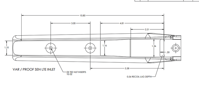

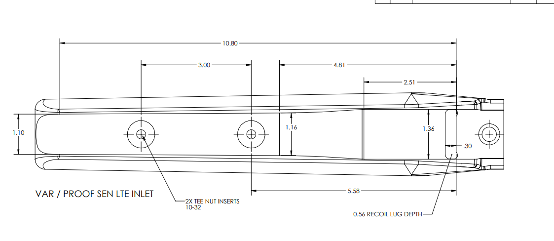

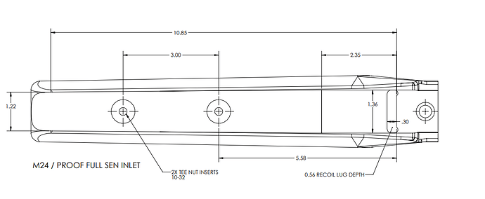

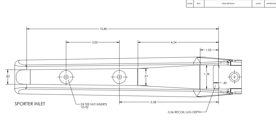

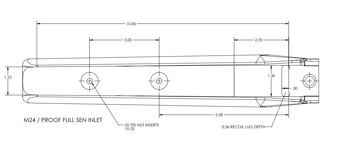

Can someone help me pick which I should choose? I cannot seem to figure out where/how to measure this stupid thing :pleading_face:
Is it just me or is this seriously lacking information to determine which one it is? Also, is this even possible to do if the barrel still attached to the stock and I don’t have a digital caliper?
