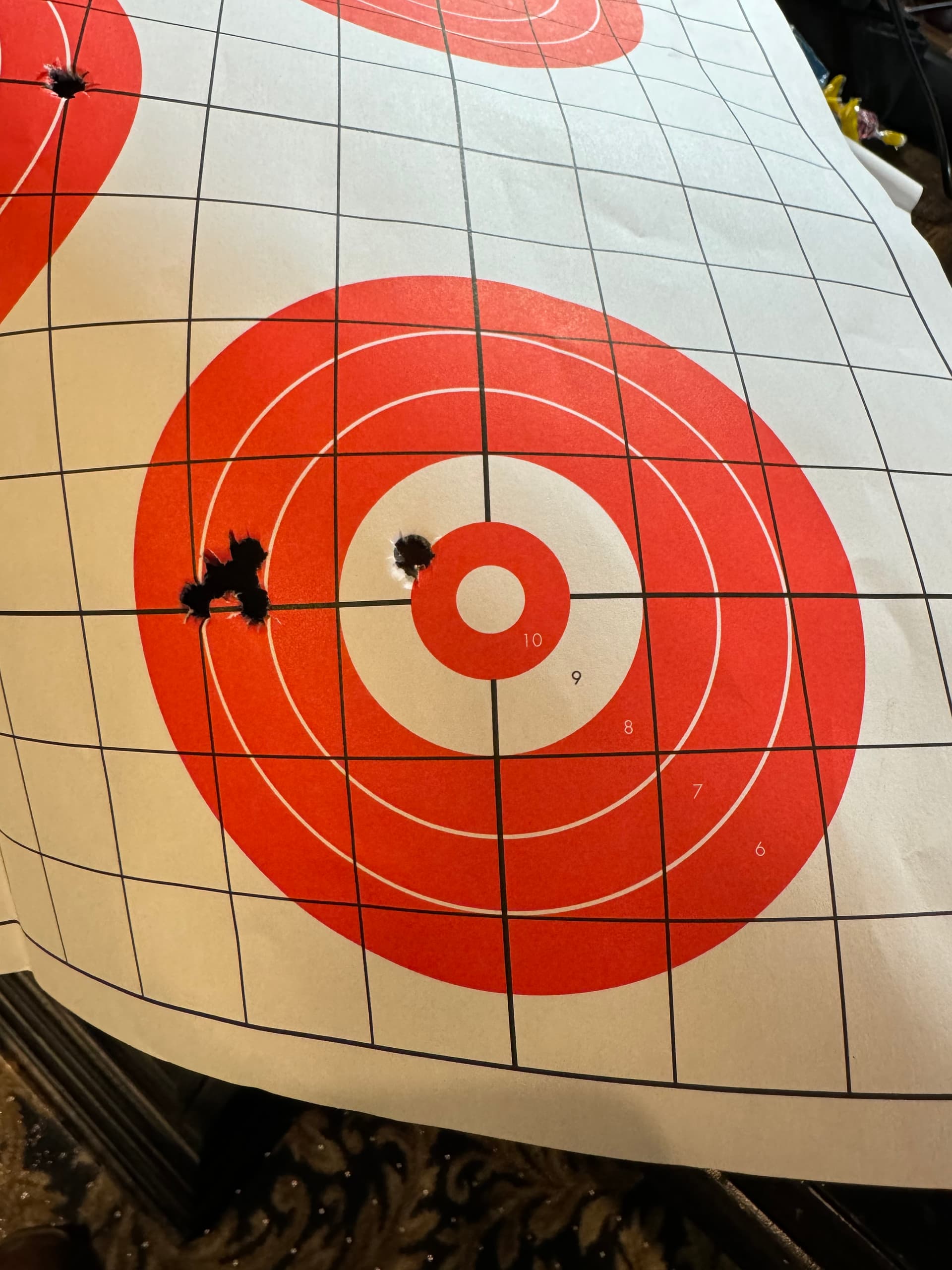

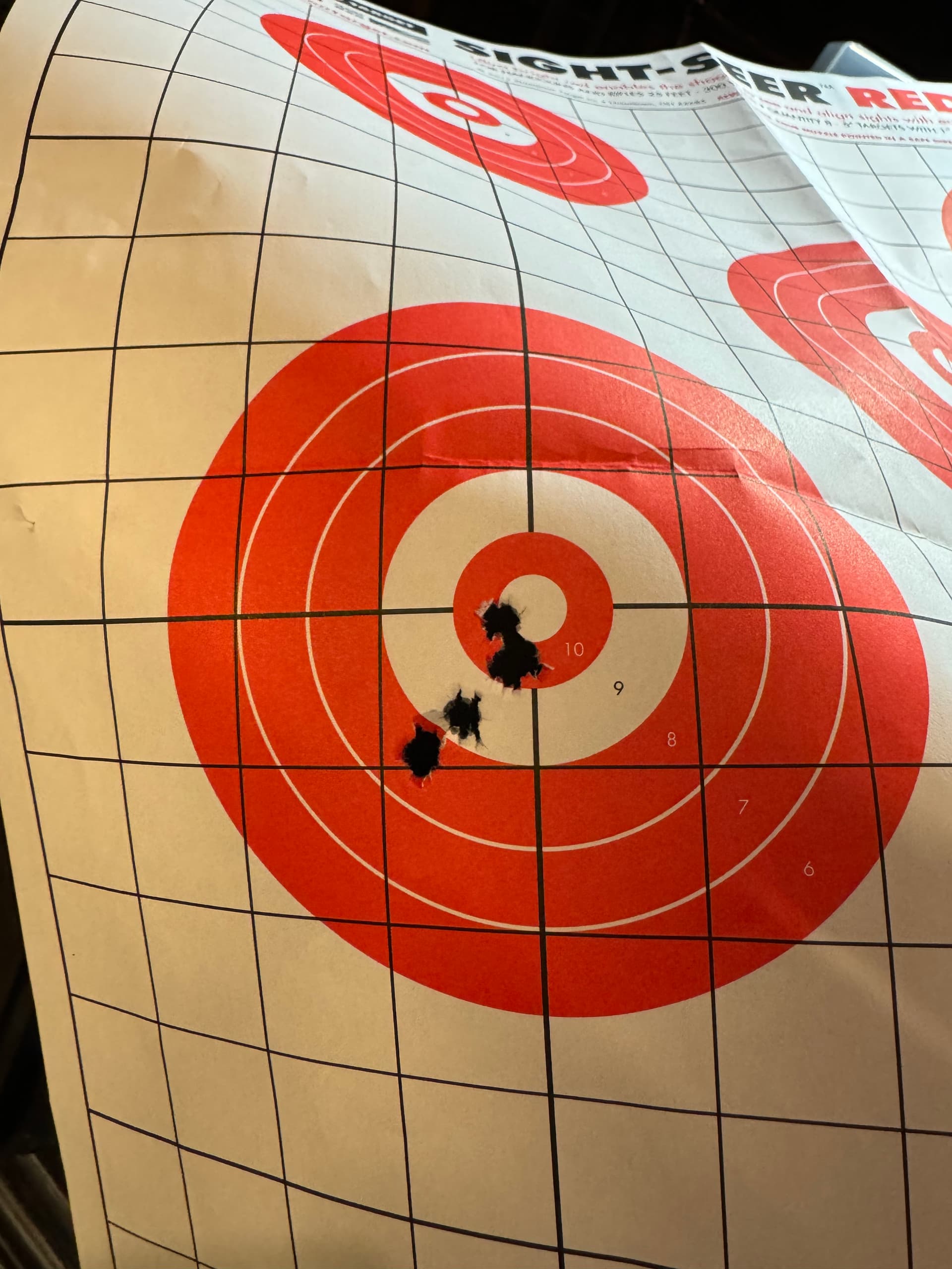

This photo was the 57.7gr load. 5 rounds tight, one flier was cold shot at 100 yards.

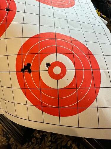

This photo was the 56.5gr load. 5 rounds at 100 yards
So since I am hunting and not in competition I think either would be ok, but for hunting the average 3016.5fps and the 15.5fps spread with 5.3fps Std Dev is really hard to beat.

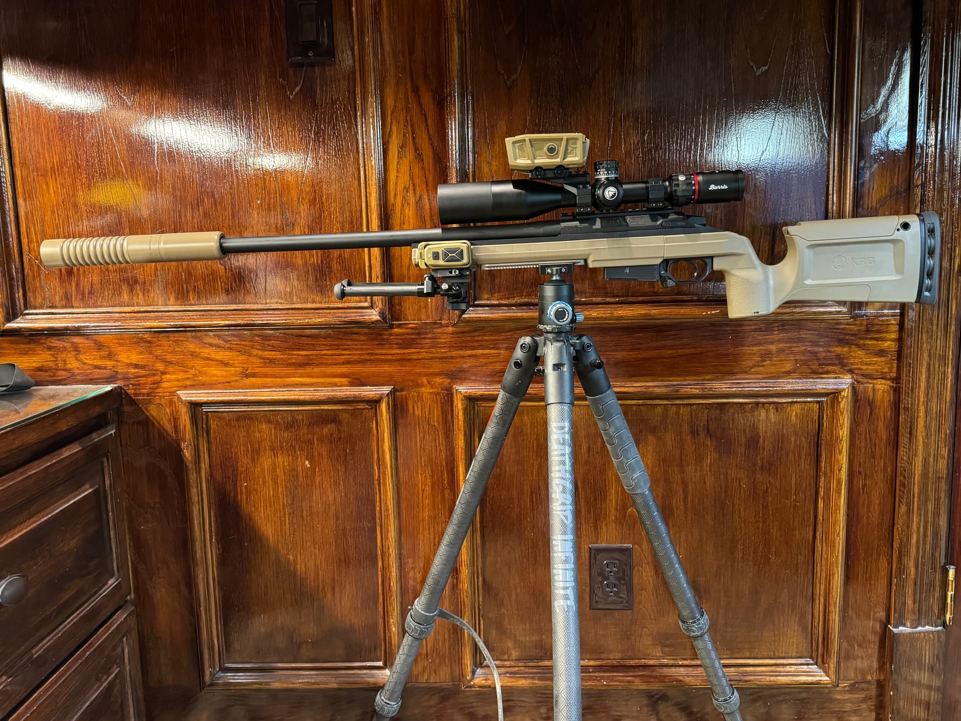

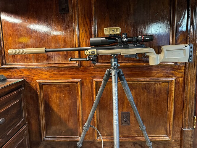

FYI this was a Seekins Precision Havak Bravo, 24" barrel, Burris Veracity 4-20x50, with AB Raptor suppressor. Trigger set to 1lb 8oz.
