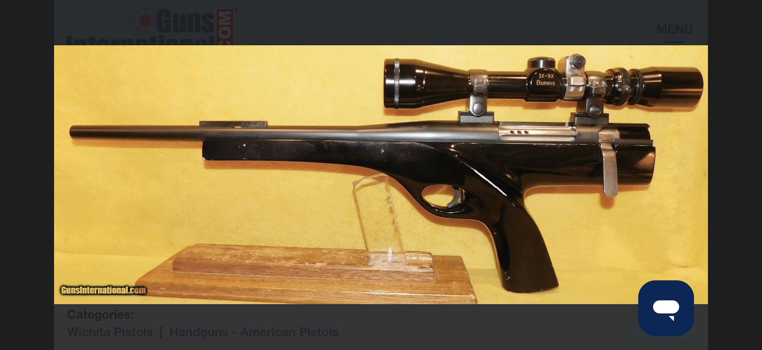

This, or something similar, will be my answer to the issue of too heavy.

Yeah, I’m not going up those steep slopes with a 2 lb pistol. Mild slopes are fine. I regularly haul about 20-25lbs of camera gear (short distances), and that’s about what I’ll be limiting my hunts to.
