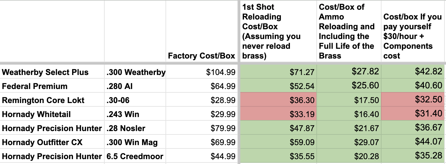

Here’s my breakdown of how much you’d have to reload to make it worth it price-wise. It’s actually not bad, but the real reason to reload is better ammo that you can infinitely customize, and the fact that you can ALWAYS have your ammo no matter what insanity is going on with people panic buying.
Do you mean that the first box I make would be cheaper in all but 2 calibers, even if I never touched the Cades again?!
That’s amazing!

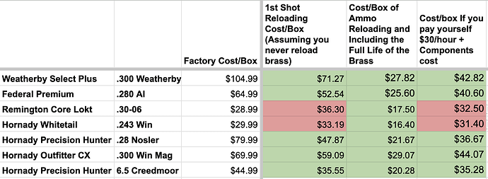

For the never reuse brass cost calculation,
did you factor in the drop in capital expense? Don’t need to purchase case cleaning equipment, only need to purchase a single seating die, no resizing dies, no annealing, etc?
