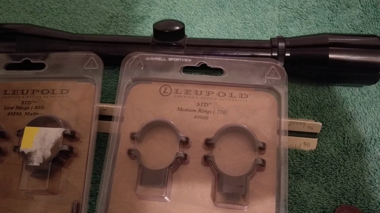

I typically use the penny stack method. Here is a link to video which might be of help:
