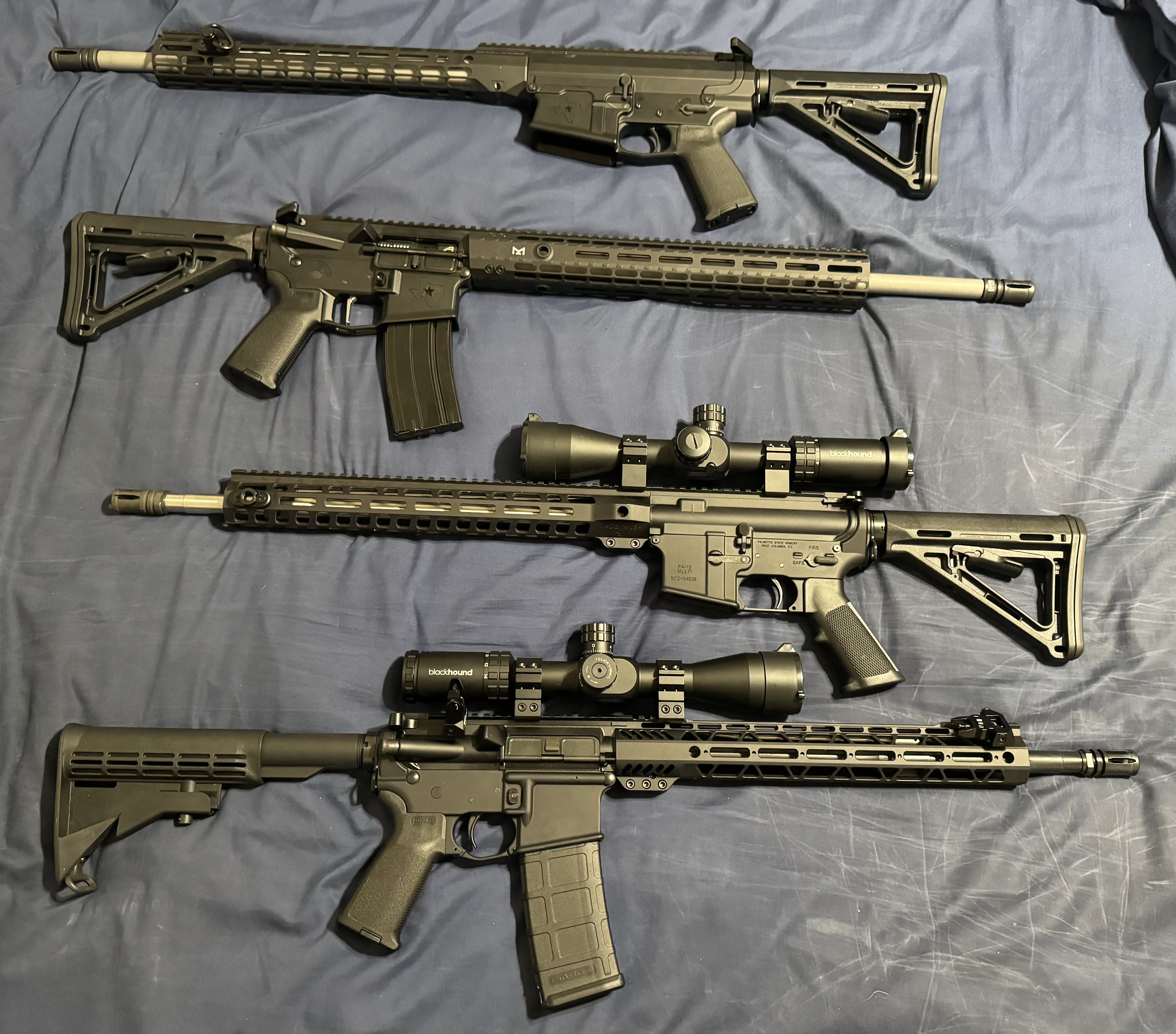

I have purchased several Palmetto State Armory complete uppers and all of them have shot very well if I do my part. I have 2 sons so I would “build” one and then when they were old enough give it to the oldest, “build” another and then when they were old enough give it to the youngest, and then built one for me.
What I’m building now is an AR-10 in 308 using Aero Precision parts. I live in SE Alaska and my FFL gets AP with minimal shipping costs.
