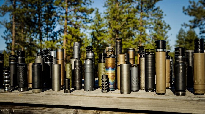

I see Outdoor Life just released a giant suppressor test, worth the watch plus they have all the results, of the 149-ish cans/brakes they tested… seemed pretty neutral and didn’t feel as they pushed one brand or another.
