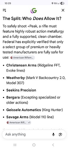

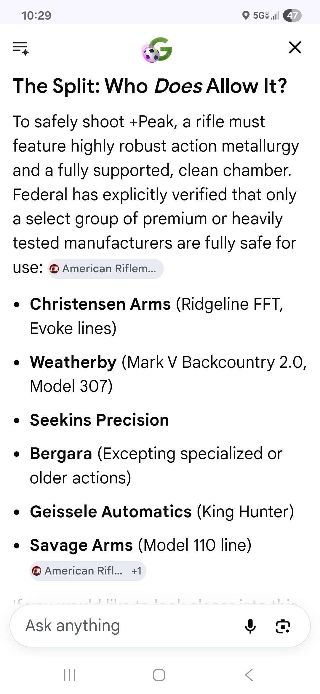

So apparently Tika actually has said they don’t recommend it. However I had to use Google AI to find that out. It’s not like they made some Grand announcement with multiple YouTube videos, or posts on major forums, Etc
And some do state they can handle it

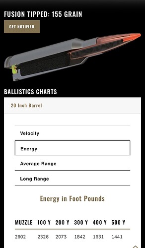

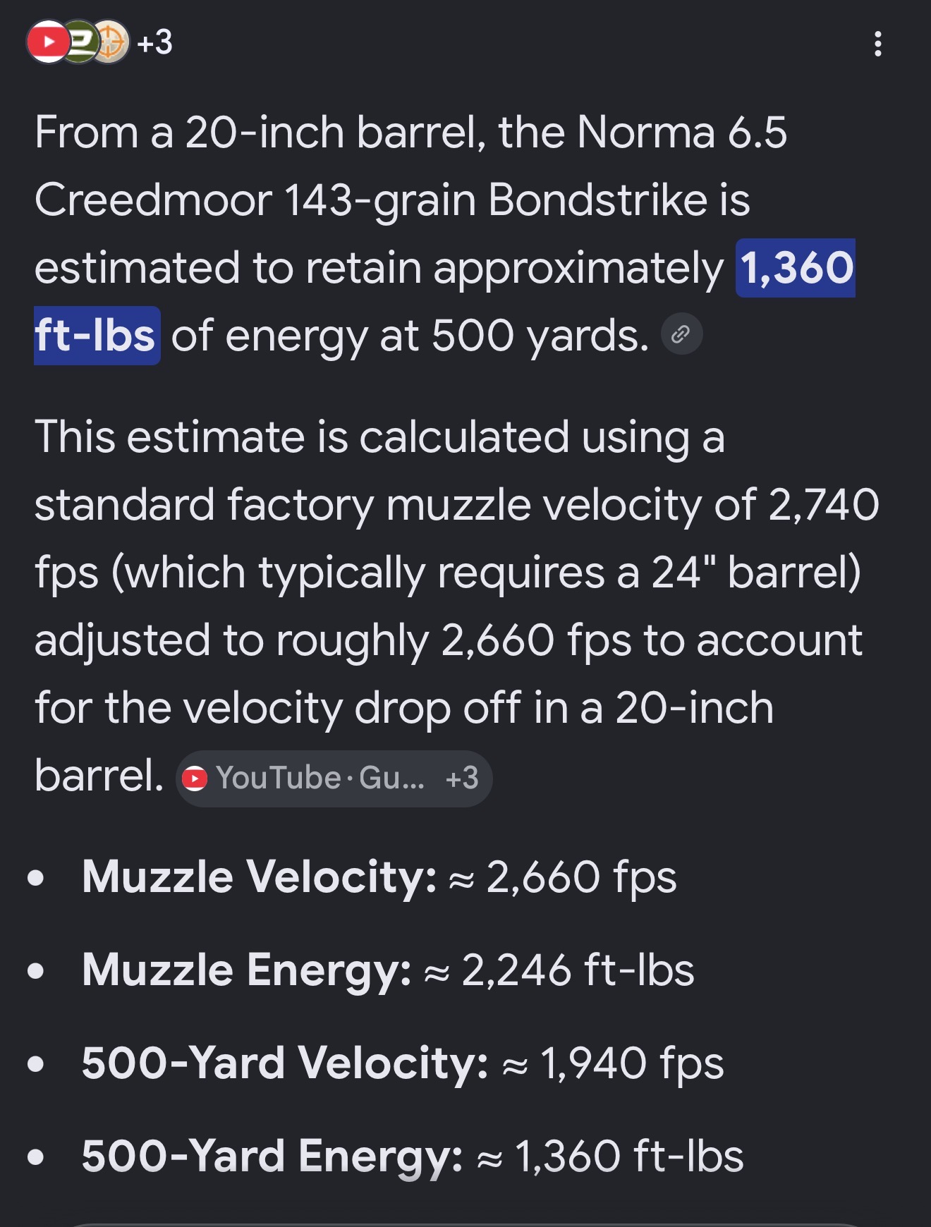

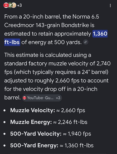

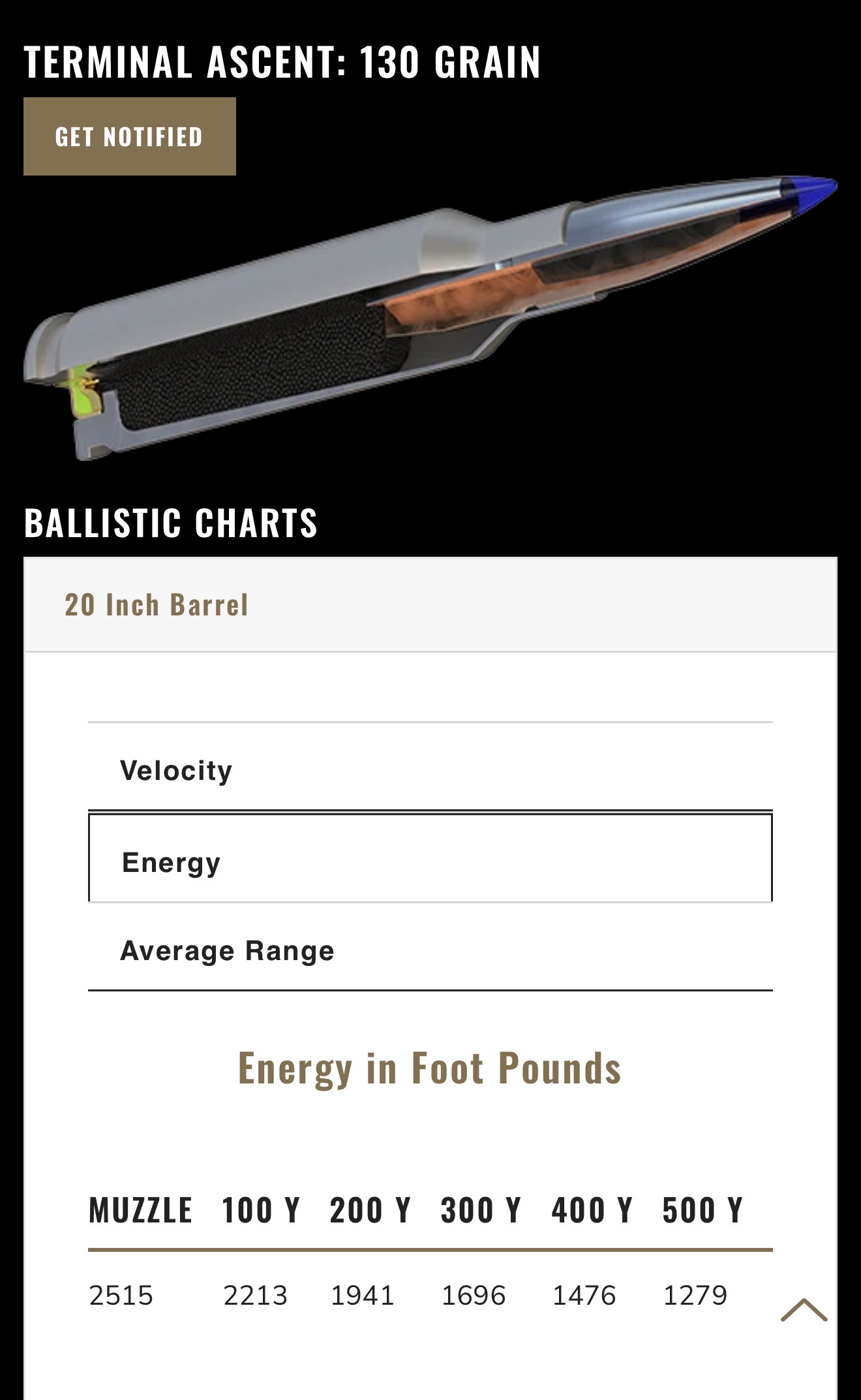

I’m looking at the info… and from a hunting aspect energy kills… I don’t see the point of the plus peak, as what’s it really gaining except in terms of pressure…. I shoot the Norma bond strike $40+/- a box out of my 20” Springfield waypoint bsa carbon barrel and the data shows the following for just regular off the shelf 6.5 creedmoor

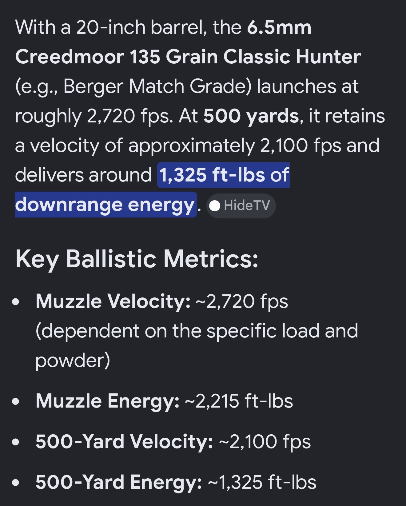

Then you look at some Berger ammo off the shelf $40+/- a box

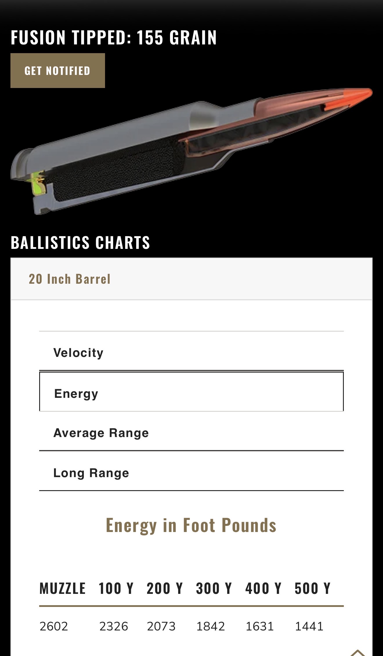

Those compared to this federal peak ammo published ballistic’s out of 20” barrel, (non peak box ammo price for terminal ascent $48+/- currently and fusion going for $38+/-) I’m sure the peak ammo will cost more…
Looks like they have a good idea, but at this point I don’t see it killing the 6.5 PRC, I think this high pressure stuff mated with the new barrel technology will surpass things eventually
