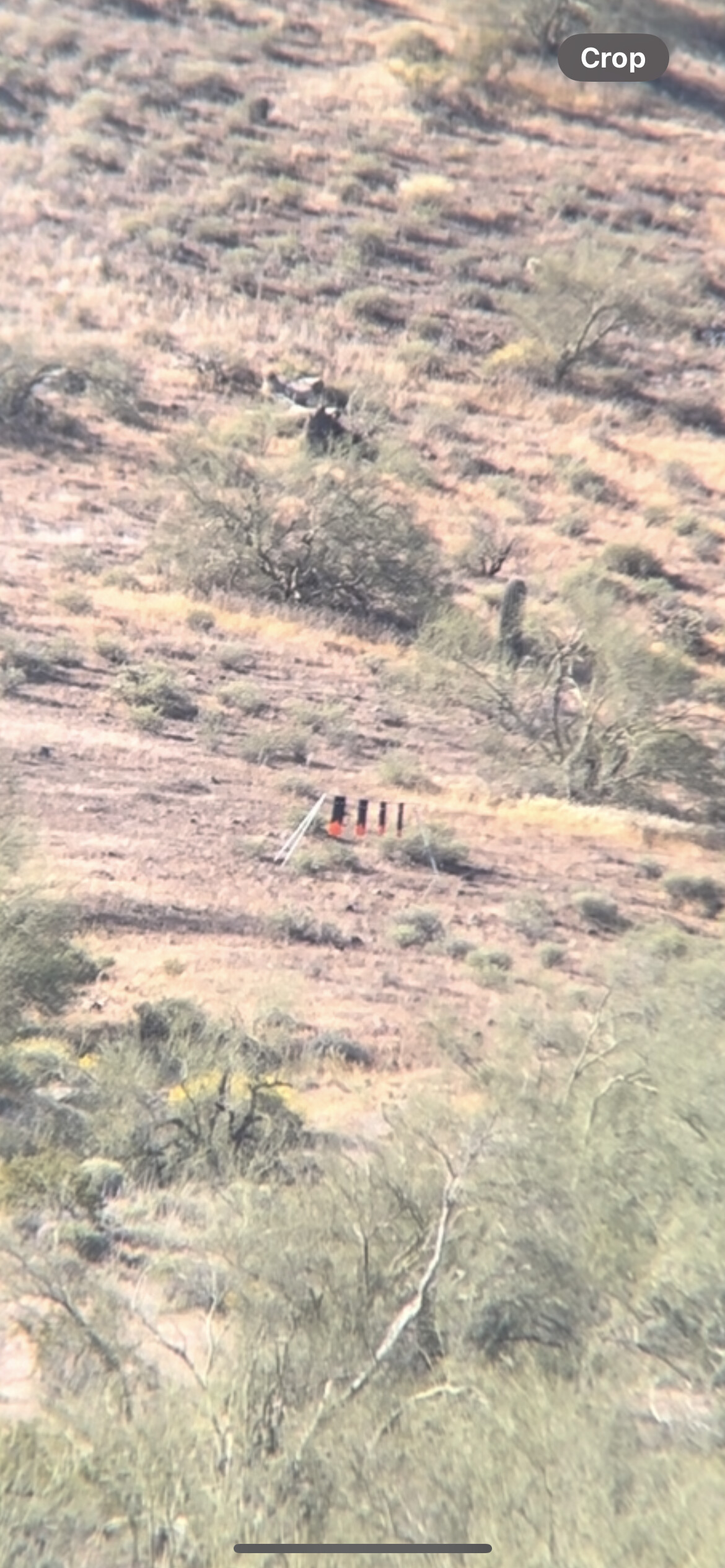

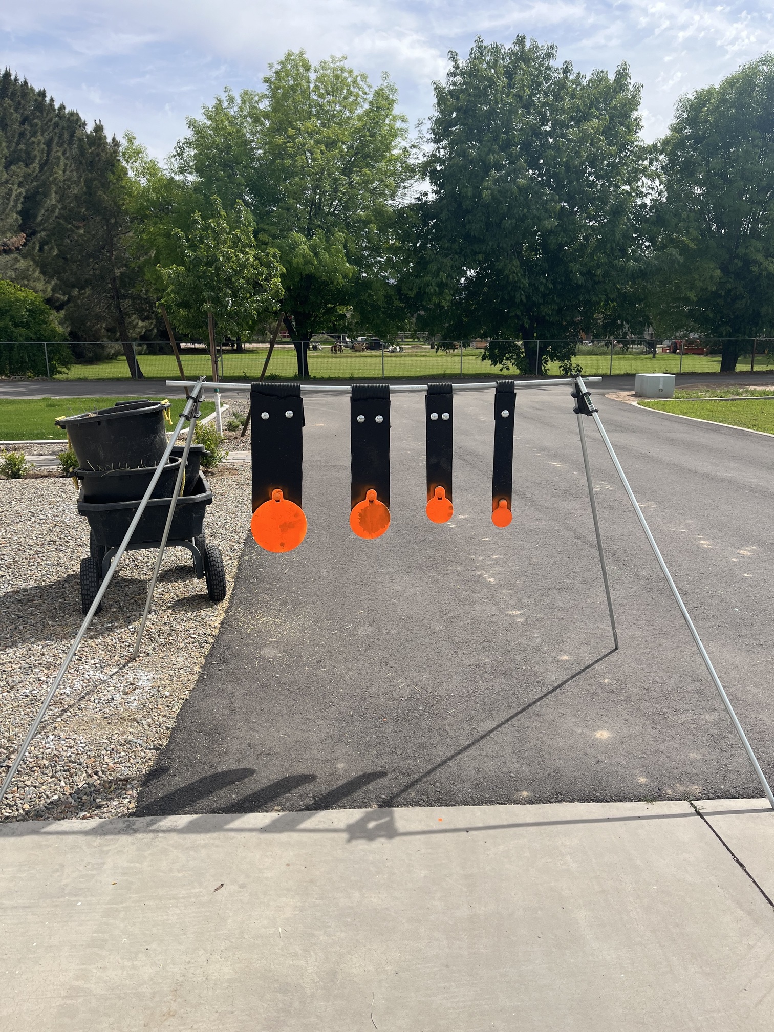

Here is the KYL rack I made for myself. It’s worked out great so far. 8”, 6”, 4”, 2”. The picture is out of my 10x binoculars at 400 yards. It’s a fun challenge for sure. When Cortina said it’s difficult when your crosshairs are covering the entire target, he wasn’t kidding lol!
Very nice! Thanks for sharing. What did you use for the “straps”?
I just used a spare horse stall mat we had laying around. Secured it with bolts and wing nuts. Super durable and easy to work with!

So your moa’s are 2, 1.5, 1, 1/2 by design?
