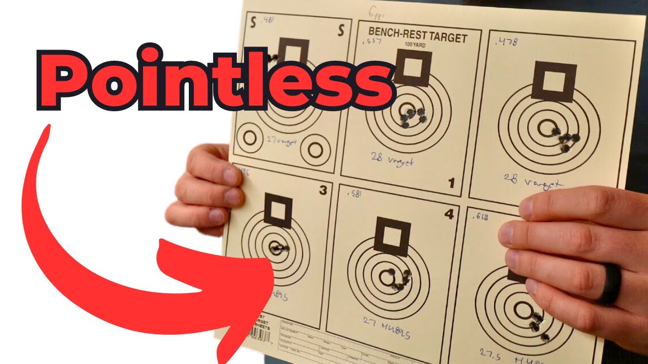

What were your thoughts on the video showing that the ladder test for powder charge simply doesn’t work?

In this video, the guy use a rigorous statistical analysis to show how truly useless load validation via ladder testing is with 5-shot sample size (or 20 shot or 100 shot).
To quote Ed McMahon: “You are correct, sir!”
and the video is spot on. The ladder test is, statistically, so unreliable you could just write 6 loads on paper, roll a die, and go with load # that matched die # … statistically just as reliable to pick the “best” load as with the ladder test.
It’s just amazing to me how many very skilled top-ranked shooters are still putting so much effort into doing it when it makes so little sense.
Humans in general find false correlations in everything. Everything. Scattering tea leaves and reading them will give as good a result.
