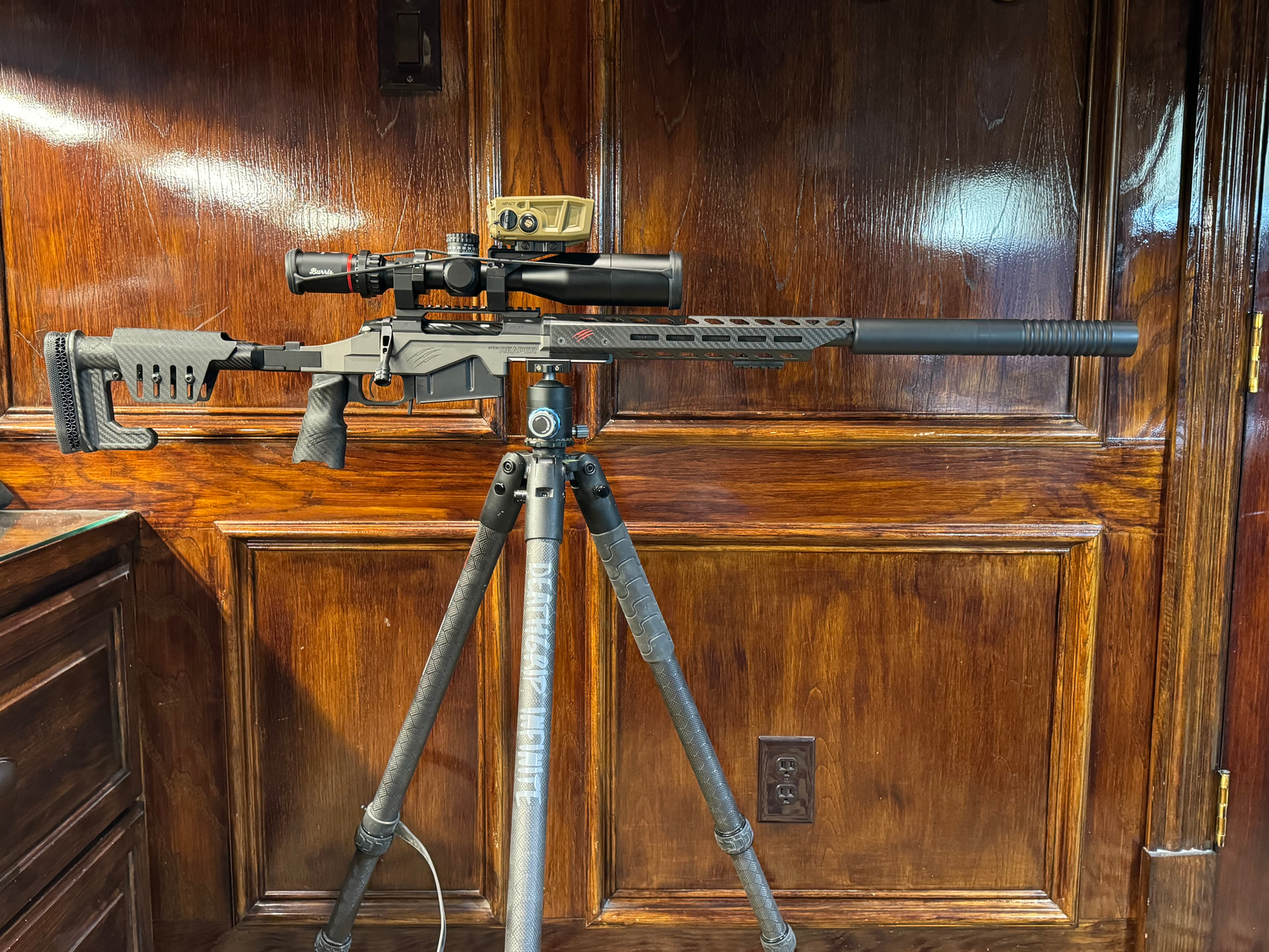

My rifle is a Fierce Mountain Reaper with a 20 inch barrel. However it does have a AB Raptor Suppressorwhis adds a bit more length.
