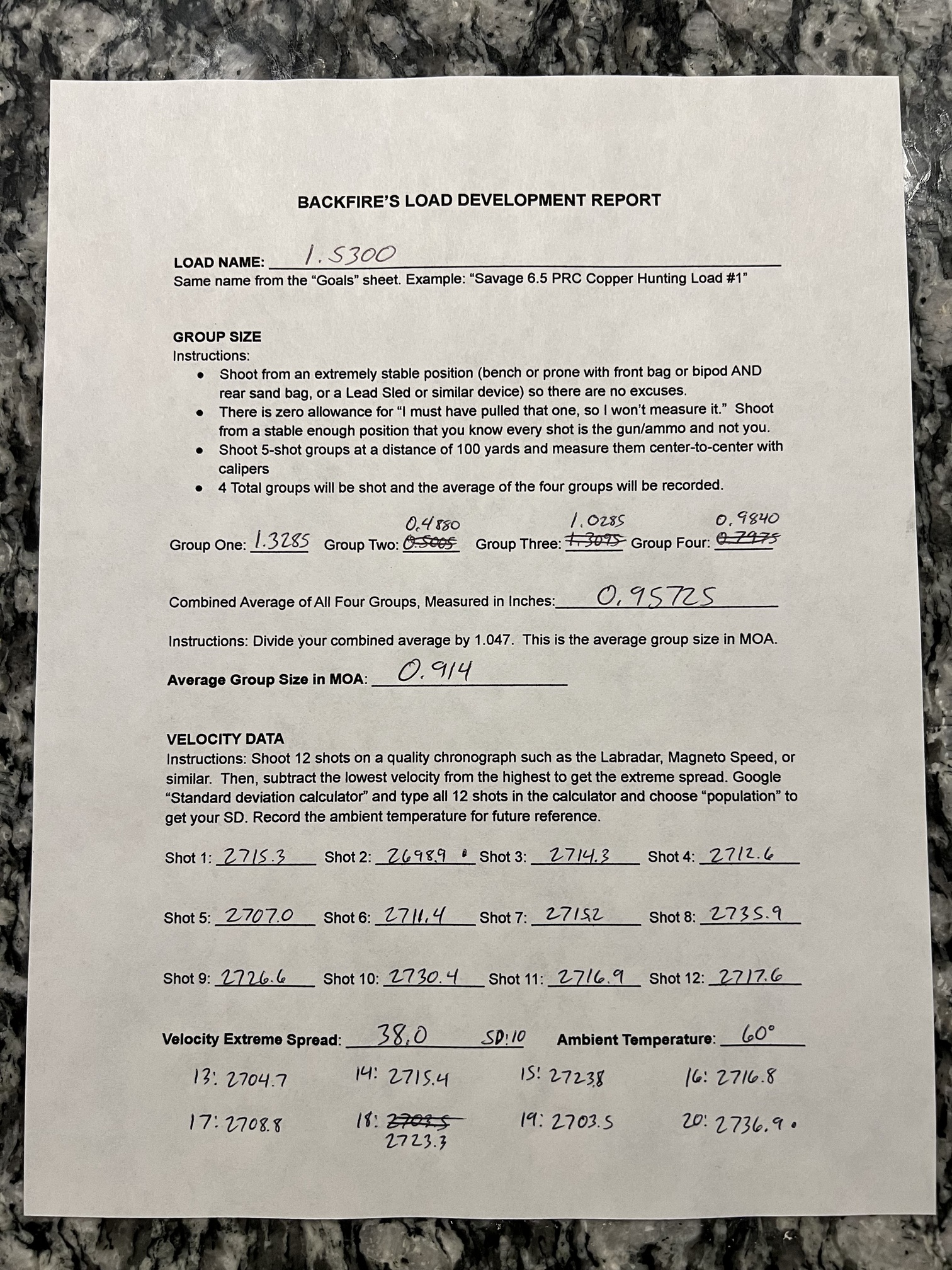

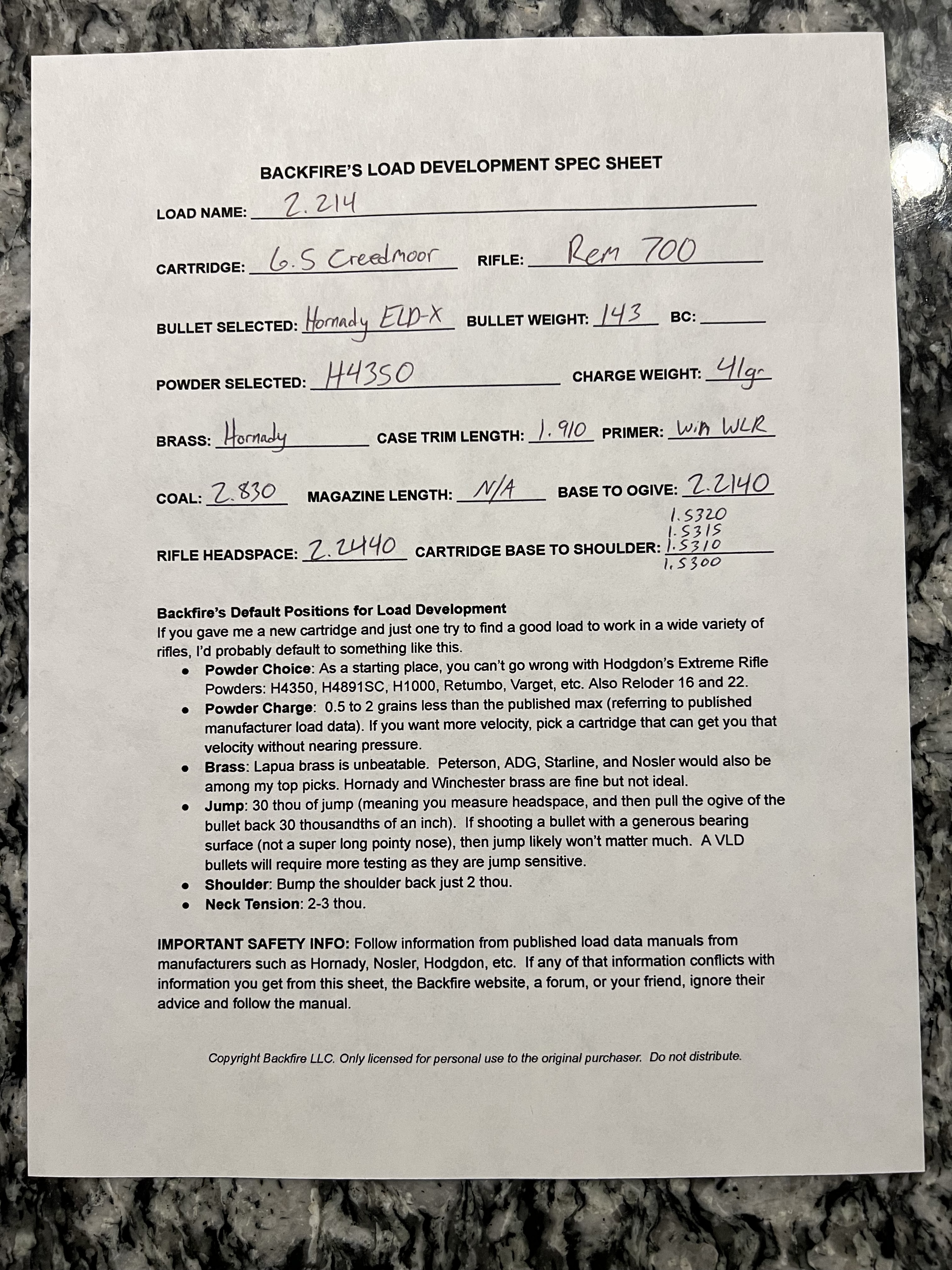

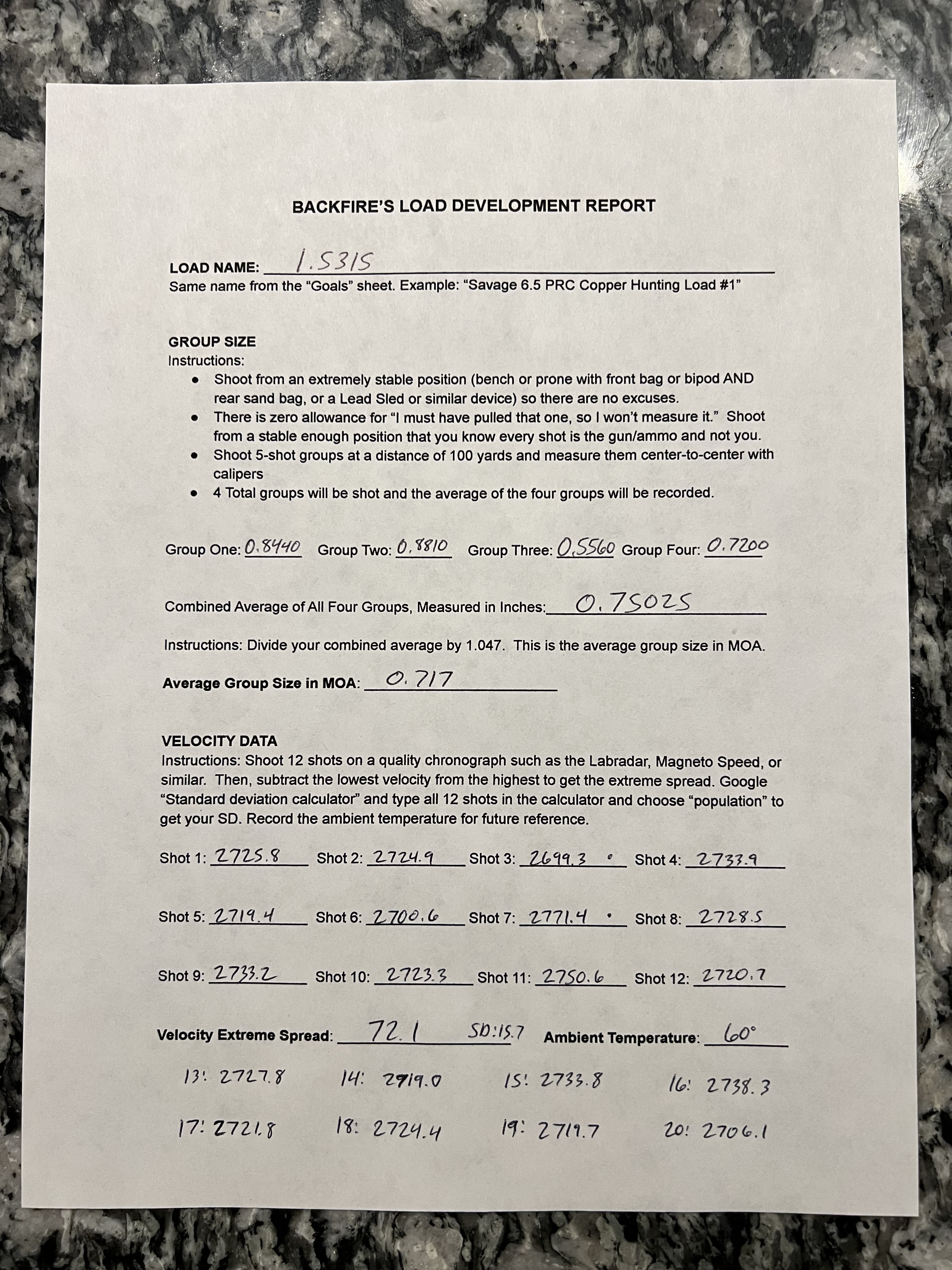

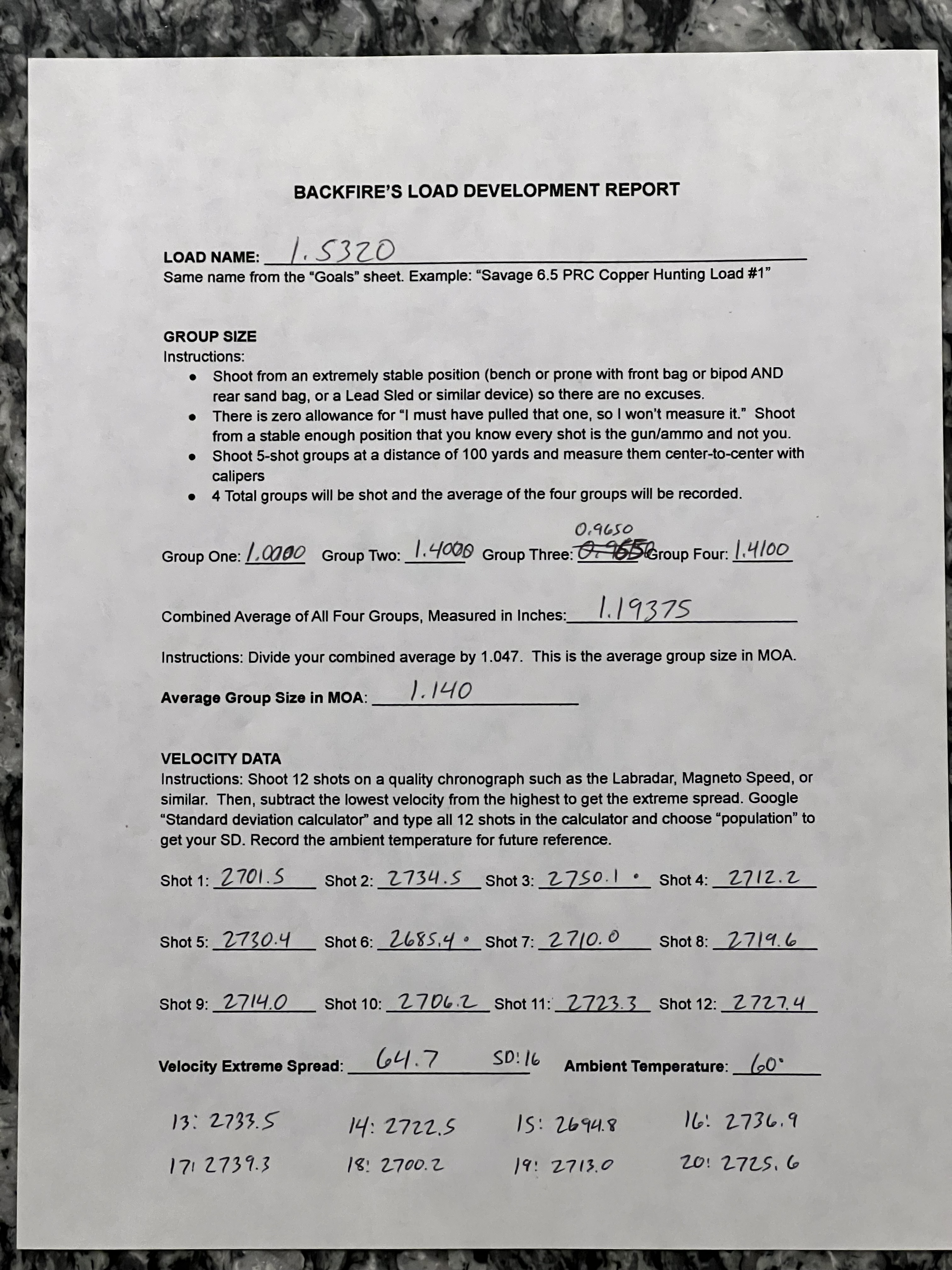

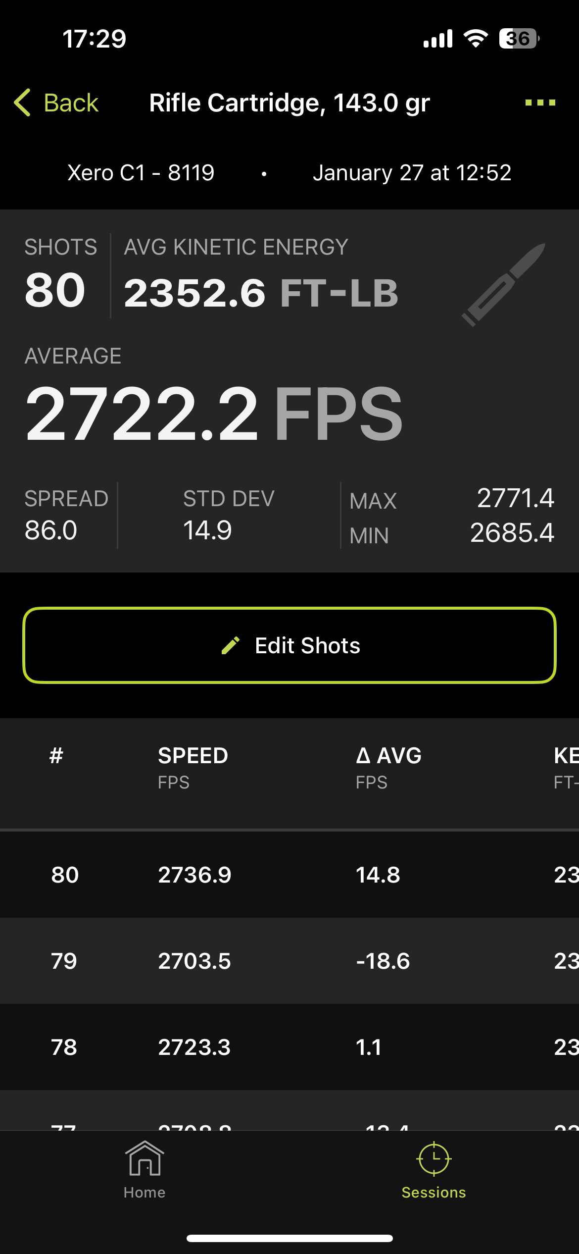

So I tested my first batch of ammo today. I wanted to eventually test every variable to see what might matter, and the first measurable variable in my reloading process is the variation in shoulder bump that I get from my Redding Premium full length resizing die. I separated the brass into 4 different shoulder bump measurements and then loaded everything else the same. What I was not expecting to see out of these 80 rounds, that all had exactly 41.0 gr of H4350 out of the Hornady Auto Charge Pro, was such a large variation in velocity with a total ES of 86fps. What is even more confusing is that the individual “bump” group with the worst ES of 72.1, had the best groups! I am including pictures of my data for anyone interested in looking it over and giving me their thoughts.
At short distances like 100 yrds, you are not going to see a big difference in group sizes with large ES. But at longer distances you will see a difference between a low es group and a high es group.
I haven’t cracked the low es code myself yet. I do know a couple of the other reloader sites and video channels I watch swear that mandrel sizing your neck makes the biggest difference. I’ve tried that and it seems to work with some but not others.
Yes, I am worried that once I try to stretch out the distance, my consistency will be garbage because of the ES I am getting. I may have to look into the mandrel resizing and see if that helps. I do want things significantly tighter and more consistent with my loads before I worry about distance though. I just wasn’t expecting velocity to be a large variable today! :cry:
An sd of 15 is equivalent to most factory ammo. It’s not bad. Getting under 10 is tough to do.
A 15fps SD will only account for 2” of average error at 700 yards with a 6.5 Creedmoor at a standard velocity.
With the amount of time and effort that I put into this, I expected significantly better than factory ammo.

Remember that velocity differences like this won’t even be measurable on target at 100 yards, and only account for about 2” at 700 yards. Not saying to ignore SD. Just saying there are bigger fish to fry right now. Your groups are around 0.95” at 100 yards. If we can shrink the groups to half an inch, that would make about a 50% bigger change to your down range accuracy than getting to a single digit SD.

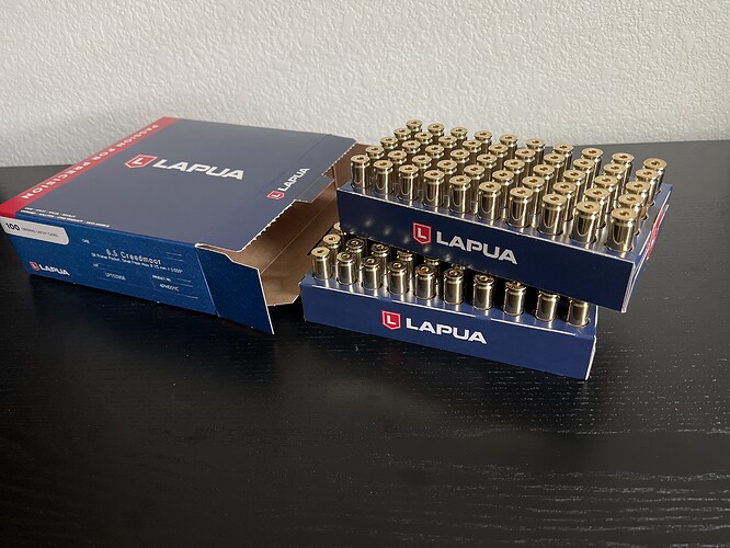

Apparently Lapua changed their packaging and no longer sends brass in a useful case! :cry:

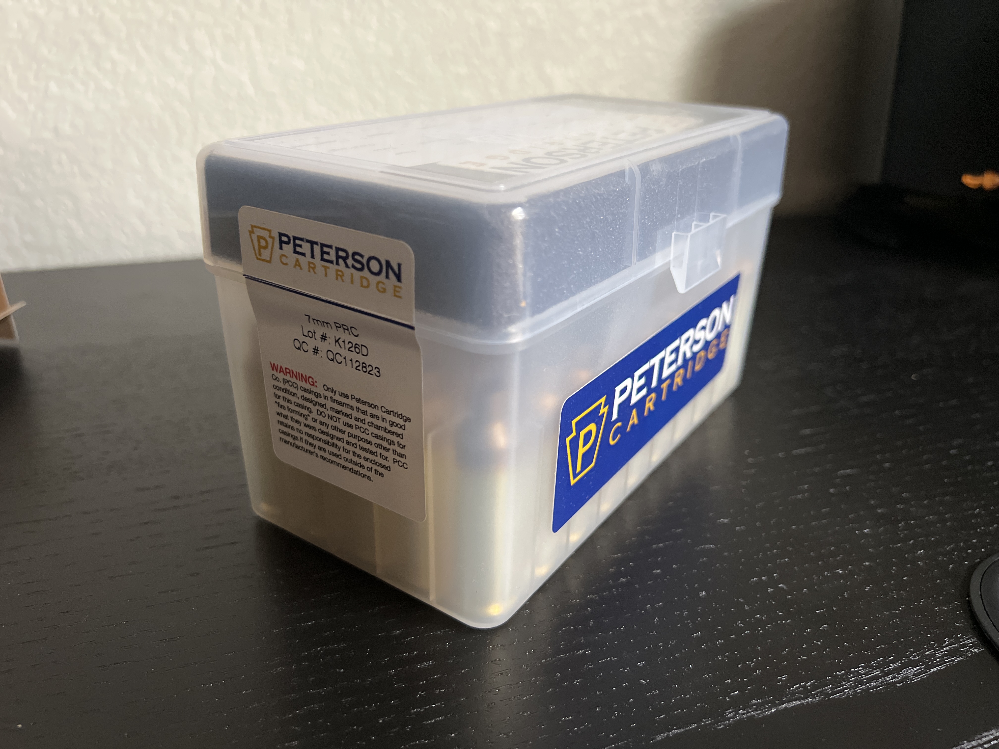

At least the 7PRC Peterson came in a case!
