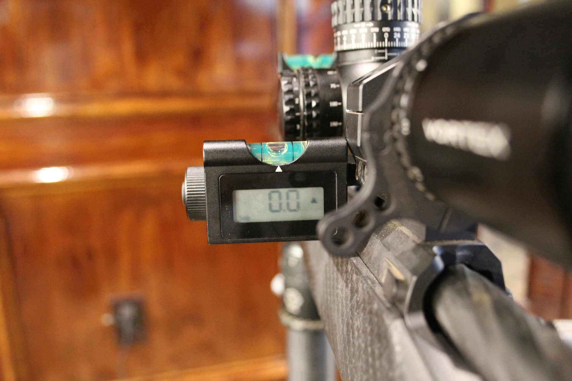

The other option is an electronic device that is used to level the rifle. the one in the photo also has a bubble level as well as the digital read out. Then use a bubble level on the turret and rotate the scope to match the bubble level on the rifle level.
