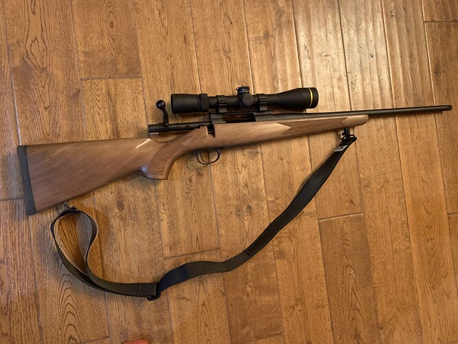

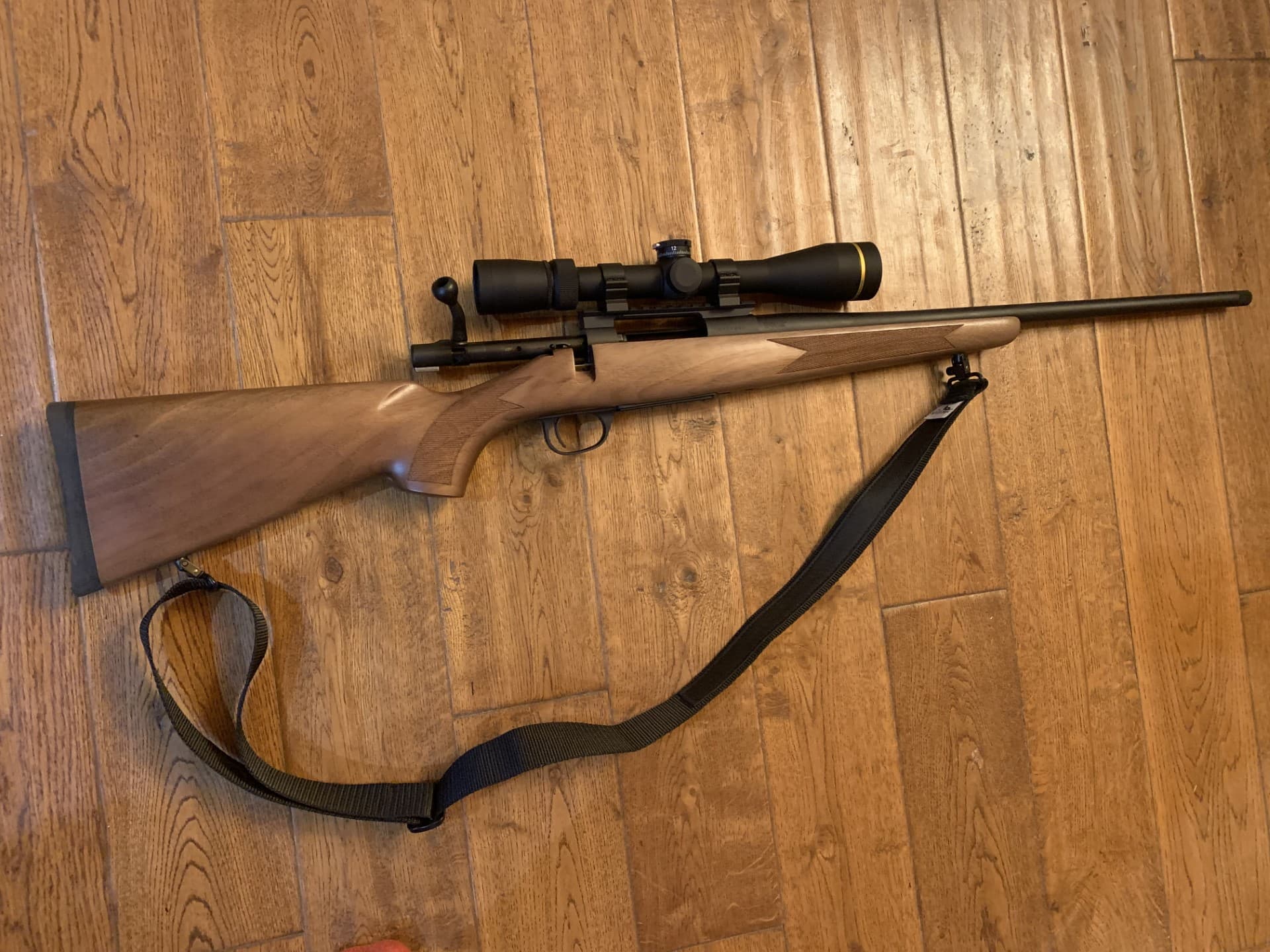

Adding some notes about the one I recently picked up in .243; got it all sighted in and tested several loads…
  • Howa Superlite .243 Winchester, Walnut stock (5.5 lbs.)
  • Matte black barreled action, threaded 1/2x28
  • 3 round flush polymer magazine
  • Leupold PRW rings, low (4.3 oz)
  • Leupold VX-3HD 3.5-10x40 (13.5 oz)
    Total weight: 6.6 lbs. unloaded
One of the other cool things about the walnut stock option (and why I snapped it up) is that it only costs USD $600, where the carbon stock is a bit lighter, but I think it retails around USD $900-1,000.
Shot 3 groups of 3 each @100 yards:
  • Winchester PowerPoint 100 gr: 1.07" average group, best group 0.72"
  • Hornady American Whitetail 100 gr: 2.02" average, best 1.13"
  • Remington Core Lokt Tipped 95 gr: 1.75" average, best 1.25"
  • Federal Premium Berger Hybrid 95 gr: 0.94" average, best 0.25"
  • Federal PowerShok 80 gr: 1.25" average, 0.75"
  • Hornady V-MAX 87 gr: 2.45" average, best 1.60"
  • Hornady Precision Hunter 90 gr: This ammo did not “fit” into the chamber–could not rotate bolt down into closed position? Weird.
So, wow–that Federal Premium Berger Hybrid! Excellent. Got some other really respectable groups with a few other (cheaper) options too. Not sure what is up w/ Precision Hunter here…
