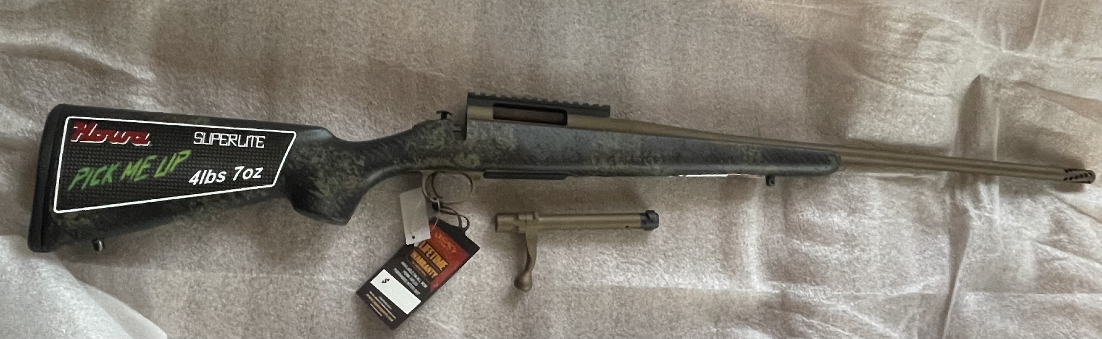

I did get my hands on one indeed.
I had to have it - had to go through customs though. Bought four weeks ago - arrived today.
Feels like a toy, not cheap but light.
7mm-08Rem
Apologies for the poor quality.
As soon as it warms up I bit I’ll put some rounds through :blush:
Congrats!
Is it threaded 1/2 x 28, or something else?
Very cool. Can’t wait till you get some trigger time. Very curious to see how you like it.
Re: the Howa Superlite… I like your description: light, but not cheap–that is a good point. For being so crazy light it is a good quality piece of manufacturing. I decided I had to try one of these as well; I have been seeing it more often and this thread was in the back of my mind whenever I would come across it. I also like that it is threaded and therefore suppressor-ready.
So, I just picked up one in .243 today, with a walnut stock instead of the carbon version (adds 1 more pound). Still, I put a lightweight Leupold scope on this thing and the total weight is just under 6 and 1/2 lbs. Excellent. I will shoot some groups over the holiday weekend, and post some pics later. I might remove the pic rail and just use a one-piece mount (DNZ Game Reaper). Certainly the lightest weight (centerfire) rifle I own. I think my next lightest is the Tikka T3x Lite which is still another pound or so heavier.
