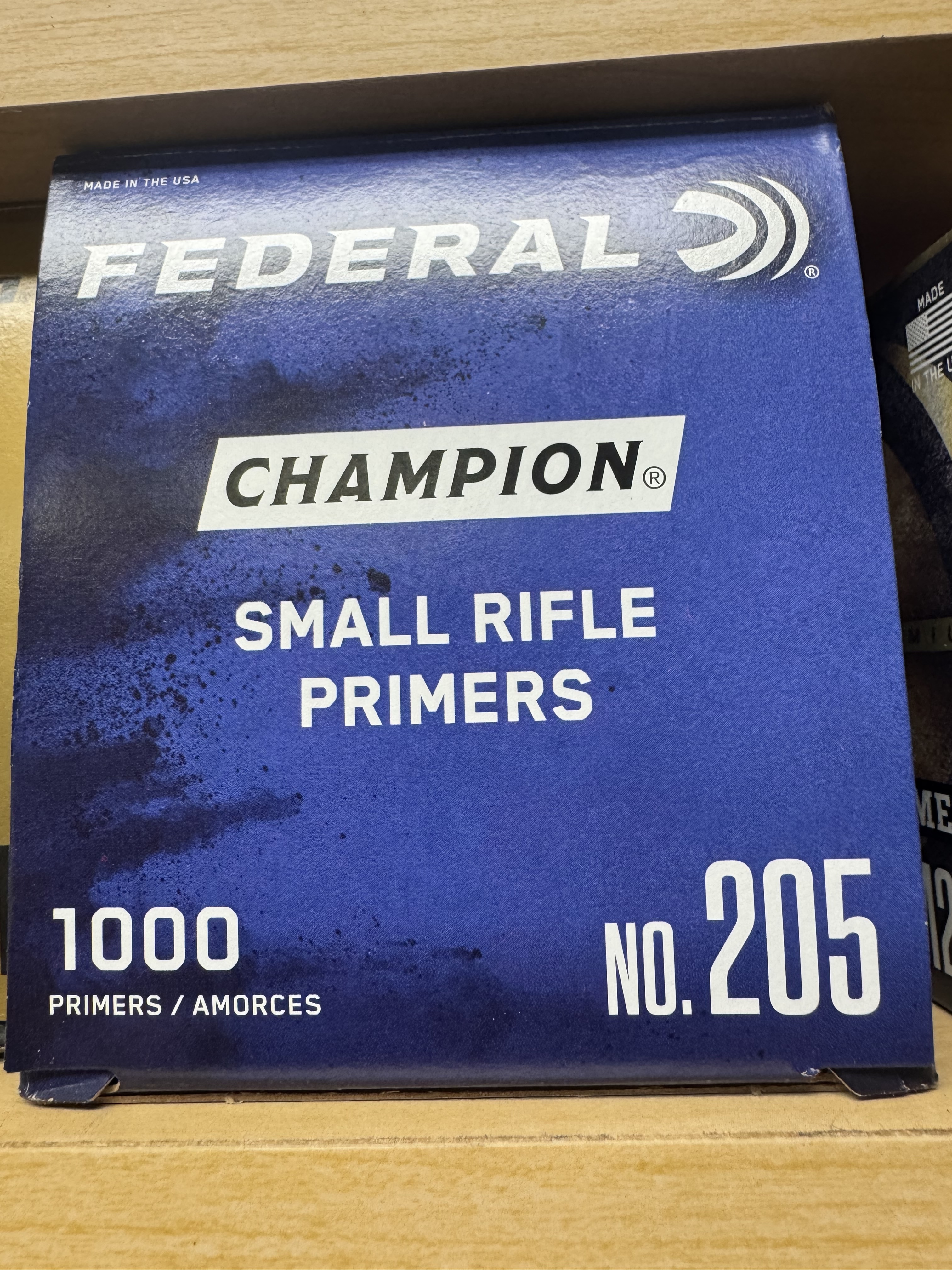

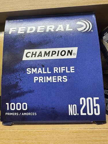

Do you mind sharing your powder, load, bullet, and perhaps the distance from the lands? And maybe what primer you were using?
Thanks!
New Lapua brass
I also measure everything.
Thanks! I appreciate the info. My plan is to make up 5 very similar to your load and then try a few loads in the general vicinity. If I remember I’ll post my results. I have ADG brass and federal 210 primers, otherwise planning to use the same bullets and powder.
