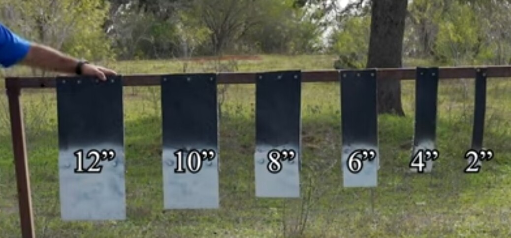

I am wanting to make one of these. Planning on shooting it with a 7prc amd 300prc plus other similar to smaller loads. What thickness and does metal type help with the gong sound. Im sure the way you hang it effects the noise.

500 to 1000 yards

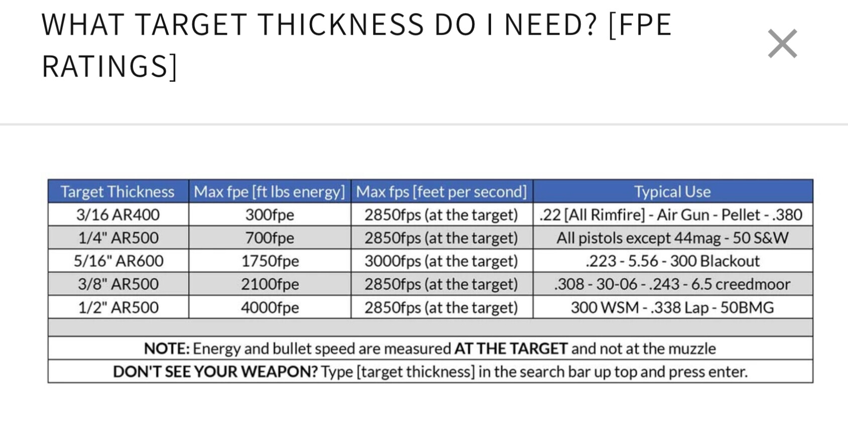

I got this info from www.shootingtargets7.com where they sell the Know Your Limits (KYL) target set:

I think 3/8” ar500 will be fine for what you’re doing. You may get some pitting, but I don’t think you’ll be blasting holes in the plates even with 300 prc at 400 yards. My two cents.
