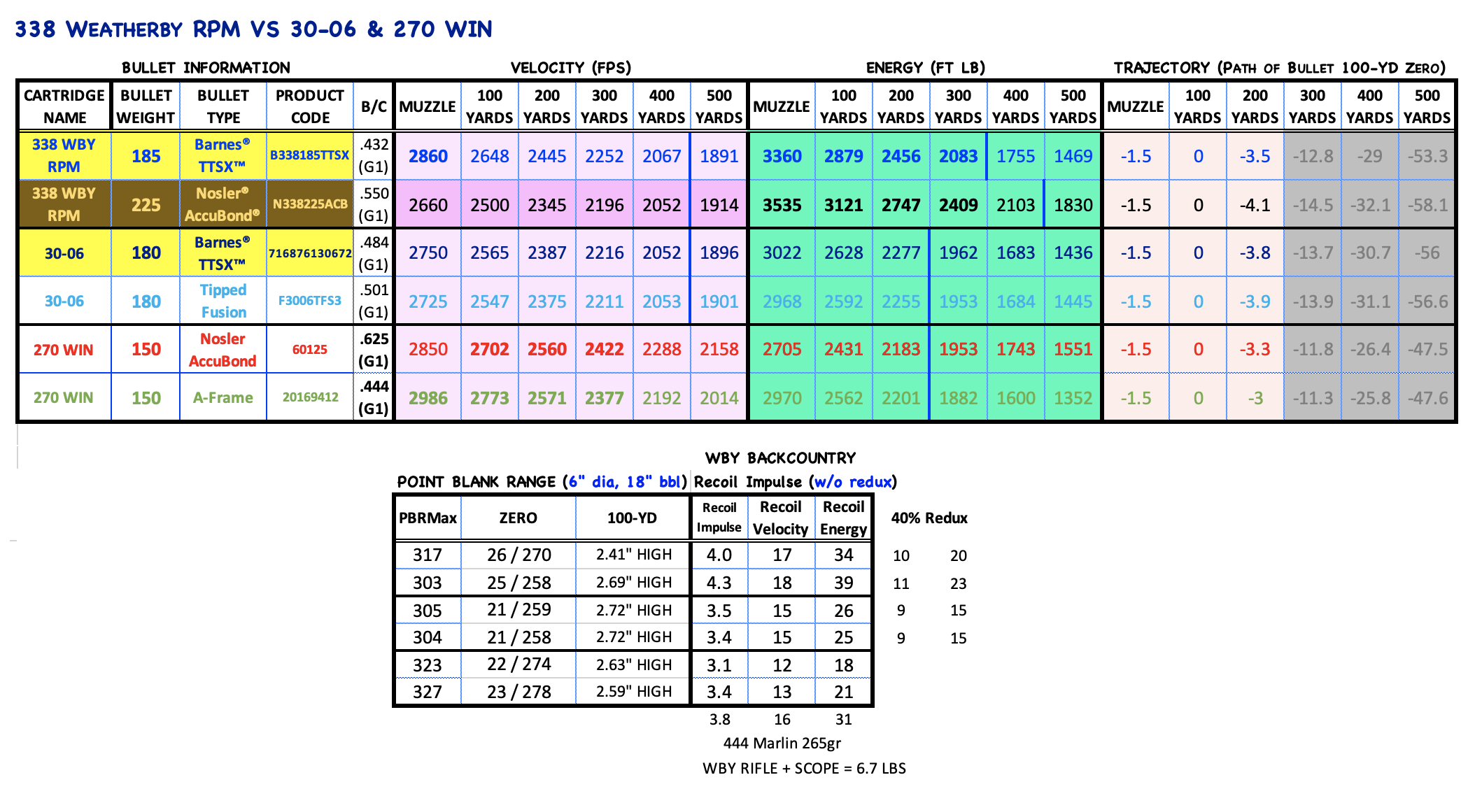

I’m considering a Weatherby Backcountry 2.0 in 338 WBY RPM. Wondering about recoil. 5.4 lb + 1.2 lb for scope + 17oz for silencer, so 7.7 lb. I don’t have (so far as I know) the ability to try it before I buy it, so my closest personal experience is recoil from a 7.5 lb Marlin 444, with which I have no issue.
I’m not particularly concerned about recoil except, of course, that I don’t want to get beaten up by a rifle such that I don’t want to practice with it & won’t be proficient with it (again, my only point of comparison is the 444 Marlin). And I certainly don’t want to plunk down much $$$ only to be unpleasantly surprised.
I’ve been told silencers reduce felt recoil up to 40%. If true, then I’m def not concerned, but… “Up to”…?
I can calculate felt recoil stats w/o silencer (subject to claims that Peak 44 stock & butt pad reduce felt recoil), but I don’t have personal experience to know if the 40% redux silencer claim is true.
By the way, 338 WBY RPM @ 18" bbl is comparable to 30-06 in velocity (338 185gr TTSX @ 2860fps vs 30-06 180gr TTSX @ 2750fps), but with greater energy & diameter.
So here’s the info I’m looking for: For high caliber/high energy cartridges (if not this particular pkg), can anyone verify or deny the “up to 40%” claim? Subjectively (or objectively if you have data), what do you think is a realistic expectation for felt recoil reduction from a silencer?

The Springfield 30.06 produces an average of 21.4ftlbs recoil with 13 fps recoil velocity
The 7MM PRC produces an average of 25ftlbs recoil with 13.4fps recoil velocity
The 375 H&H produces an average of 38ftlbs recoil with 15.4 fps recoil velocity.
I have never shot a .338 Weatherby RPM but in comparison on paper your chart stats show it produces an average of 31ftlbs of recoil with 16fps recoil velocity.
This cartridge is close to the 375 H&H Magnum in recoil punch. I would definitely shoot the rifle in .338 WBY RPM before purchasing it. I would also consider ammunition cost. The bigger the bullet the more cost. I have seen some magnum bullets going for $9 each - that makes for an expensive day at the range.
