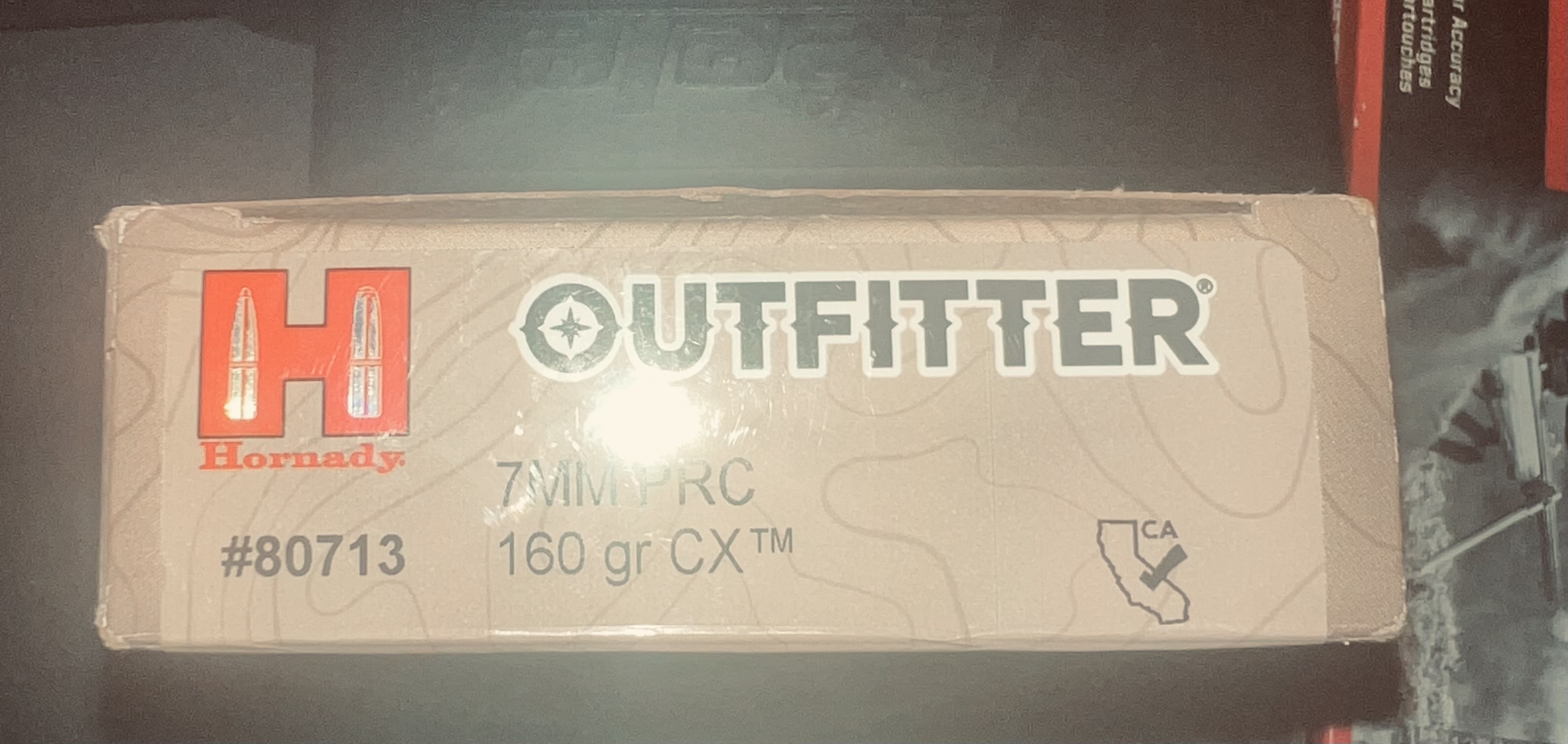

I am a Barnes fanboy for my 300 WM. I will need to find some for the 7PRC and go side by side with the Hornady Outfitter.
