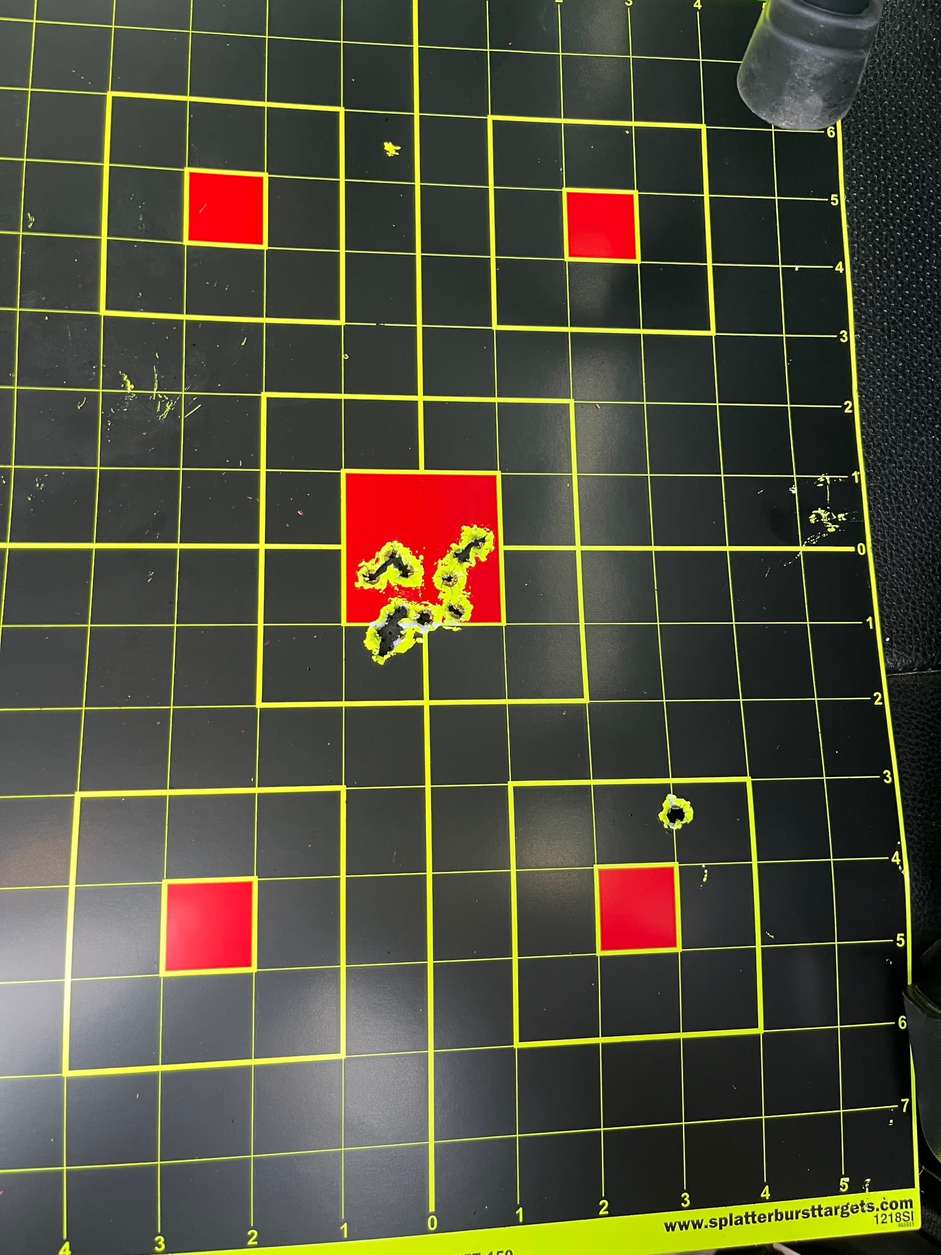

Daniel Defense DDM4 V7 Pro 100 yards. Low right shot was bore site.

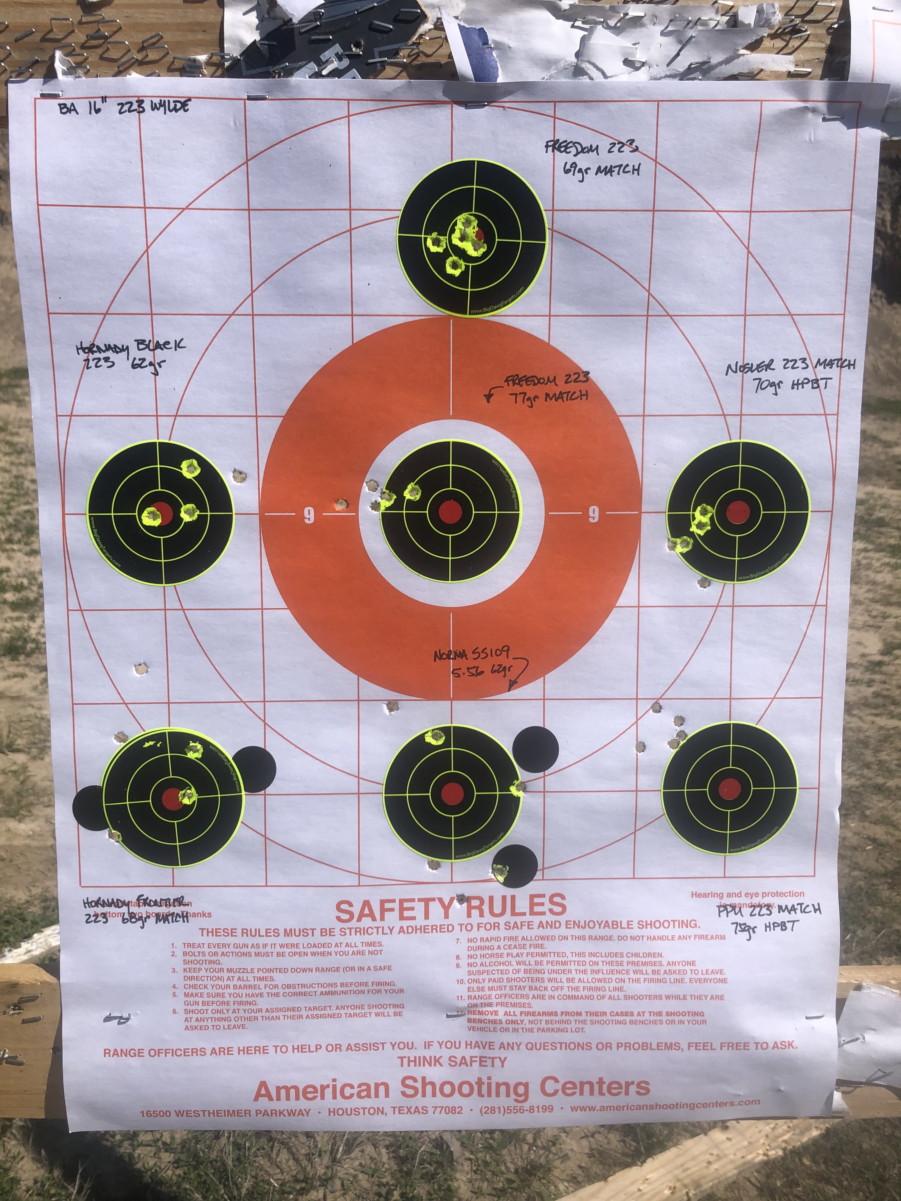

I have AR’s which I have bought and some which I have put together. My last one was built on an Aero precision M4E1 lower & upper. I used a Ballistic Advantage 16” 223 wylde (Hanson) barrel. Below is a photo of how it shot at 100yds with the ammo I had at the time. I used a benchrest front and rear bag with a Primary Arms 1-8x LPVO. The hi-viz targets are 3” diameter.

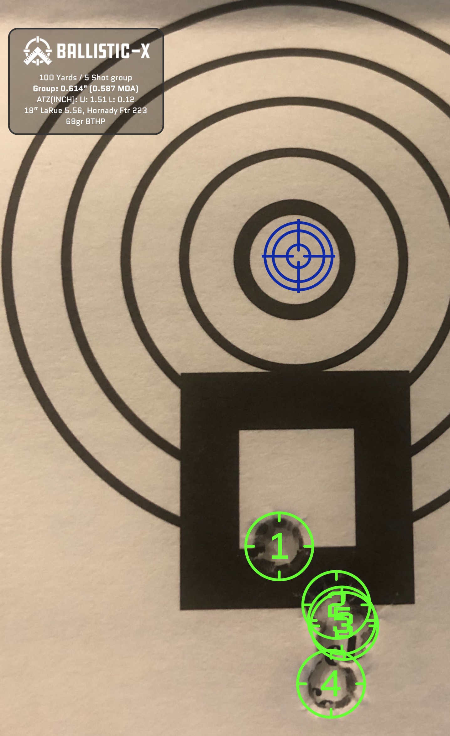

I also bought a LaRue 18” 556 upper which shoots well.
