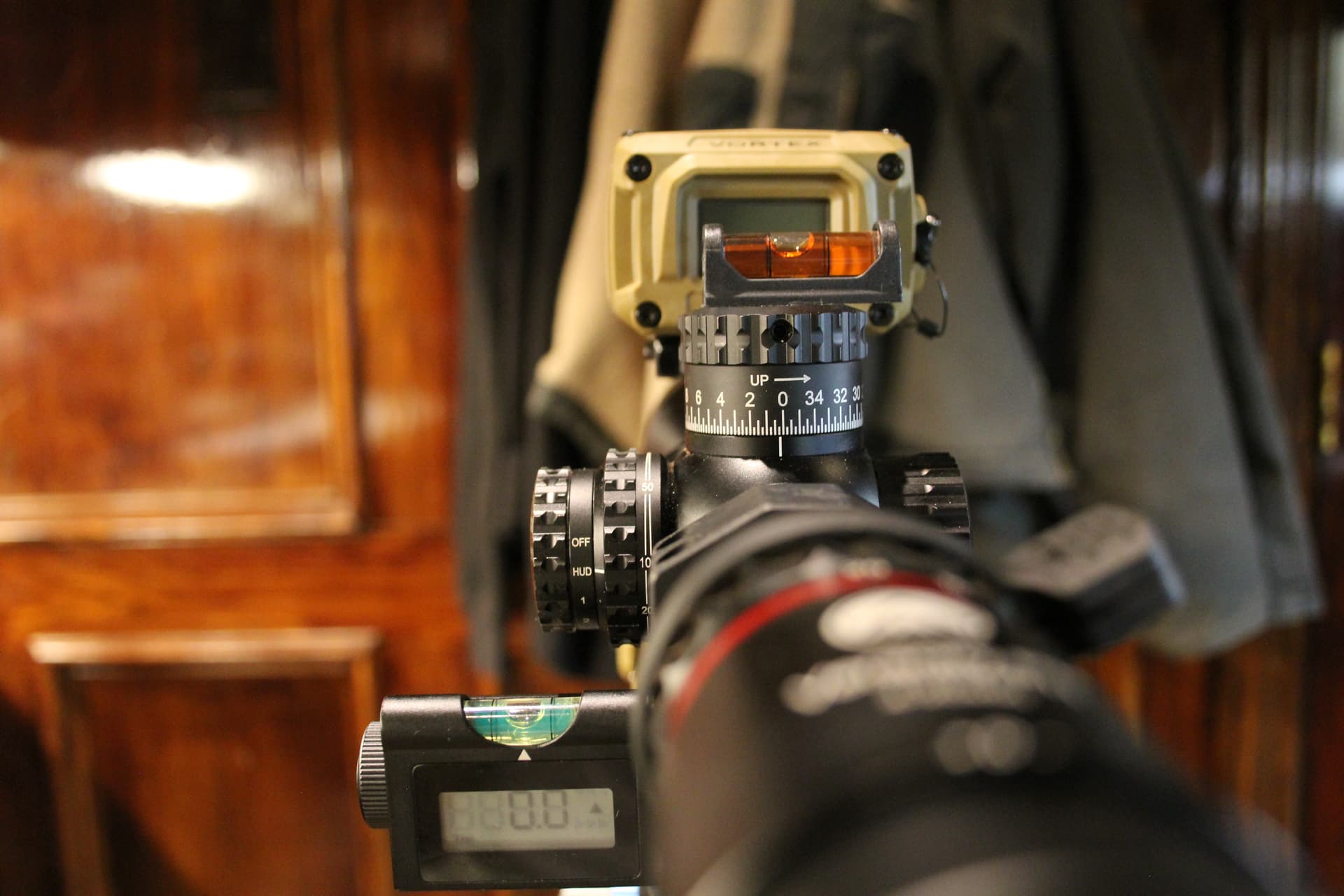

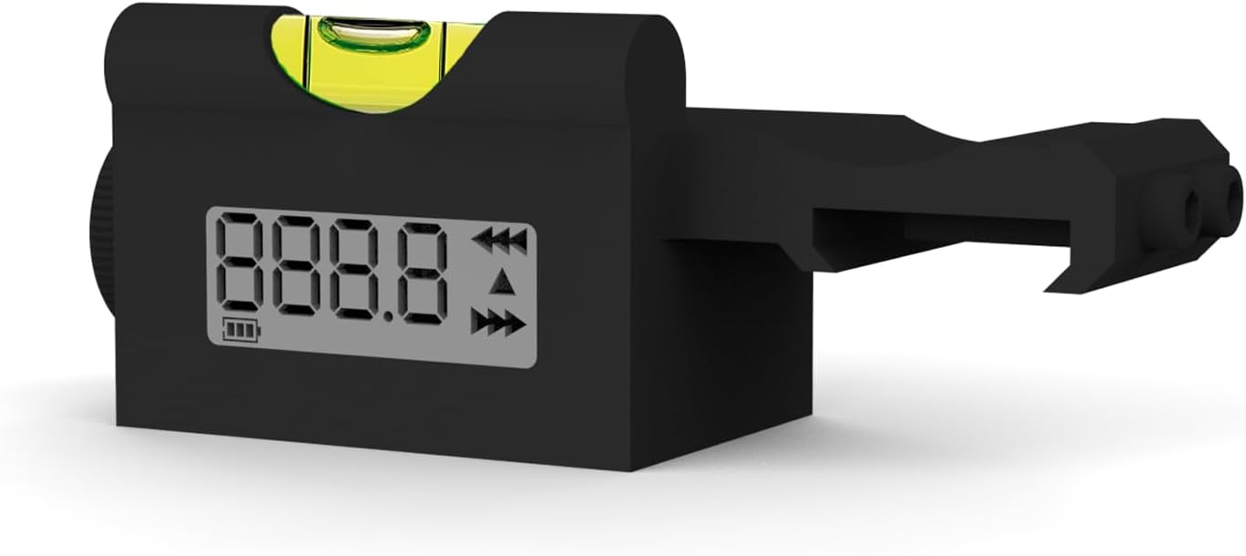

I also use this device to level the rifle. I has a bubble level as well as a digital read out of how many degrees +or- you are out of plumb. Then with the bubble level plumb set a second bubble level on the elevation turret and compare the 2 bubble levels till scope is level.

Cool. What is the brand of that one with the digital readout?

https://a.co/d/f6iLdfD

Yes the MDT LRA is very expensive. When I first discovered the MDT, it was a video on mounting scopes. However the digital I showed above is only $40.00. I believe Jim is using the MDT as a anti cant device on a rifle while shooting or hunting. I believe I have seen it on some of his videos. I am sure it works well for that. I don’t need that as I use Burris Veracity scopes on my hunting rifles. They have a heads up display in the scope and it has a digital anti cant level, so I really don’t have a use for it there. My two Pulsar Thermals a Thermion Duo DXP 50 and Pulsar Thermion 2 XP 50 Pro both have digital anti cant displays on the video screen.

I either put the rifle on a tripod or in a gun vice, and adjust the tripod or vice until the bubble shows the gun is level. This shows the gun is level from a cant perspective. You use a regular bubble level on the barrel or picatinny to level up and down. Now that the rifle is level put the scope on the rifle. Set a bubble level on top of the elevation turret and rotate the scope in the rings until the scope shows level. Then the rifle is level and the scope is level relative to the rifle.
