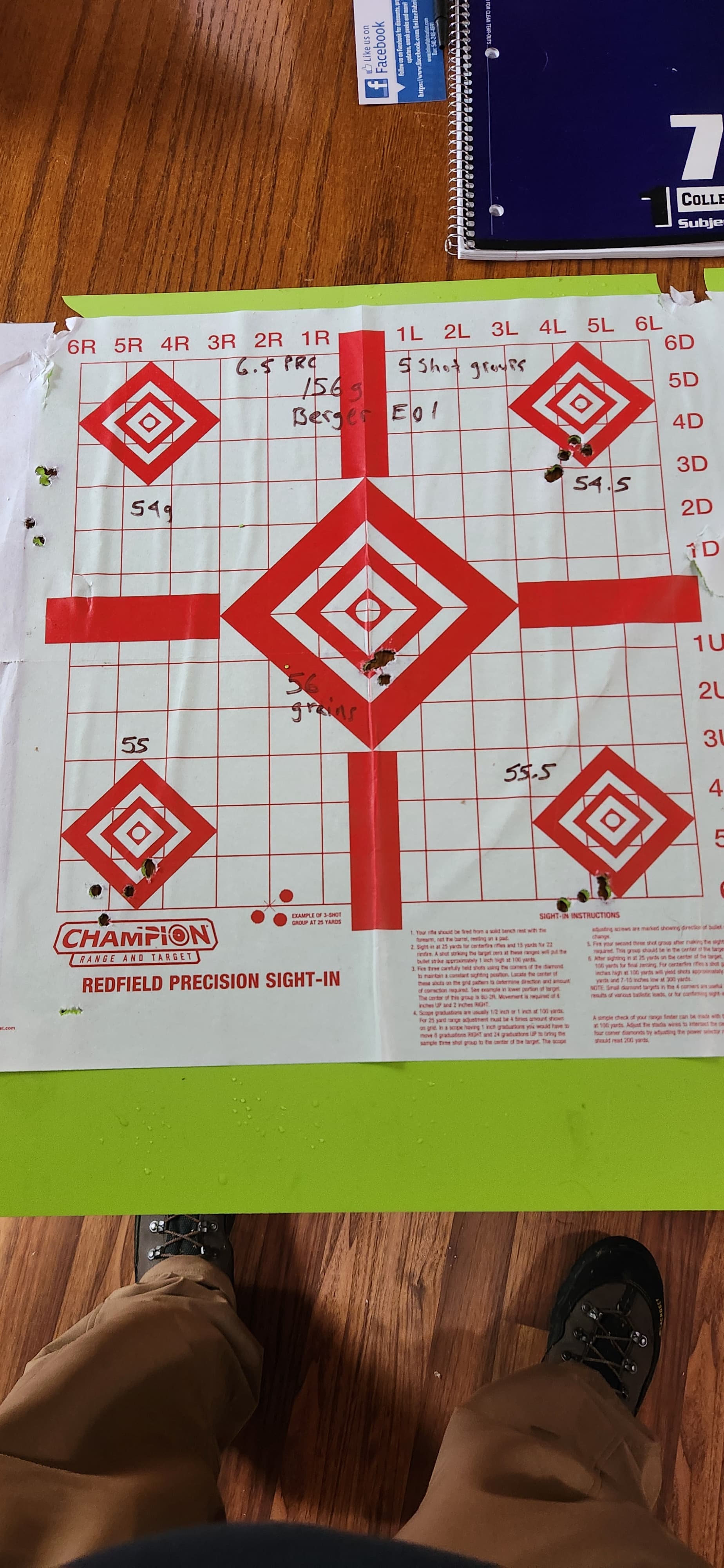

Shot my first set of reloads 6.5prc Berger 156g EOL N565 powder. 5 groups of 5, 54 to 56grains.

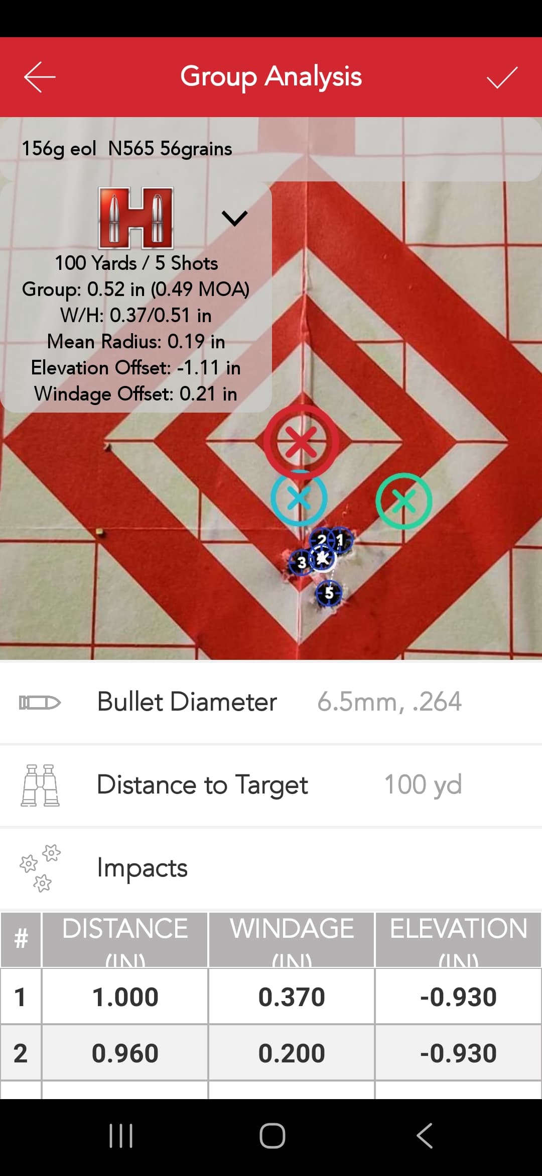

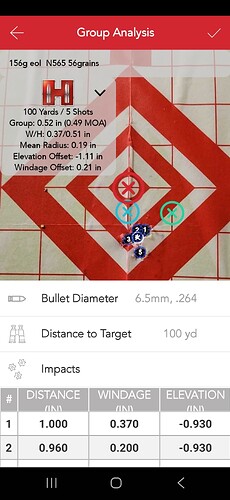

This was the best group 56 grains.
That’ll do! What kind of sd did you get?
Jim this group didnt chrono Athlon is calling me tomorrow to discuss it. Another couple groups were 9.7 sd 23.2 es, and 6.2 sd 18.7 es.

Here is the target from today.

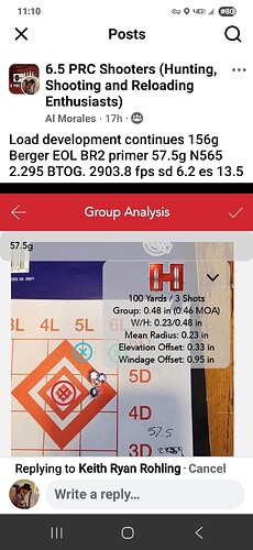

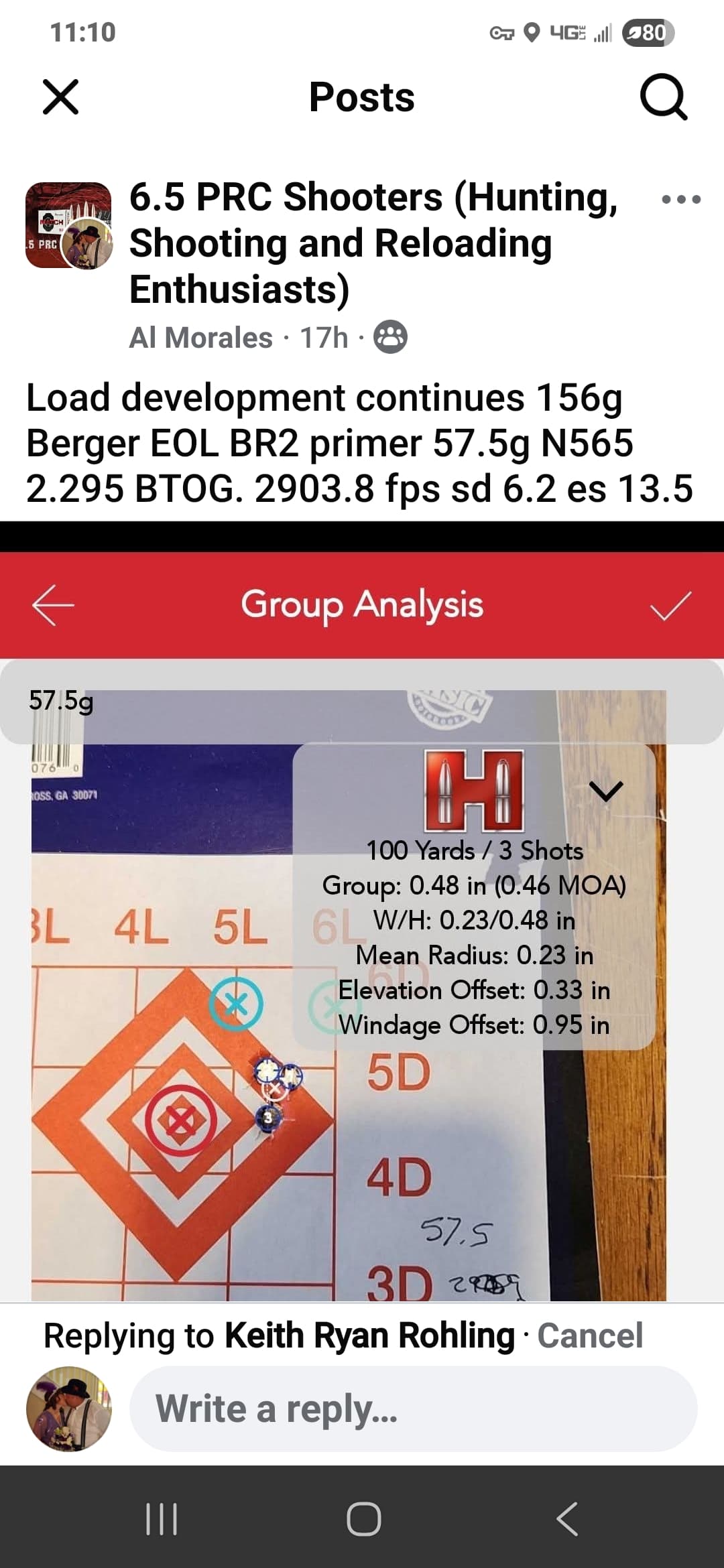

I used a longer btog and did 3 shot groups increasing the powed 1 g. Ive picked the best grouping and next 5 to shot groups
