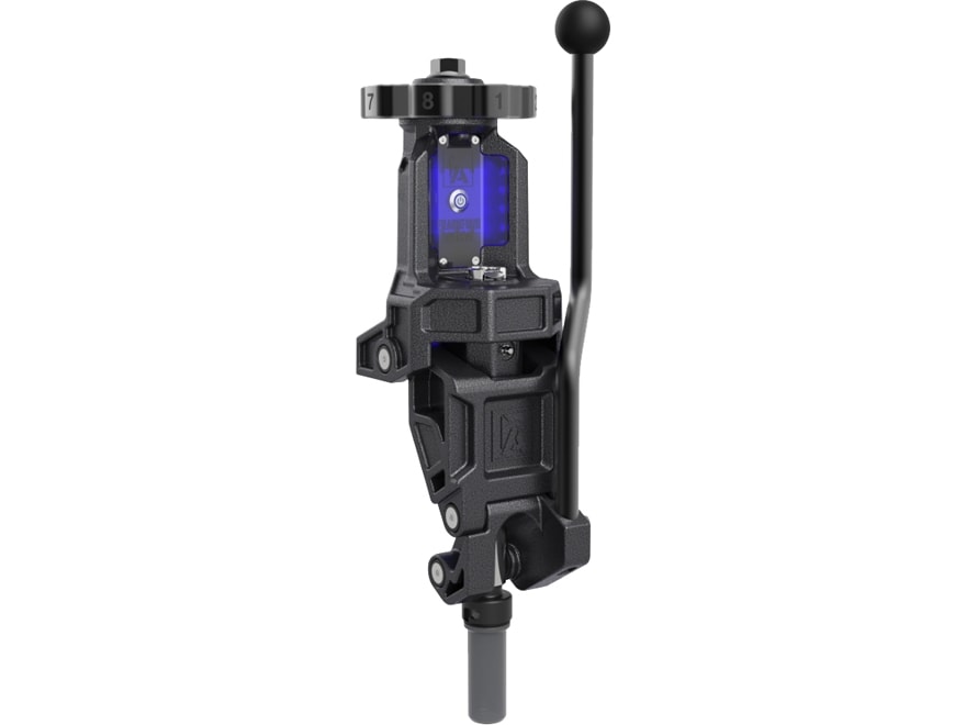

I need a new press. The FA M-Press is available only on backorder. But the F1 is available and I can always find a RCBS Summit. Can also get a FA Precision Single.
Of these, which do y’all like the most and why?

I would avoid FA. Not a terrible press but I found the tolerances to be sloppy and inconsistent. The cam over arm doesn’t have a hard stop like other presses do so even when the seating dies are set and locked in place the overall length can vary quite a bit. Mine usually were within five to ten thousandths of each other which isn’t a huge problem but wasn’t consistent enough for me. Just picked up the Redding T7 and I already love it way more so I would second that recommendation.
I went from the M-Press to the FA Turret press and it’s soooooo nice. I was looking at the Area 419 turret press, but couldn’t justify it until I tried this one. I have zero complaints so far.

I hate my FA M press. As you stated, it’s sloppy and Frankford has replaced it twice. Bought 1 and on my 3 press. Customer service has been great though.
