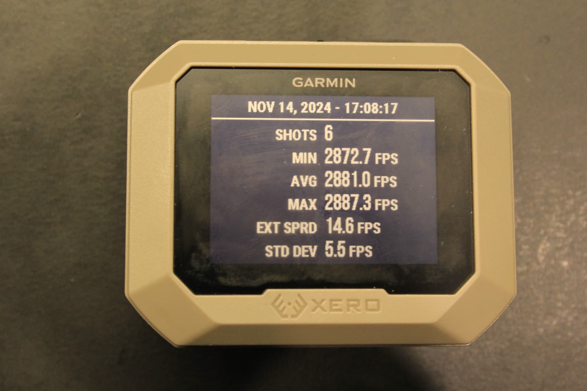

I am very please with the loads. This is the Garmin Chrono for the 6.5prc, along with a couple of 100 yard targets.
