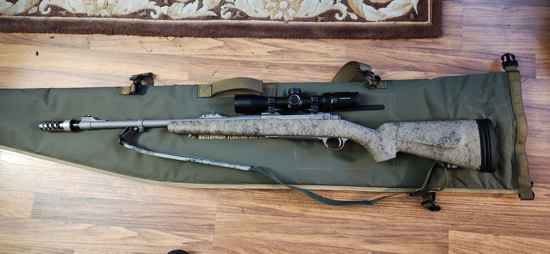

Here is mine in a Bell and Carlson full aluminum bed stock, Vortex Viper HD 2-10 x 42 scope, Backfire Backstop butt pad, Area419 Sidewinder brake.
Looks like a “Charge me and Die Gun!” That if the bullet doesn’t hit them the muzzle blast noise will!
That’s a nice looking rig! I need to upgrade the recoil pad on mine. Haven’t looked to see if there is a backstop pad available for the hogue stock yet
At least if i miss it will scare the heck out me and whatevers in the area.
