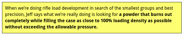

Its very long, very pedantic, and mostly filler. This is the relevant information from someone with more experience and who’s better at organizing their thoughts:
Source: Rifle Load Development: How To Find The Best Powder & Load For Accuracy - PrecisionRifleBlog.com
The way to do that is to use software such as Quickload or GRT to figure out what powder matches that criteria best.
