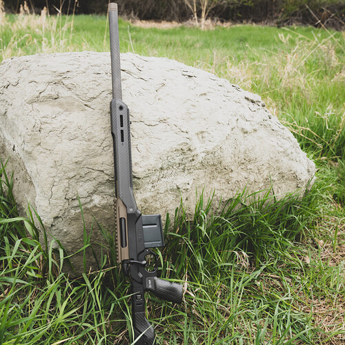

My Current thinking for the .280 AI and 7mm PRC would be built around the
Terminus Kratos Lite action, which is a 3-lug 60-degree bolt throw.
Probably with a 22” Carbon 6 barrel.
I’m open to suggestions on the barrel - as long as it’s single-point cut - I would be okay with a stainless fluted barrel in something like a Sendero Lite or other profile that still supports a muzzle break or suppressor. I’m shooting for around 5.5 - 6 pounds without scope -so weight matters.
I also need a good muzzle break - preferably self-timed.
OR:
The Tikka Barreled action from Oregon Mountain Rifle (along with a long list of options - everything but the suppressor), which brings it up to an eye-watering $2,922.00
The Manner’s MCS-PH-A or MSC-PH, or the MDT CRBN Stock. I’m open to suggestions here as well. I don’t want a chassis - I do want a “pistol grip”. Other than that, I just don’t have enough experience to know what’s useful and of good enough quality.
I’m debating if I actually need an adjustable - having never used one (well, the Scout has butt pad spacers), I’d rather avoid the weight and complexity if I can.
Probably Hawkins Hunter bottom metal on the Manners or MDT bottom metal on the CRBN
A Triggertech Special Trigger.
If I opt for the 6.8 Western, then I’ll use the Terminus Apollo Lite/Ti (which is weirdly named since it’s all stainless as near as I can tell) - everything else would be the same.
