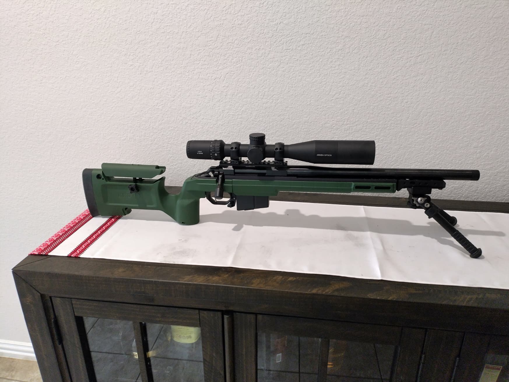

Just got the barrel in for a short-ish barreled rifle optimized for shooting at around 300 yards. Chambered in .338 Federal, with a 16.5" barrel, it’ll sling 185gr TTSX at around 2500 fps (we’re gaining about 200fps over a similarly sized gun in .308 shooting the same weight projectile at the expense of more drag on the bullet).
I may eventually get another similar barrel chambered in .338 RCM for even more short range power if I can find the brass and dies for it.

Hunting and target shooting out to 3-400 yards. I concluded a while back that something optimized to shoot a larger bullet at acceptable speeds would be ideal for the ranges that people actually hunt at (I’ll use your videos about shooting out to 600yd as evidence here). This thing has a lot of things going for it:
  • Compact, with a 16" barrel you can hang a suppressor off the end and it’ll still be a handy gun
  • Lightweight - as configured in the photo its around 10lbs, we can get that down quite a bit by switching to a lightweight stock like the new Woox Superleggera
  • Good enough energy and ballistics to reliably down deer (and probably elk, if we’re using 1500 ft-lbs as a yardstick for what is and isn’t an “elk gun”) at reasonable ranges
  • Low recoil - it doesn’t really kick any harder than an average .308 or 6.5 cm
  • Good thermal properties (especially compared to your average hunting rifle) - I shot 50 rounds with no breaks today and the groups just started opening up when I got done
The last point is that its a blast to shoot in addition to being practical, so I can actually go shoot steel and stuff for fun and get better at shooting a hunting gun in the process instead of taking it out once or twice a year.

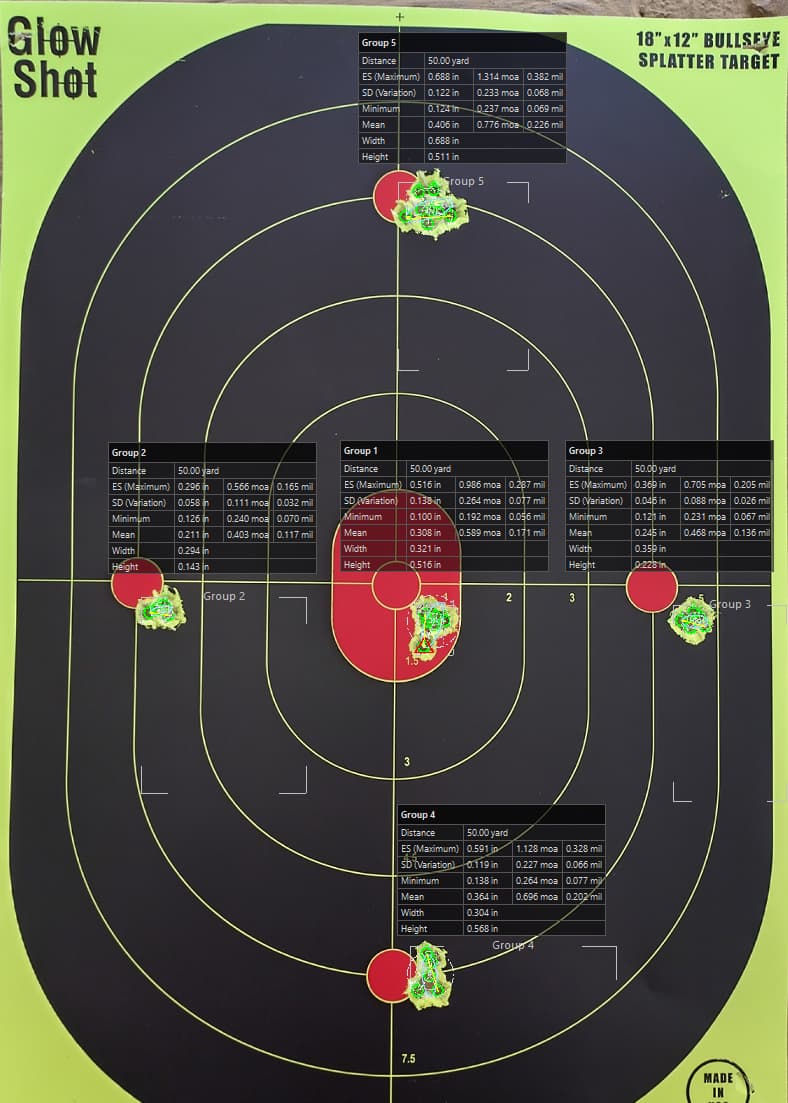

Here’s some of the first groups out of the rifle at 50 yds because the whole damn range was flooded today:

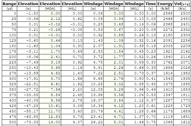

And ballistics out to 500 (verified that this was achievable via chrono today):
Do you know the minimum needed impact velocity for that bullet? Most TTSX’s require 2000 feet per second and you’re dropping below that around 250 to 275 yards. But every bullet is a little different than they make. They’re pretty good about answering that question if you contact them.
1400 FPS I believe, I will email them to verify.
Bear in mind that the lighter .338’s are designed for things like 8.6blk.
Barnes got back to me - 1800fps for 160gr and 185gr .338 ttsx projectiles; this does match my intended use case for <400 yds, though I might take a look at some accubonds later.
