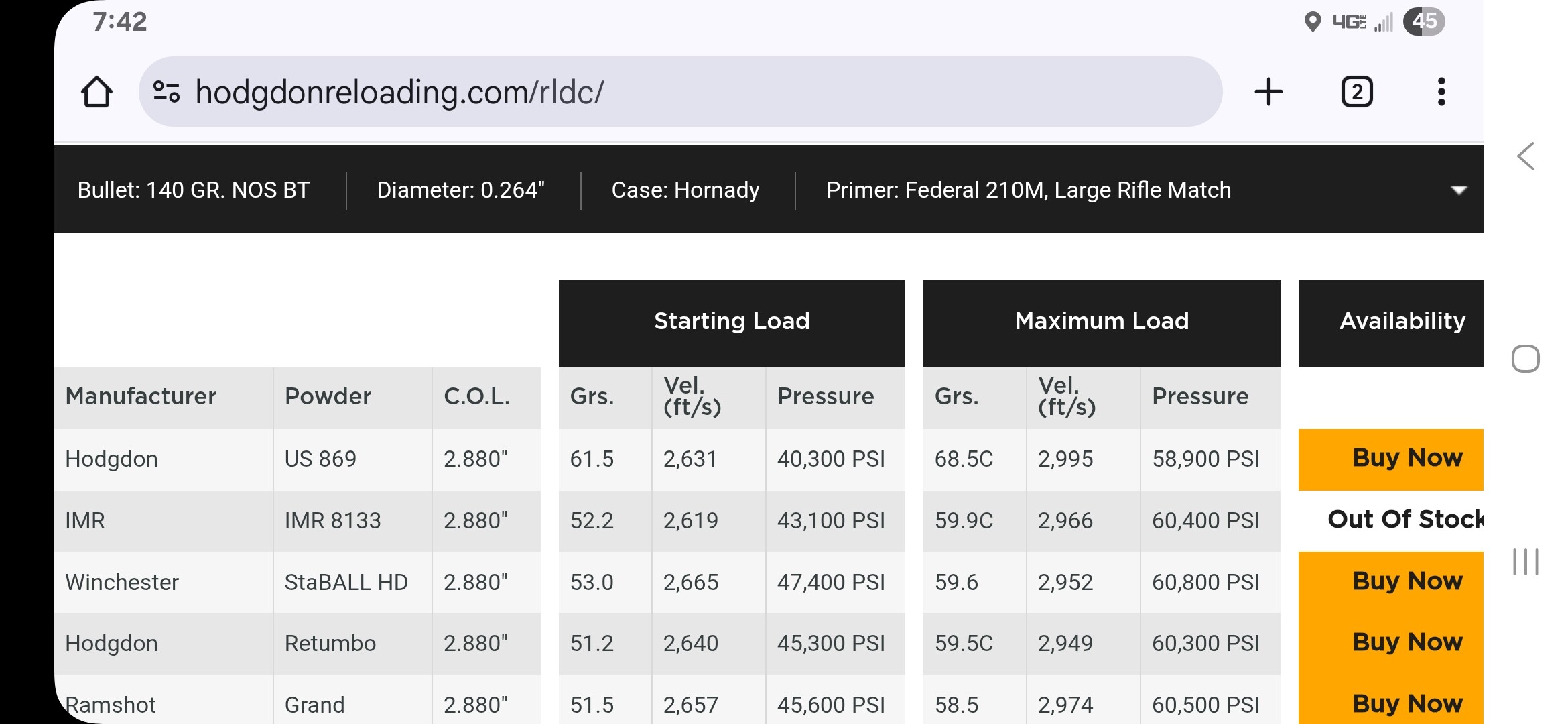

Nosler’s load data site does not list a load with that powder for that particular bullet. However, the load data for all of the 140 and 142 grain bullets are the same. If you look at Hodgdon’s website, they do list a load with the 140 grain ballistic tip and staball HD. So if you believe like nosler, that should work for the bullet you’re looking at. Of course recommendations are always to start low and work up
Perfect thanks so much.
