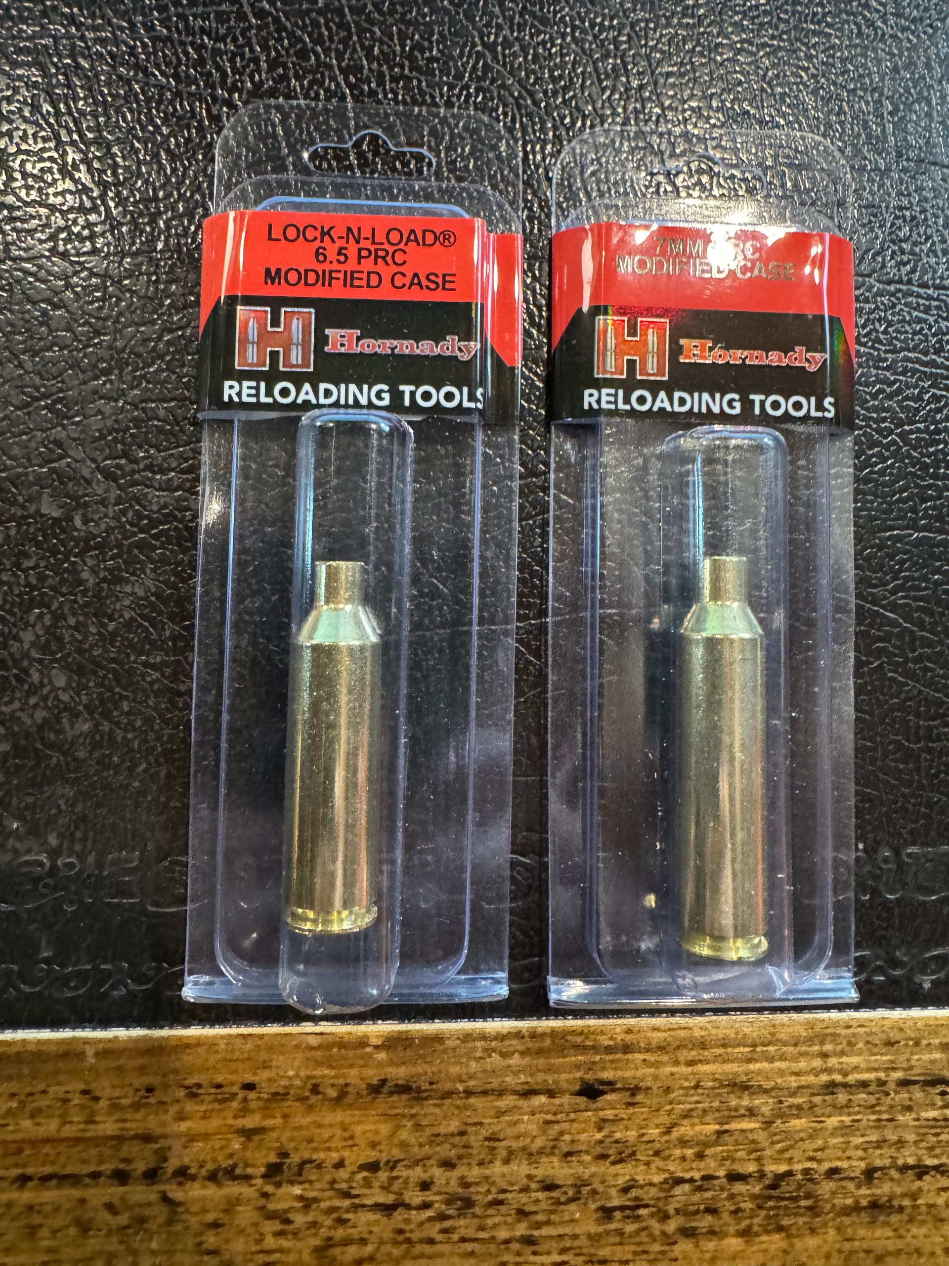

So I went thru Jim’s Reloading 101. Well done, made me remember things I had forgotten. I went thru Jim’s recommended equipment, and purchased everything on it verbatim. Skipped the annealing machine for now. I did find the Hornady Lock and Load Headspace Comparator Kit, and Bullet Comparator kit. I also saw these Modified case in 6.5prc and 7prc (See Photo) i assume these are used to set up the dies as a guide. They are from Hornady. I have 200 rounds of 6.5prc and 7prc. They are mostly Hornady but do have some Berger and Federal Terminal Ascent. Guess that will get me started. Thanks Jim!

The modified cases are used with a Hornady OAL tool so you can measure headspace of the chamber and compare that to the cartridge headspace.
You get this tool Amazon.com and screw on one of those modified cases that you buy for your cartridge. That goes in the rifle through the action to measure the chamber depth. Then you’ll know how far out you can seat a bullet in the case before the bullet’s widest part contacts the rifling in the barrel.
