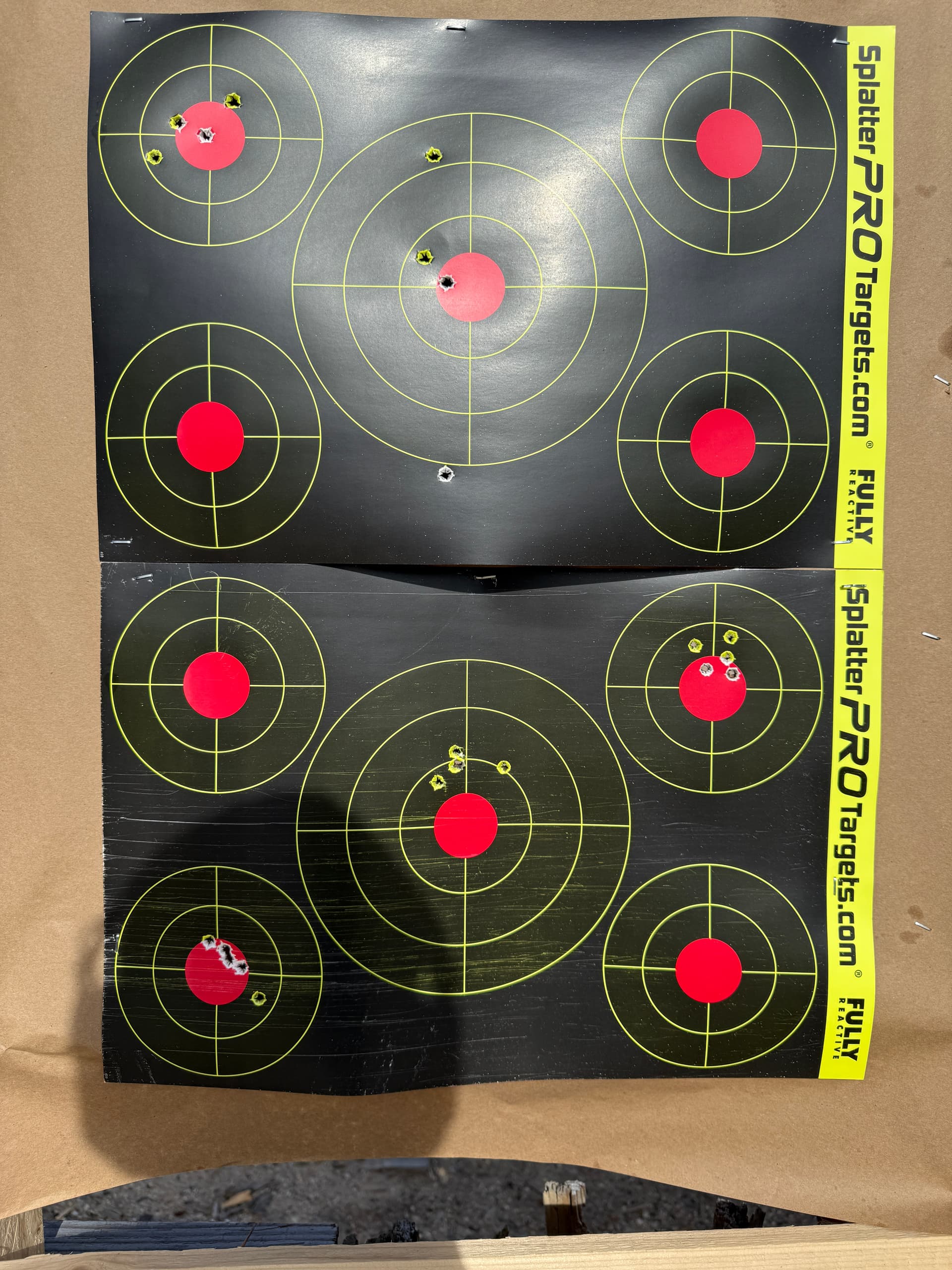

Hey So So shot It today Got It on paper and sited and zeroed this was my first time shooting a long rifle and It was a gas…. This was Paper Hornady Match 140
The upper big target was getting on paper Cold barrel first shots.
The right 4” Lower left was Dialing in Zero
The lower left was agter setting zero and velocity in teh Veracity PH
The was the full set up string with resting to cool a It the barrel was warm for that last bit and the flyer was bad trigger finger I felt It and my Coach said It as I said It at the same time
The large lower was another Cartridge while doing velocity tests on It SBR Controlled chaos
Fun day thanks everyone for your help and guidance on this build
I was plinking 3” targets all afternoon at 200
