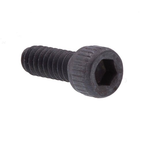

Well, I stuck my first case already…and yes I did use lube, lol. Haven’t even gotten around to seating a bullet yet. Ordered the RCBS stuck case removal tool as I assume this won’t be my first.
Franklin’s M-press shell holder retention plate got all bent up, so I had to remove it, pound it flat, and replace it…the rear center screw stripped some of the threading out of the hole, but I seem to have gotten it back into place okay.
Basically, this same thing happened to me, but I didn’t go the extra step to drill and tap larger/longer holes:
(well, I can’t post the link I guess? there’s a post on sniper’s hide…google " Frankford Arsenal M-Press - Stuck Case Bends Shellholder Retaining Plate. How To Fix & Correct.")

I had the exact same problem just a few days ago. Lost a few cases before I realized what actually happened. You don’t need to worry about drilling larger holes but I recommend replacing the screws it came with. I’ve had several issues with the factory screws that come in the press especially the ones in the die block loosening after a couple presses. For the plate on the bottom I swapped to black oxide coated steel #6-32 3/8in screws from home depot after looking at the reviews from FA’s website. So far they have held strong and are allen key tops which makes them easier to install. In the die block I’ve swapped to stainless steel screws. Apparently its a common issue for the screws that come in the press to strip and come loose so I definitely recommend replacing them with higher quality ones. I’ll leave you the links to the ones that I bought to make it easier. Both are pretty cheap so it should be an easy swap. You can check in store for any hardware stores near you and see if they have similar ones in stock but mine didn’t have them in store so I had to order them online.
https://www.amazon.com/dp/B00IAVL9S8?psc=1&ref=ppx_yo2ov_dt_b_product_details
@cjparis971 Thank you very much, I will snag those cap screws and replace the factory ones. I am not sure what the set screws are for…you replaced the screws in the quick change collets with those?

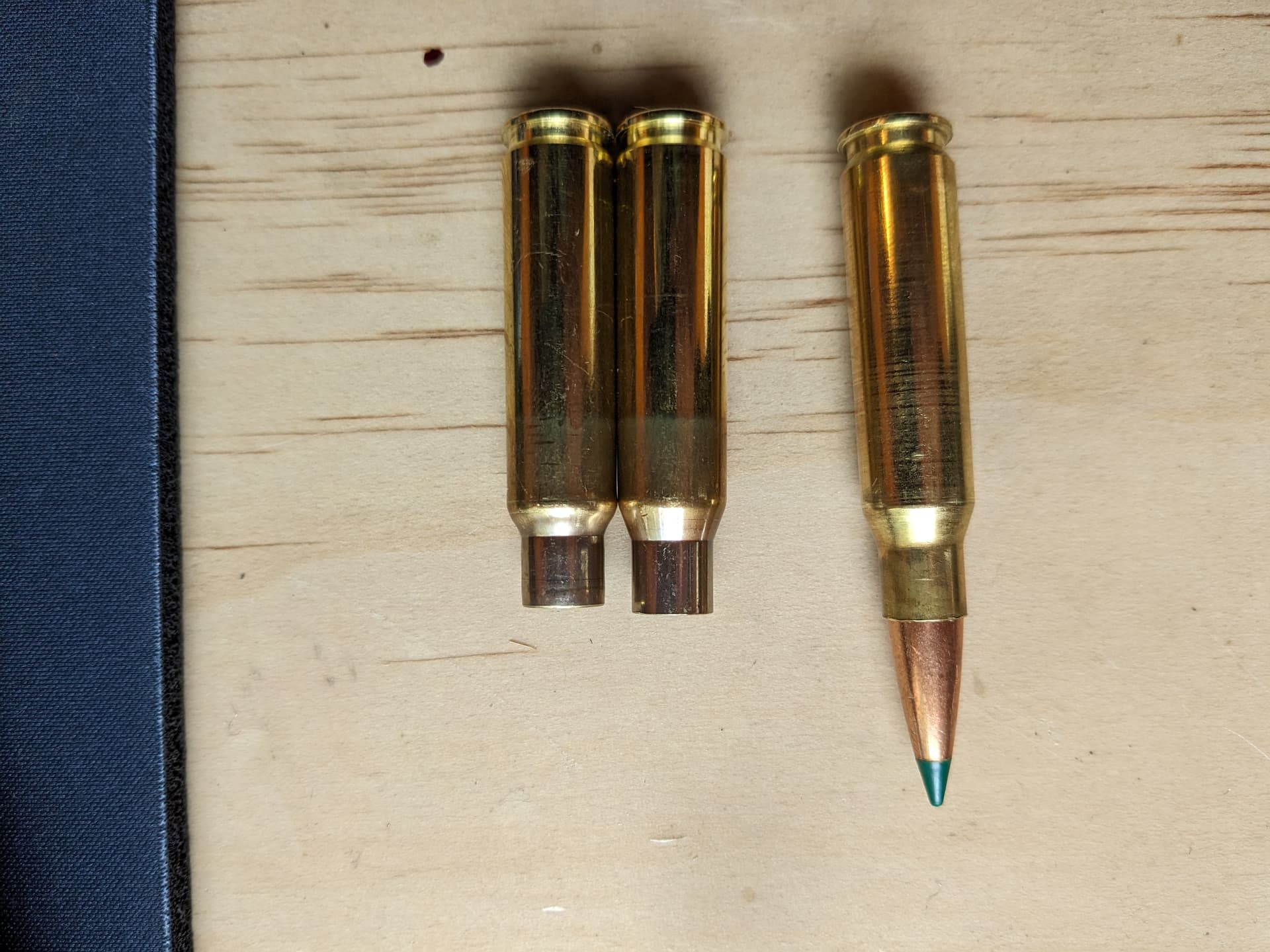

I loaded up 25 rounds of fresh Lapua brass with 168gr Sierra TMK bullets, starting with the low recommended load of Varget and working up in .5 grain increments after 5 rounds each. I got into a good groove, figured out the Hornady powder loader (which seems very convenient), measured each round within .001" of the recommended COAL, and then took a dinner break.
After dinner, I went back and figured I would test chamber my loads and they would not chamber. The only thing I can figure out after much testing and measuring is that the neck OD is too big for the chamber on my rifle. Unloaded new Lapua brass will chamber, but the loaded stuff will not. Unloaded neck DIA of .335" goes, and loaded with ~.343" does not. I loaded a few at different COALs (including even shorter than recommended) and I have the same issue. The bolt fully engages but will not turn over past about 1/8 - 1/4 of the throw. Headspace is all well below the SAAMI maximum of 1.640. I measured some factory loads and they are closer to the .335" neck diameter and chamber just fine.
I did some research online and it seems like Lapua brass is exceptionally thick, and sometimes needs to be turned down to fit tighter chambers. I guess that is my problem…but if anyone has any other ideas I am open to suggestions. I would have tried re-sizing some fresh brass but…my case is still stuck LOL.
Is it possible I set up my seating die incorrectly? .008" DIA of growth seems excessive when .003" or so neck tension seems to be what most folks aim for. I did measure the lengths of some of the brass that I seated in (and pulled the bullet) and it was 1.981" (vs a pretty consistent length of 2.005" on the fresh brass). I don’t know how that could be me though, since the COAL is good to go.
Yes the set screws are for replacing the ones that come in the blocks that hold the dies in the press. I’m not sure what they made them out of but the ones that come with the blocks always seem to strip for me when I tighten them down and then come loose after a few cases.
I figured out what I was doing wrong. I had my seating die set way too low and it was smooshing the necks down. I backed it off and seated a bullet in a new piece of brass and voila! we chambered!
Smooshed case vs fresh vs properly seated without smooshing.
