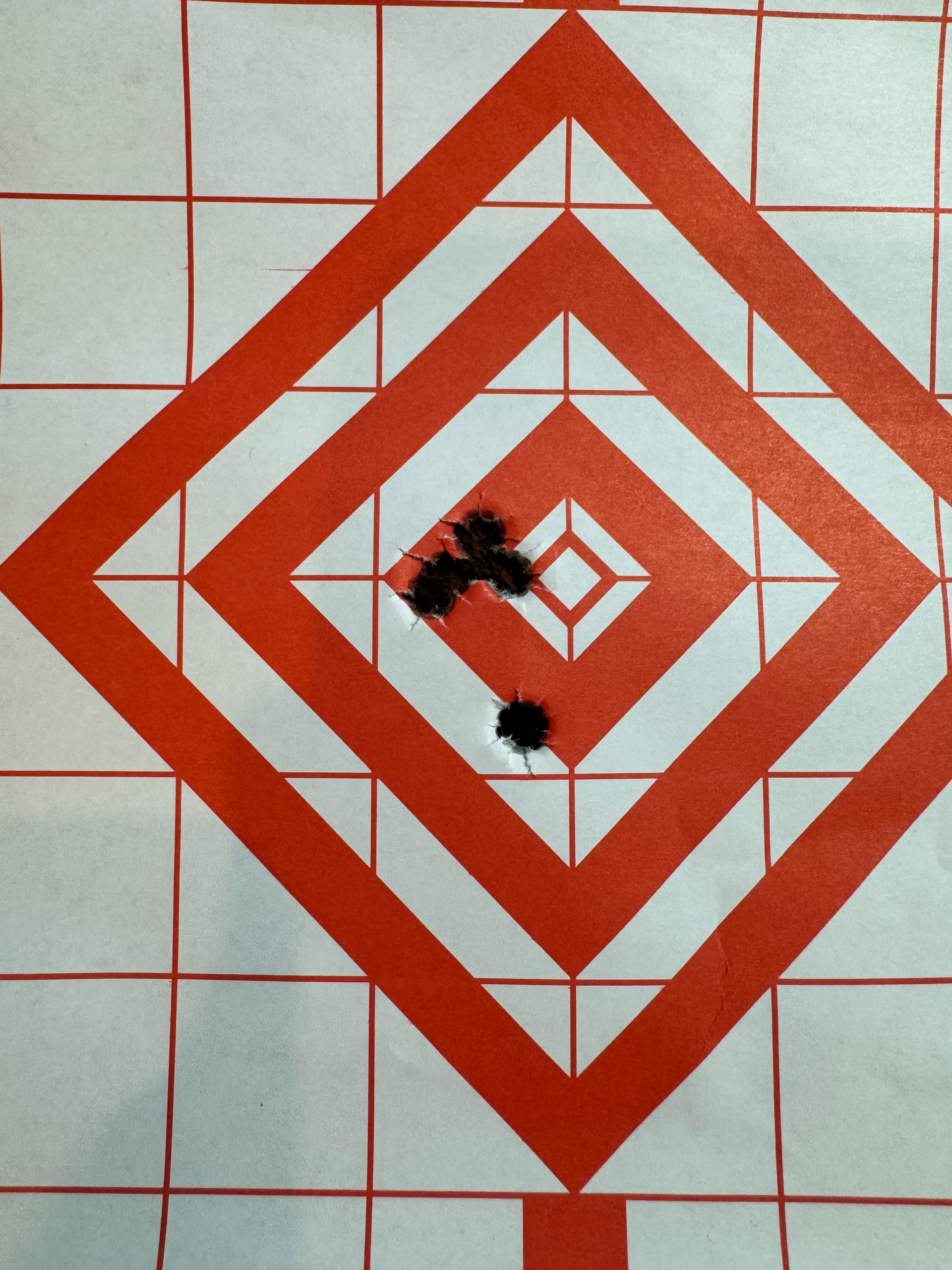

I’d recommend trying a few different seating depths. Jim has a video about it called “this gun can’t miss…” about his mountain reaper where he talks about loading different depths. I’ve also attached an article from Berger about it. I did this for my 6.5CM and found .09 jump worked best for me. After testing and seeing what jump was best I loaded some more and shot yesterday with 3 slightly different power charges to make sure I wasn’t close to a better node and had 2, 5 shot groups at .756 and one 5 shot group at .445 with the hottest load. SD on the small group was 5.1. Definitely a big difference from where it was shooting before. A few extra steps to develop a load but definitely worth it. Can’t wait to load more with that charge and stretch it out to distance!

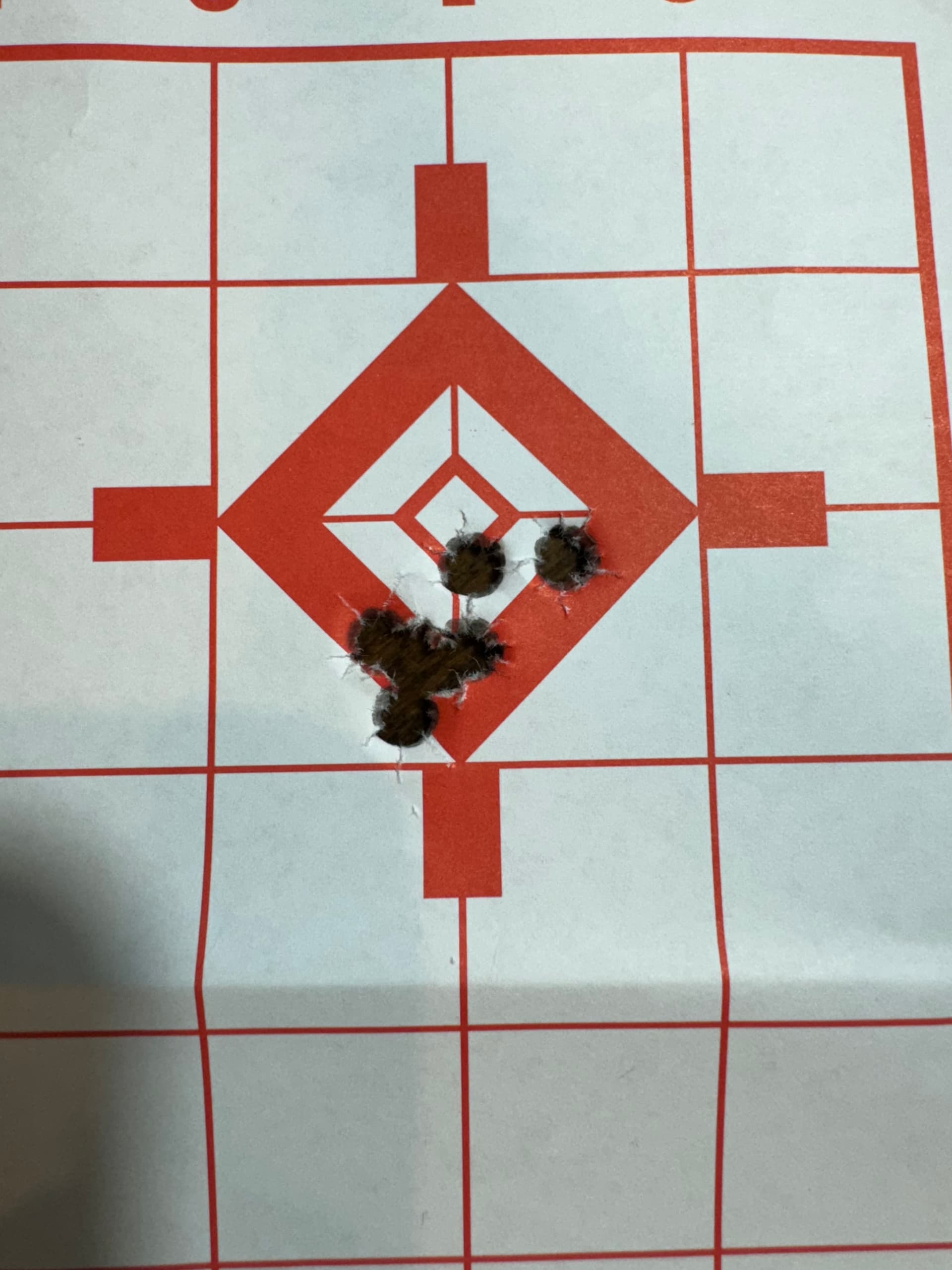

So I think I came up with a decent starting load. From the back of the cartridge to the Ogive was 2.67 to the lands. I backed off to 2.63 seating the bullets. I loaded with 67.1gr of H1000.
Average bullet speed was 2818 FPS.
Yesterday was my 71st birthday Maybe the group would be tighter if I wasn’t so old
