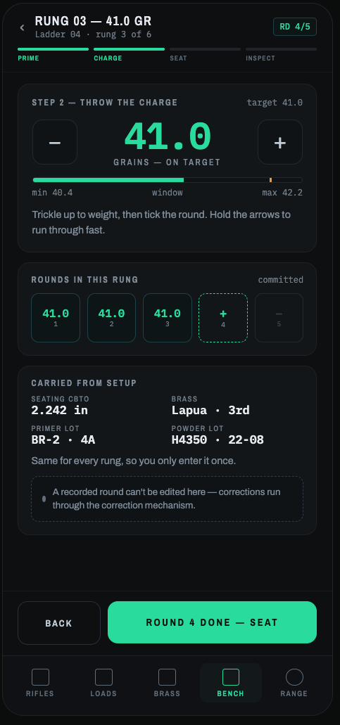

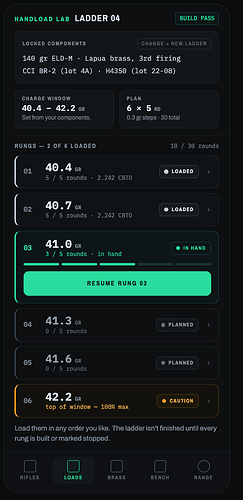

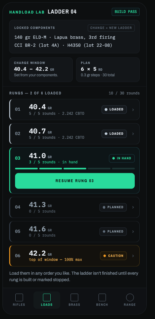

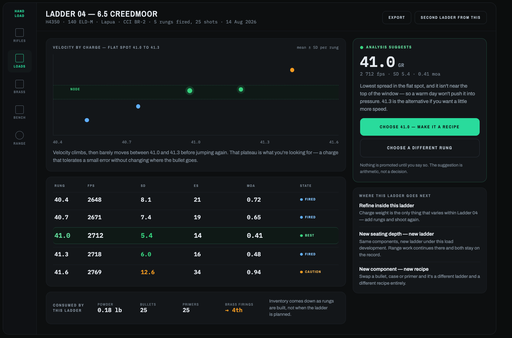

thought id put up a screen shot of ladder dev. still plugging away note this is for look and feel no data is in the app so don’t look at actual charge weights as anything its just dummy
here is a look at what I’m thinking for ladder dev on a tablet or desktop
That looks great! Very helpful
