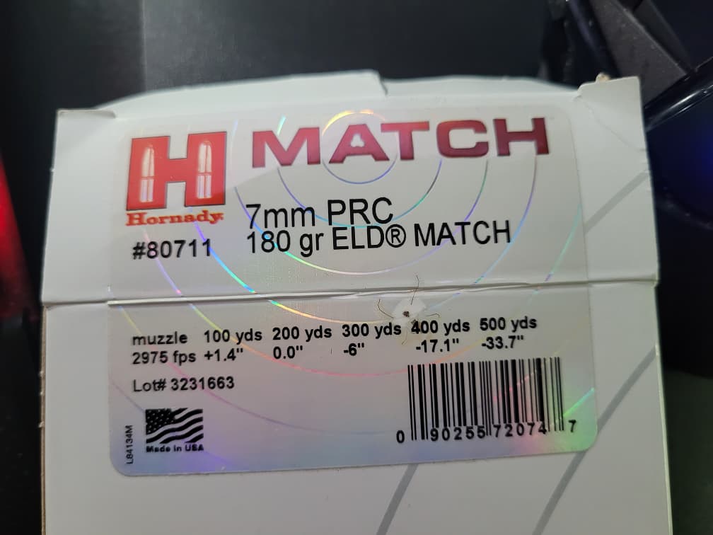

Using Factory batch #80711 LOT# 3231663 - Hornady Match 7 mm PRC 180gr ELD bullets - I experienced a primer blowout indicating an overpressure situation. No other indications of overpressure were observed. Only 1 out of 40 rounds I shot did this but it was a little surprising.

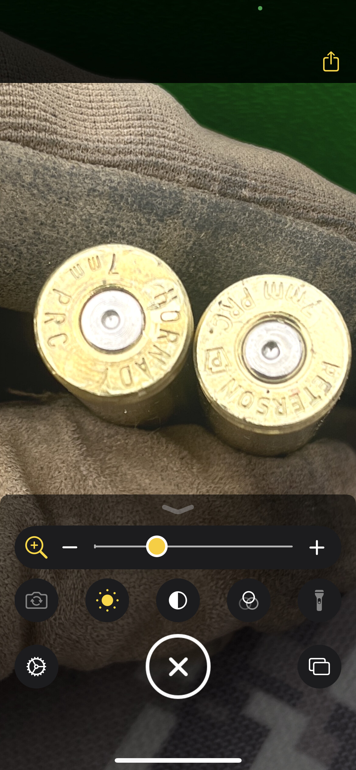

I have noticed flattened primers and ejector marks on hornady 7 prc brass compared to Peterson brass when all things else are equal. Not a large sample size, but it was noticeable.

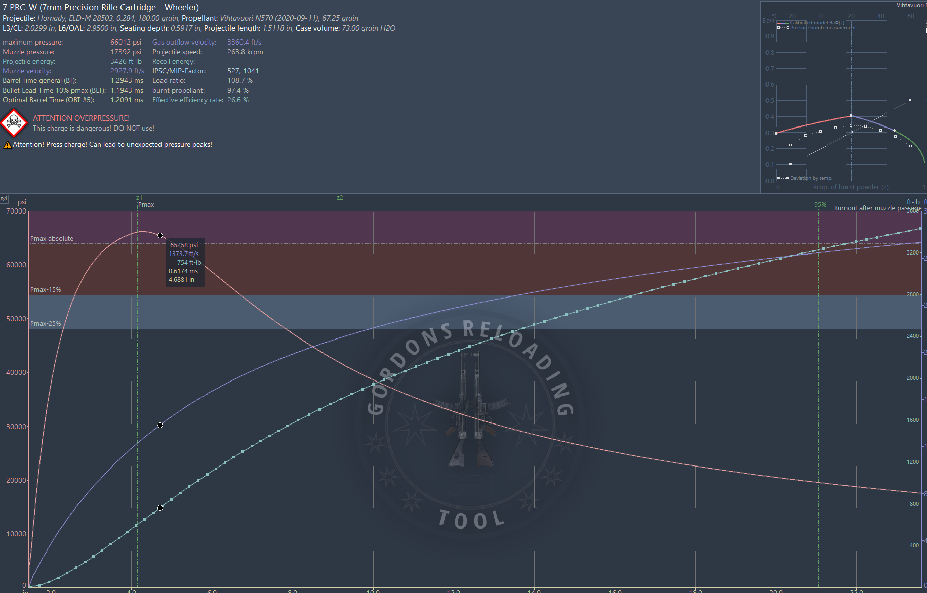

I’m pretty sure Hornady is really pushing their factory loads to the limit for marketing. Trying to replicate the specs of that ammo in GRT led to this (using N570), its not surprising that people would get overpressure issues especially in warm weather:

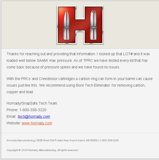

Here is the response from Hornady.
I was totally surprised by their response.
This rifle is brand new – and I have only shot 40 rounds of Match through it – and the blowout of the primer occurred around the 10th to 12th shot.
So, what Hornady is telling me, is their Match ammo fouled my barrel enough after only so few of shots that it created a carbon ring which caused an overpressure to blow out the primer - breaking it into two pieces.

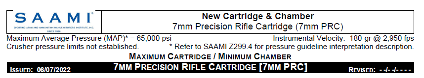

Hornady wrote “ I looked up that LOT# and it was loaded well below SAAMI max pressure.”
I call BS - according to Hornady’s own load data, to achieve advertised Muzzle Velocity of 2975fps the MATCH load would have to exceed their published maximum load data for the 180 gr. ELD – i.e. 67.0 gr. of RL26 or 69.0 gr. of RL25 = 2950fps.
Hornady’s answer seems a little ambivalent.

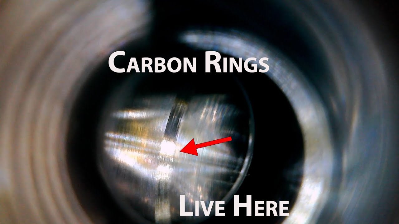

One thing not being talked about with 7 prc is how fast a carbon ring can form. It can be in as few as 40 shots, which is kinda crazy. It really requires a lot of cleaning.
I know in some recent post the idea of a new video regarding cleaning came up and you said you’d be interested in pursuing that. If and when you do, please be sure if you can to show exactly what a carbon ring looks like, as well as how you prefer to attack it.
I keep hearing about it and reading about it but never have seen anything definitive in terms of pictures or video.

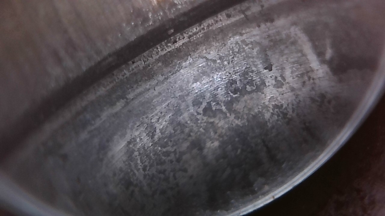

That is exactly what I have - I have both the Teslong flexible and folding Borescopes.
As this picture shows my rifle is pretty dirty after 40 shots of Hornady Match but there isn’t a carbon ring formed yet.
I will clean it and it will be shiny again.

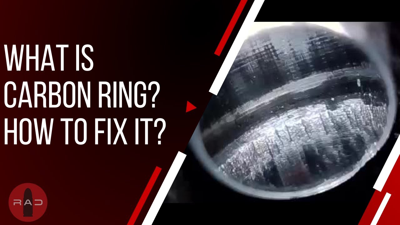

Here is a couple YouTube links that provide some insight on Carbon Rings.
