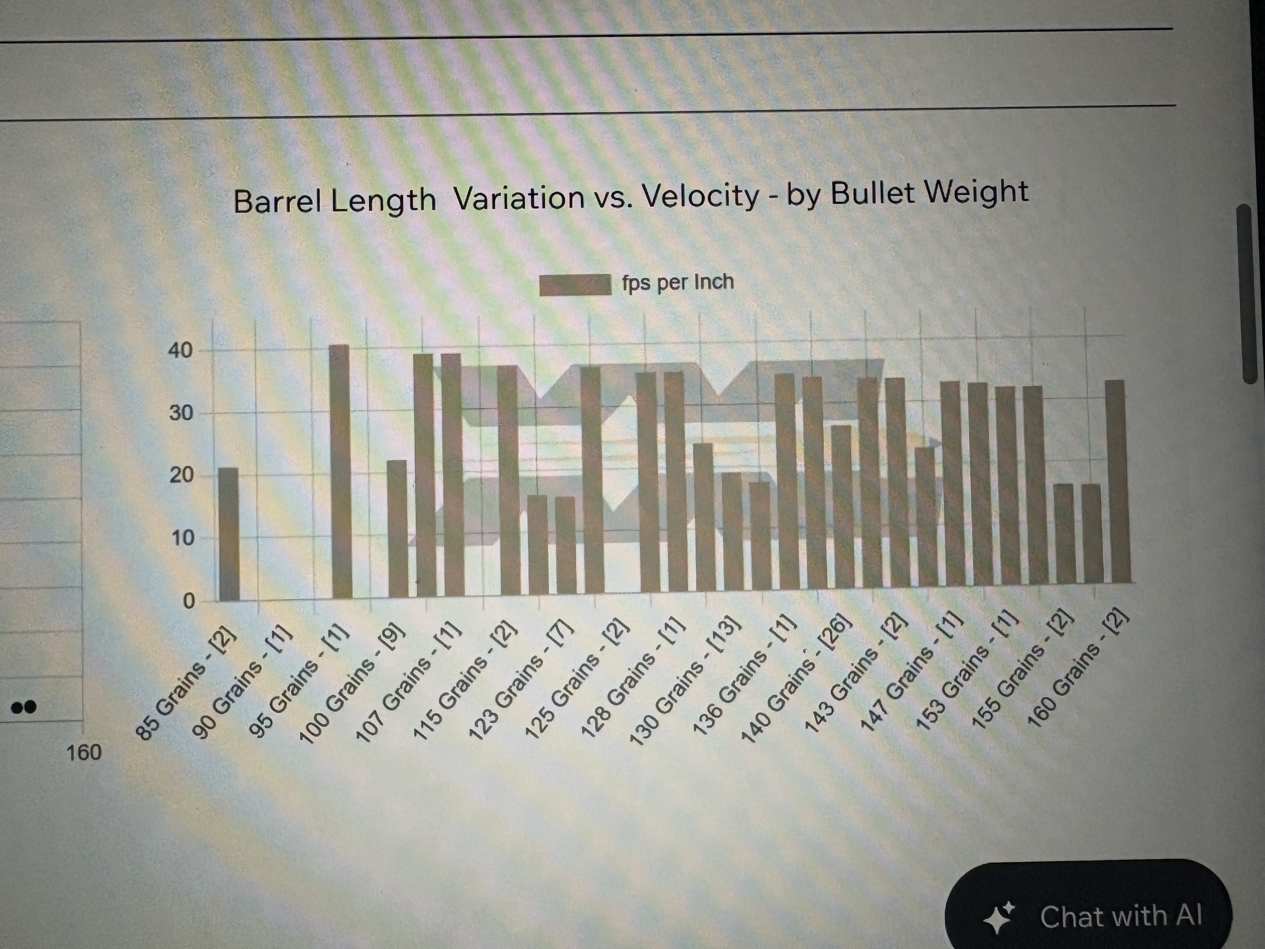

Tim at Crow Works says exiting powder particles hit the back of the bullet and can affect accuracy. He builds loads that burn 100% in the barrel and he uses GRT to figure that out. I also have XXL reloading and can set load parameters for length of barrel, fill ratio and powder burn percentage. and get velocity for this.
Screen shot for 6.5 prc velocity variation chart from xxl reloading.

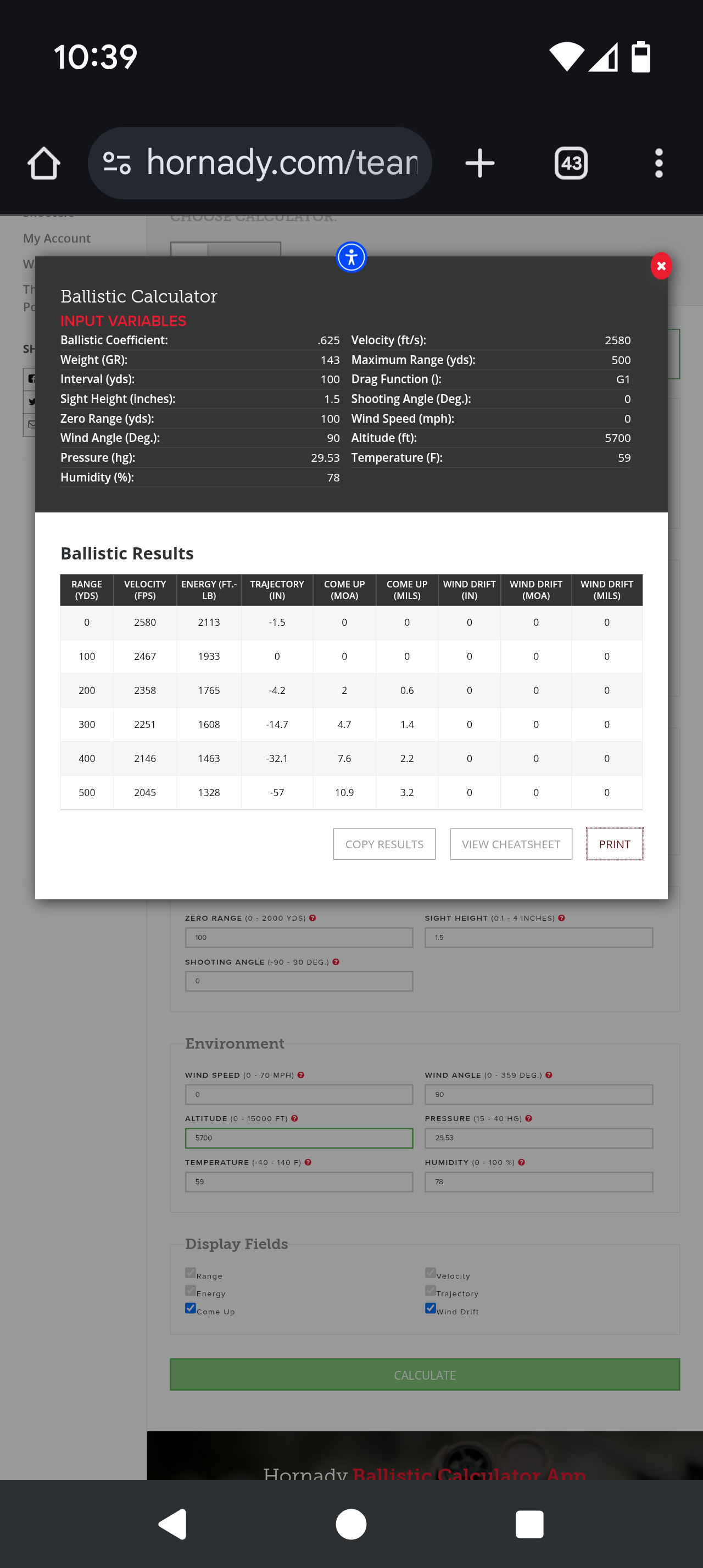

So the Hornady 143-grain eld-x Round. Had this for 20" Barrel

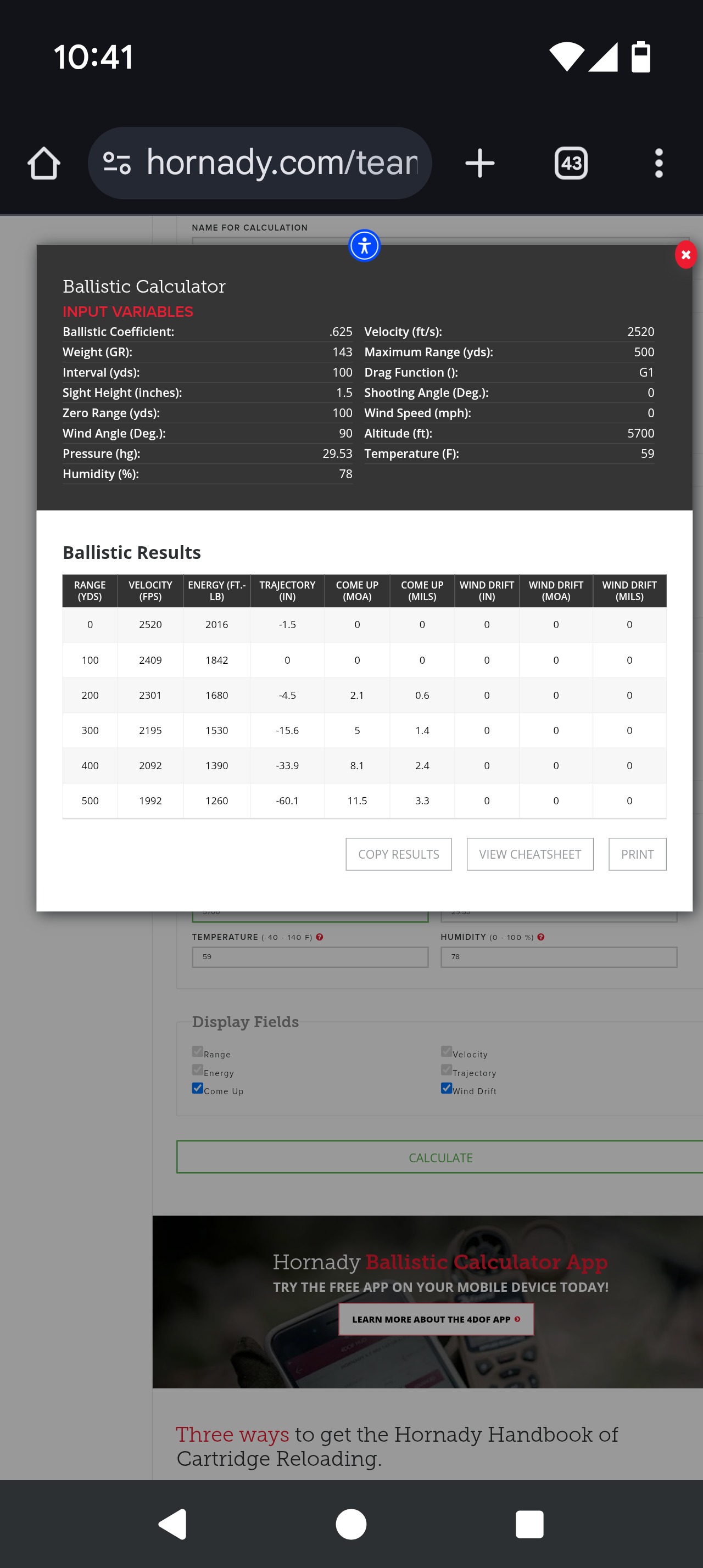

18" Barrel
So if I am understanding correctly. If I used this round and had an 18" 6.5 CreedMoor Barrel with a surpressor. I could get about ~2000 FPS at 500 yds?
